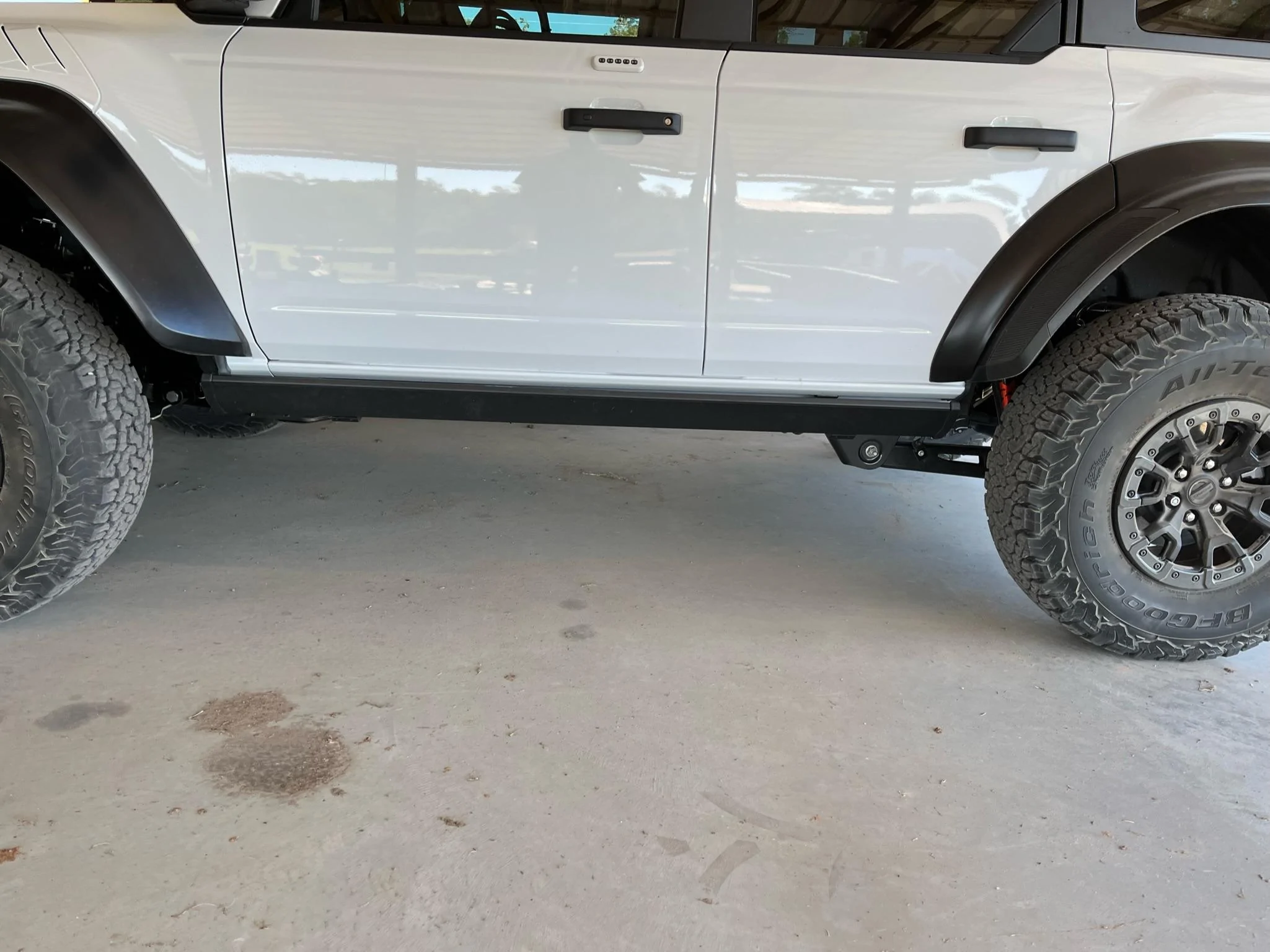

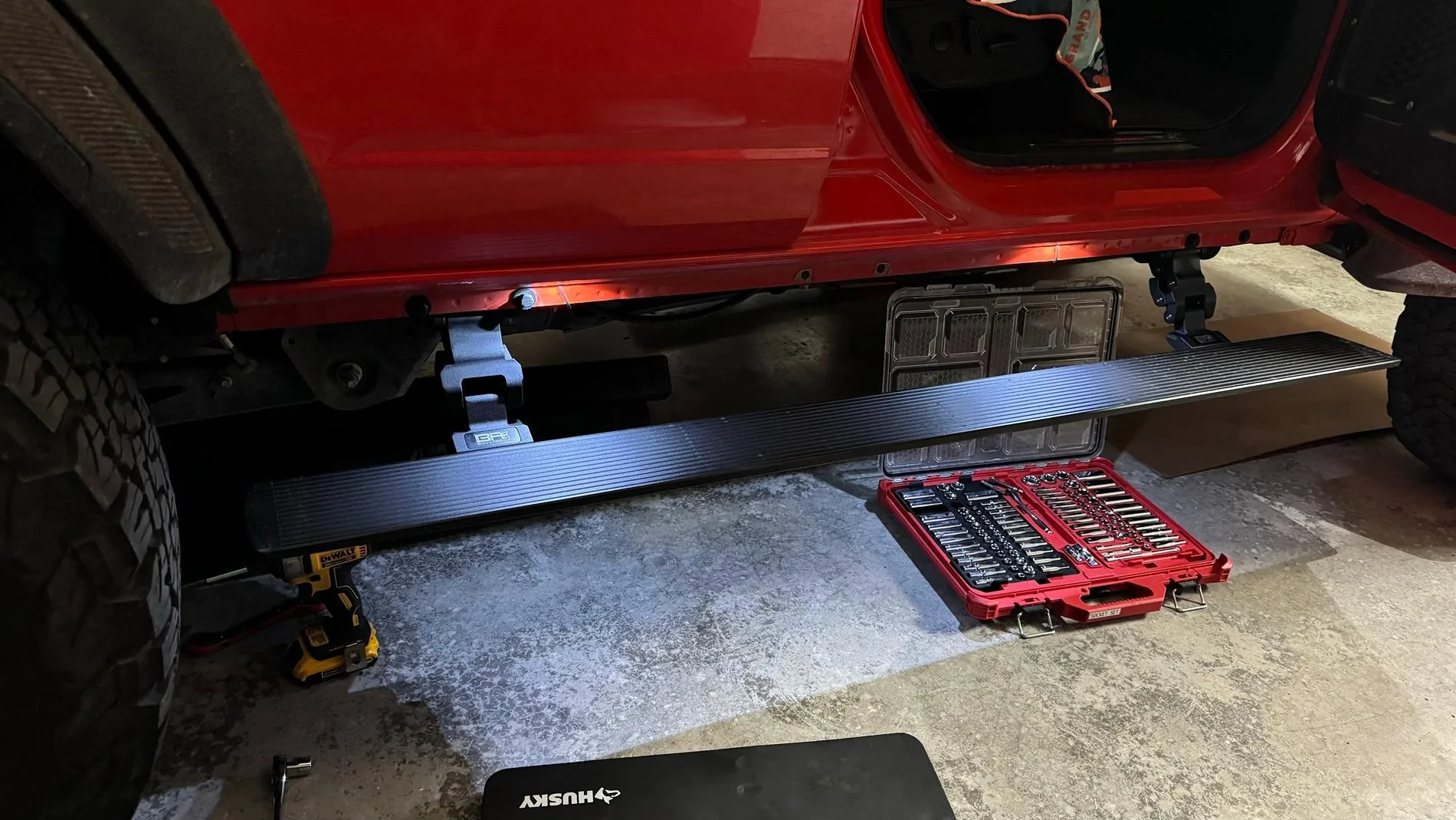

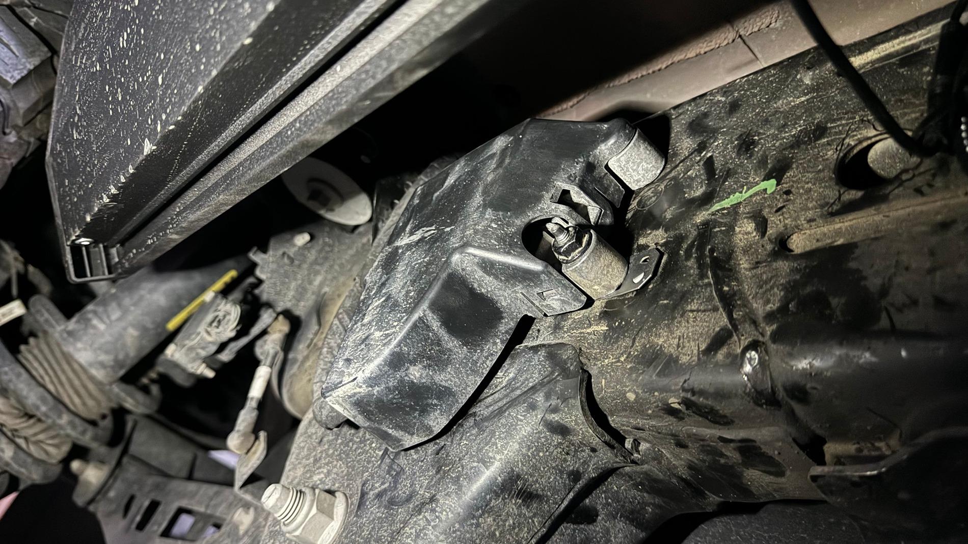

I installed the BodyArmor4x4 branded version of power steps, also sold by Go Rhino, Rough Country, and Westin. BA4x4 support was very helpful, though their responses were somewhat delayed. However, they didn't or couldn't tell me what I facebook friend was able to get the rear-right step motor assembly installed.

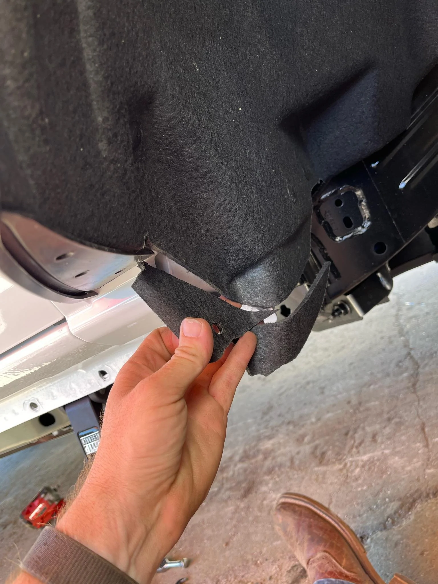

You pretty much follow the directions up until you install the rear step motor assemblies. However, if you want to leave your front mudflaps on, you will need to do the following to each board: take an end-cap off, trim off at least 3-inches from the board, then reinstall the end cap. For good measure, I attached one rivet on the skinny side (non-visible side) so the end cap would stay on.

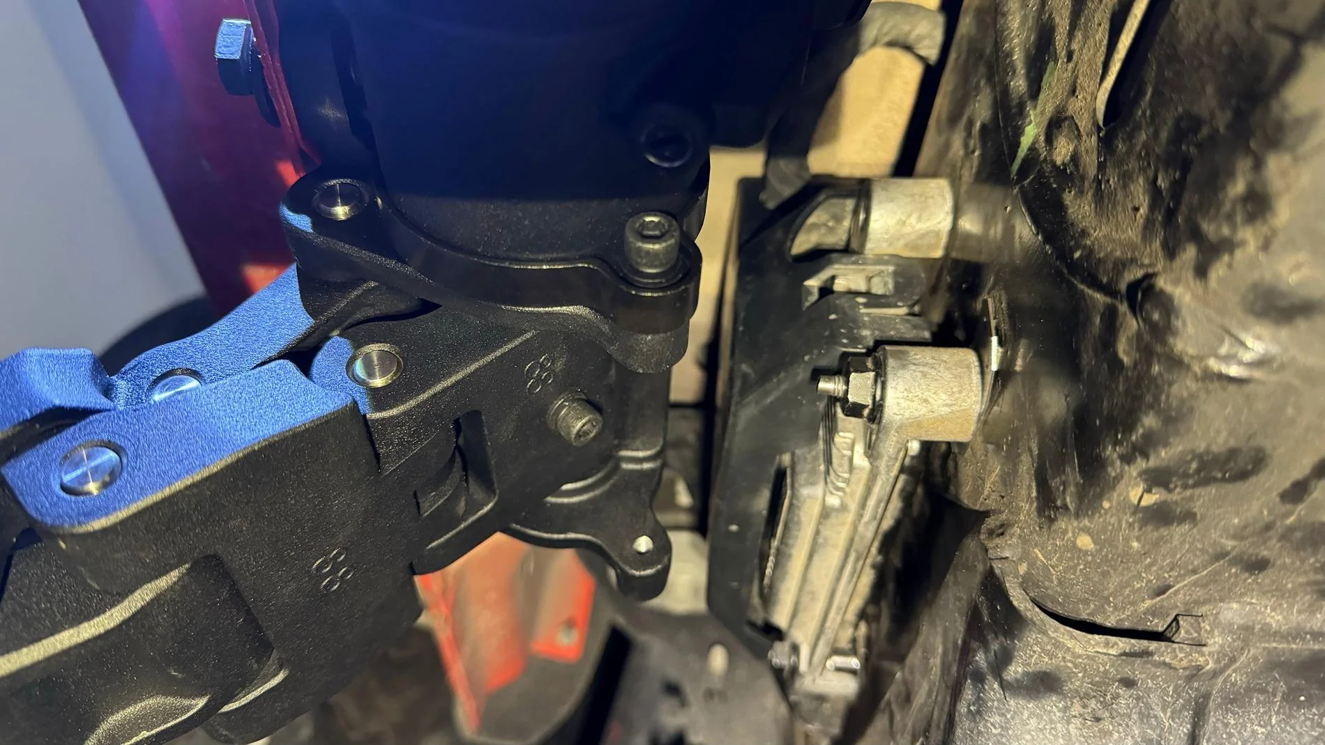

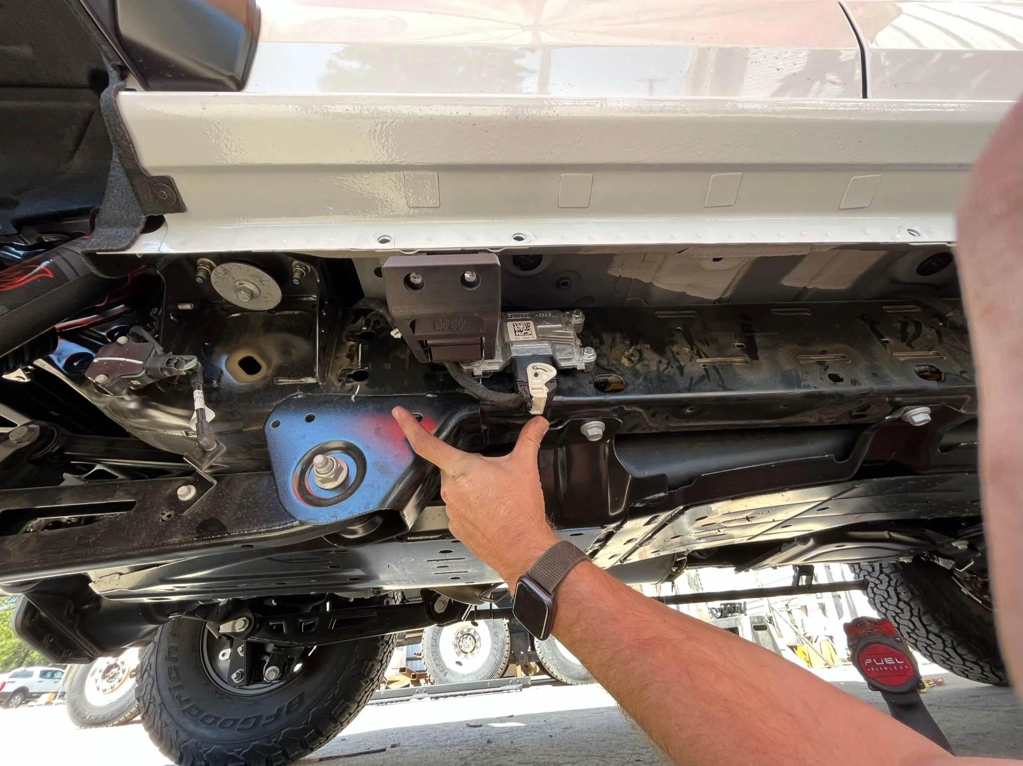

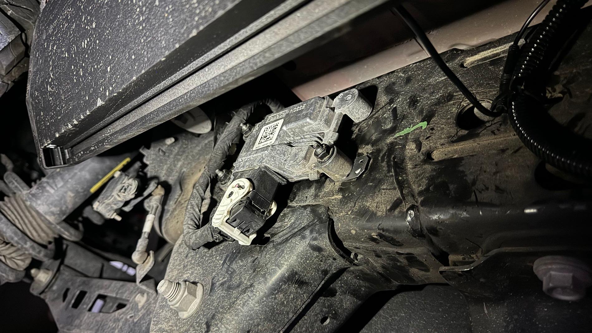

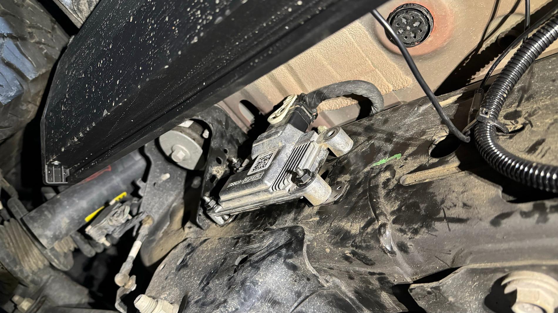

Step 1. Remove the suspension control module mounted on the rear-rear of the frame. Turn it 180-degrees, so it is essentially upside down. You will need to trim the cover; remove the section with the plastic peg.

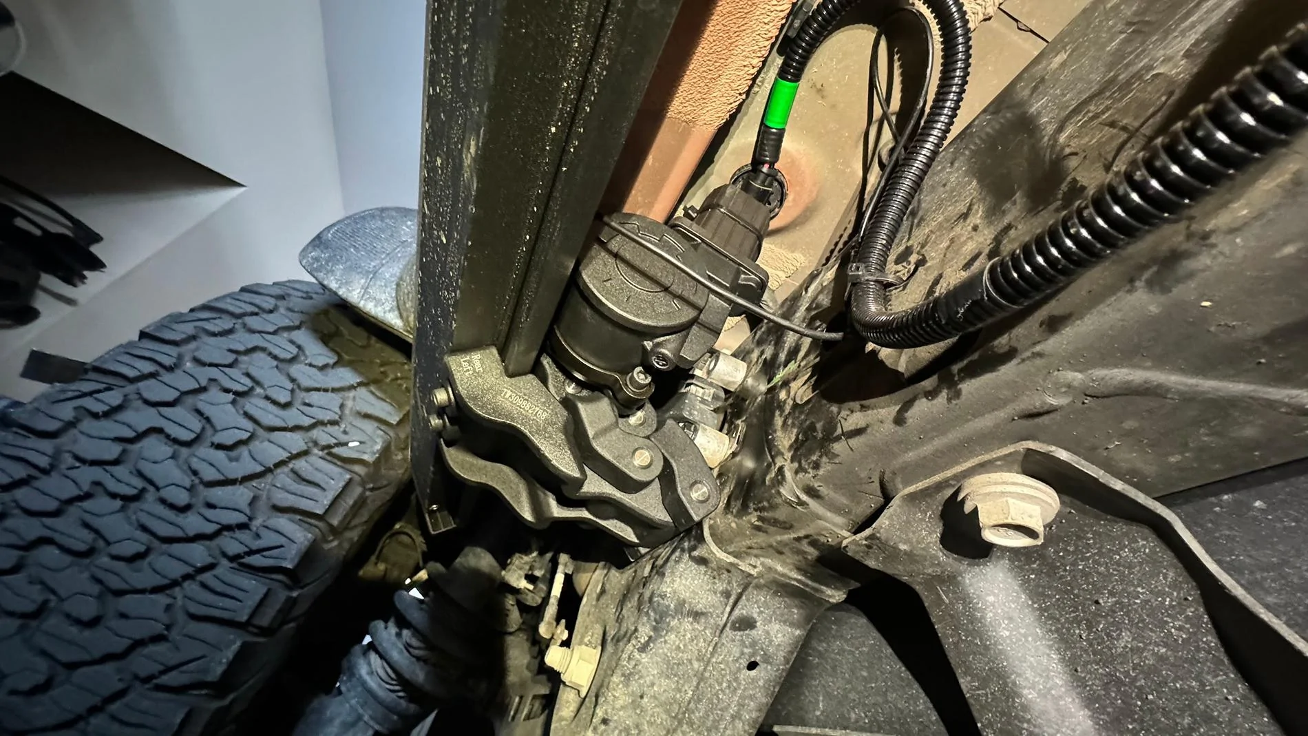

Step 2. Swap the rear power step assemblies, left goes on the right and right goes on the left.
I understand the engineering aspects of why the motors should be installed the way the directions state, thus protecting each arm's motor by placing it toward the rear of the vehicle saving it from potential debris hitting them. However, this doesn't work due to the frame mounted suspension module. I also realize there is potential risk of water/moisture ingress by re-installing the computer module upside down, though it is an easy and necessary modification in order to mount the arm in its intended location. I will likely add some silicon to the area where the wiring harness goes into the back of the module's connector, just as a preventative measure.

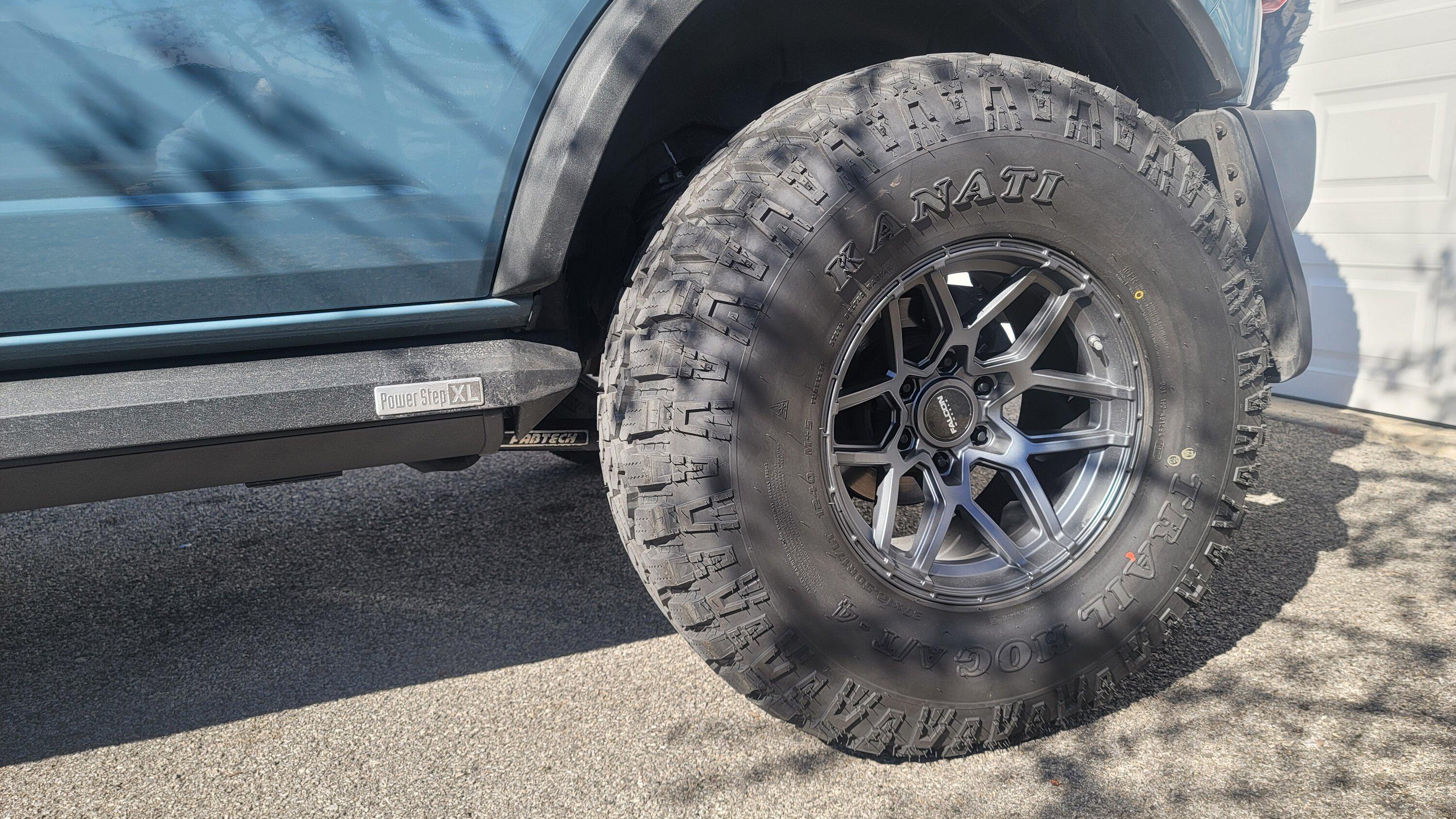

Yes I installed, took me about 5 hours but was fairly easy, I didn’t have to trim anything

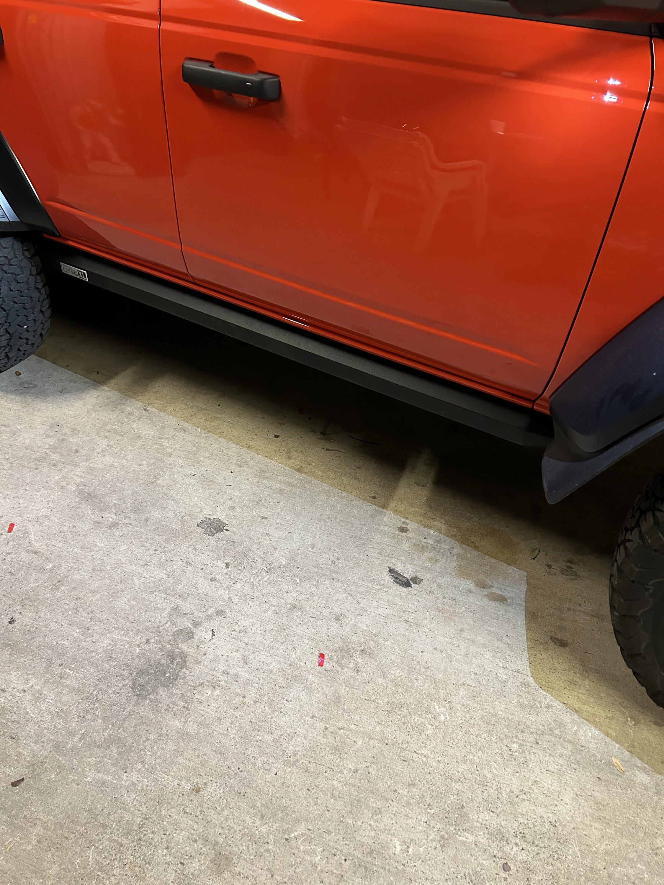

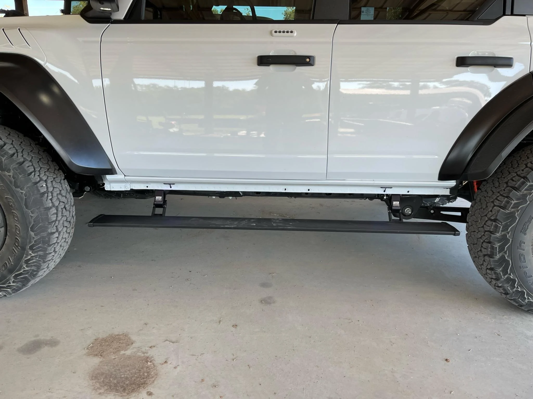

Do you have the exact part AMP number that you used? These come with a cover which hides the exposed pinch weld. I want to install them on a Braptor and saw another thread with XL’s but those dont seem to have the slide rails looking cover. Thanks!

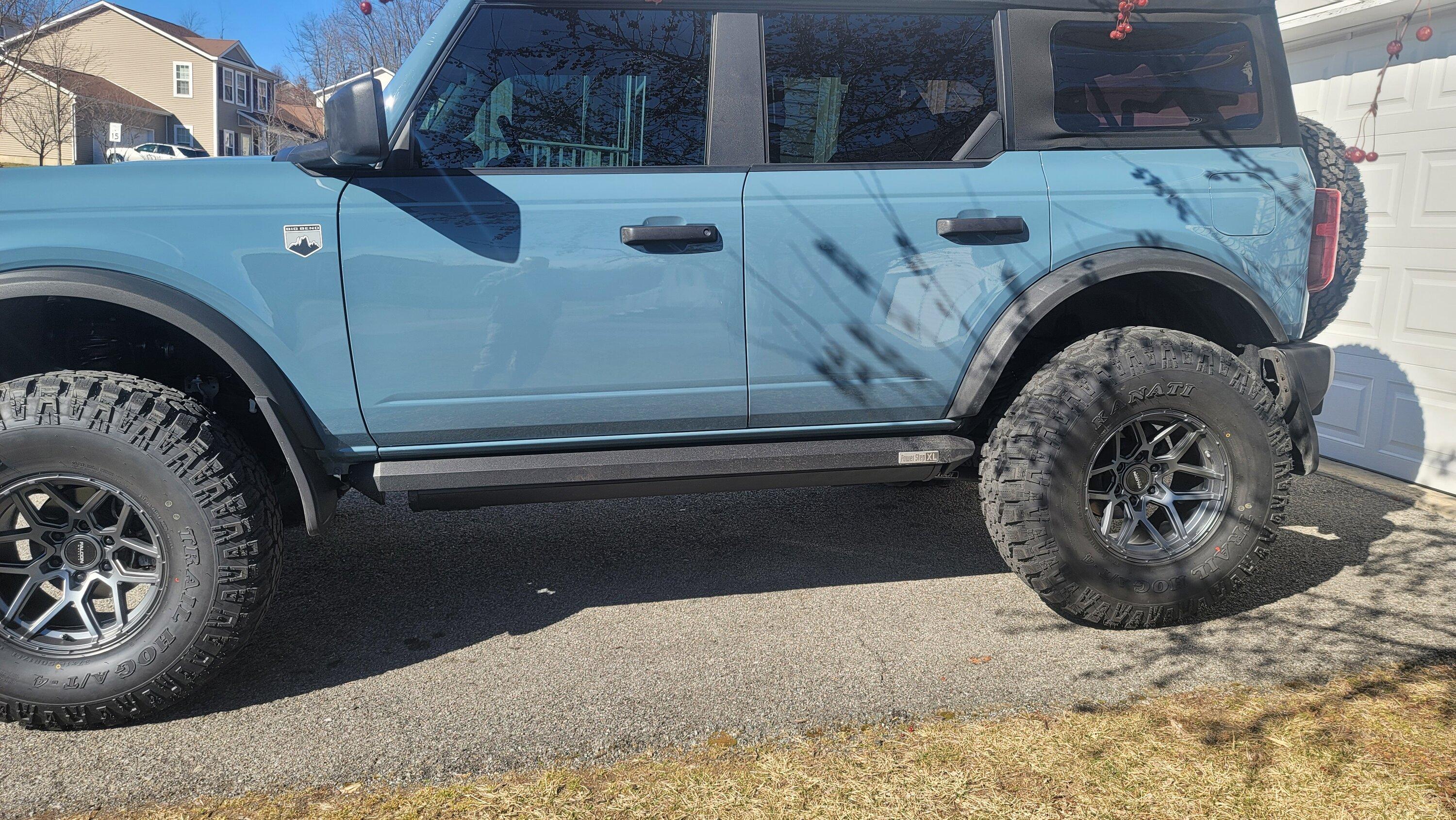

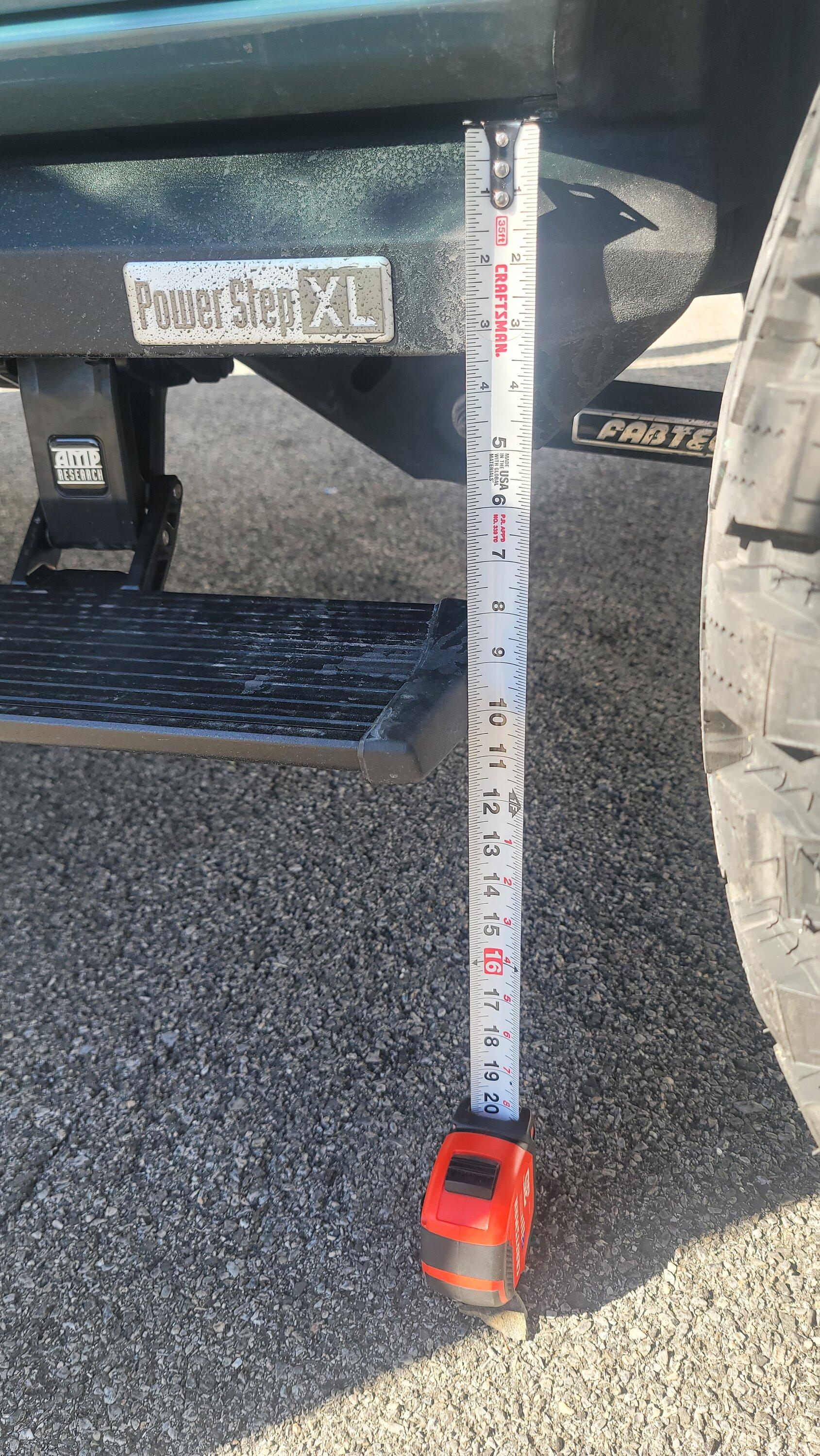

Also, this is the measurement of the step extended from the body.
