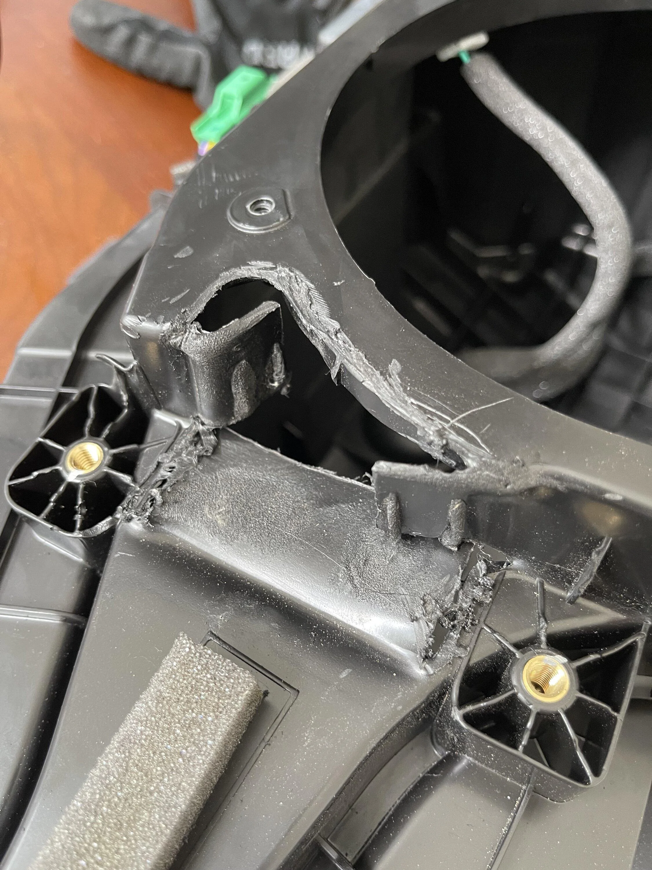

OK so thanks to this awesome community, a 2 door Bronco owner near to me offered their car for development.
After 2 full days of investigation what I found was a little disappointing:
Due to the cupholder in the rear quarter panel, it is not possible to mount our amplifier on the factory subwoofer box without some modification to the box.
The amplifier cannot protrude much further than the factory amp, so our amp must mount on the same holes as the factory amplifier which means that this piece of plastic needs to be removed all together and then the hole filled, I used multiple layers of JB weld to reshape the hole.
So my message to Bronco 2 door owners is:
If you are planning on using the factory subwoofer enclosure then proceed at your own peril, you will need a Dremel, heat gun and some patience to make our amp fit in the stock location.
Below is a photo of just before I flooded the area with JB weld to reform the edge.
Ford Bronco Bronco Plug and play 1150W RMS amp replacement kit for B&O back in stock! Photo Sep 13 2023, 11 38 45 AM
Otherwise, if you are going to use a different subwoofer solution then play on, the kit will be easy to install.
Just make sure you are aware of what you're getting into before purchasing if you have a 2 door Bronco.

Biggest issue, the mounting plate was 4 door specific, for the less than 15% of us with a 2 door and less than that for 2 door Broncos with Lux package, it's not surprising that this may have been missed. They have a solution for 2 door Broncos, my solution was to slot the mounting holes and move the amp slightly rearward. 15 minutes to mod the plate. Scale of 1-10, 1 being the most minor inconvenience and 10 being the worst, I would call this a 2 (at worst).
Did you happen to take any pics of the plate when you modified it? How far back did you slot to accommodate it fitting?
mpeugeot
May 14, 2021
7,622
14,359
I still couldn't move it quite enough to clear. When I had posted that I had moved it far enough from the information I was told, but it turned out to not be enough.
