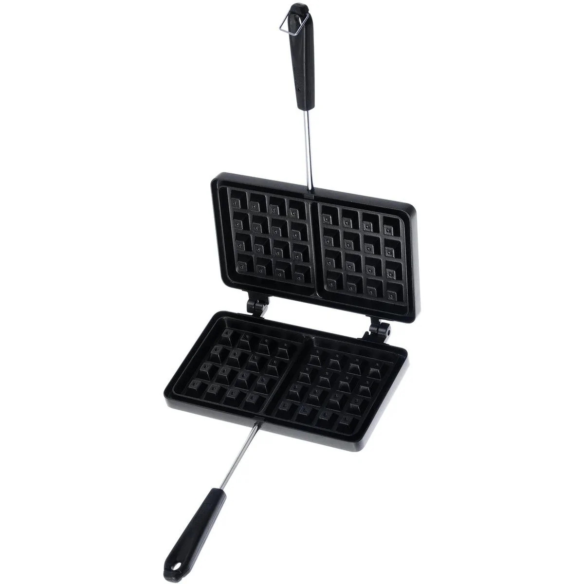

It’s a shame, really. So much usefulness in being able to use something with a heating element in the great outdoors. Sure, my Coleman 2 burner camp stove is awesome, but imagine being able to add a small coffeemaker or waffle maker for a premium breakfast in the woods!
pan-y-cerveza
May 29, 2020
2,790
10,607
Manitoba
Tacoma Pro

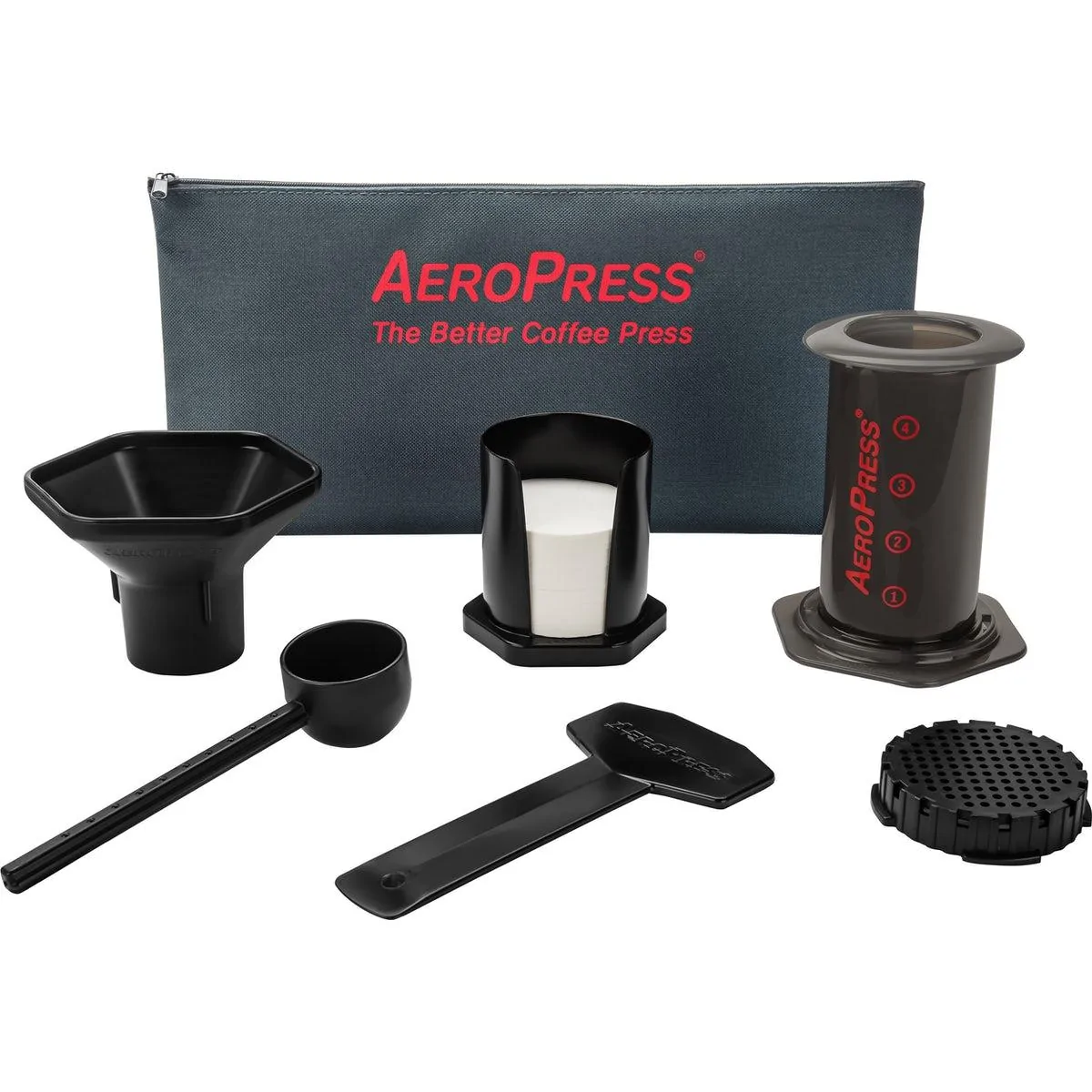

Back to the basics. These won't drain your battery in no time either.
The Aeropress will make better coffee than you'll ever get out of a machine anyway.

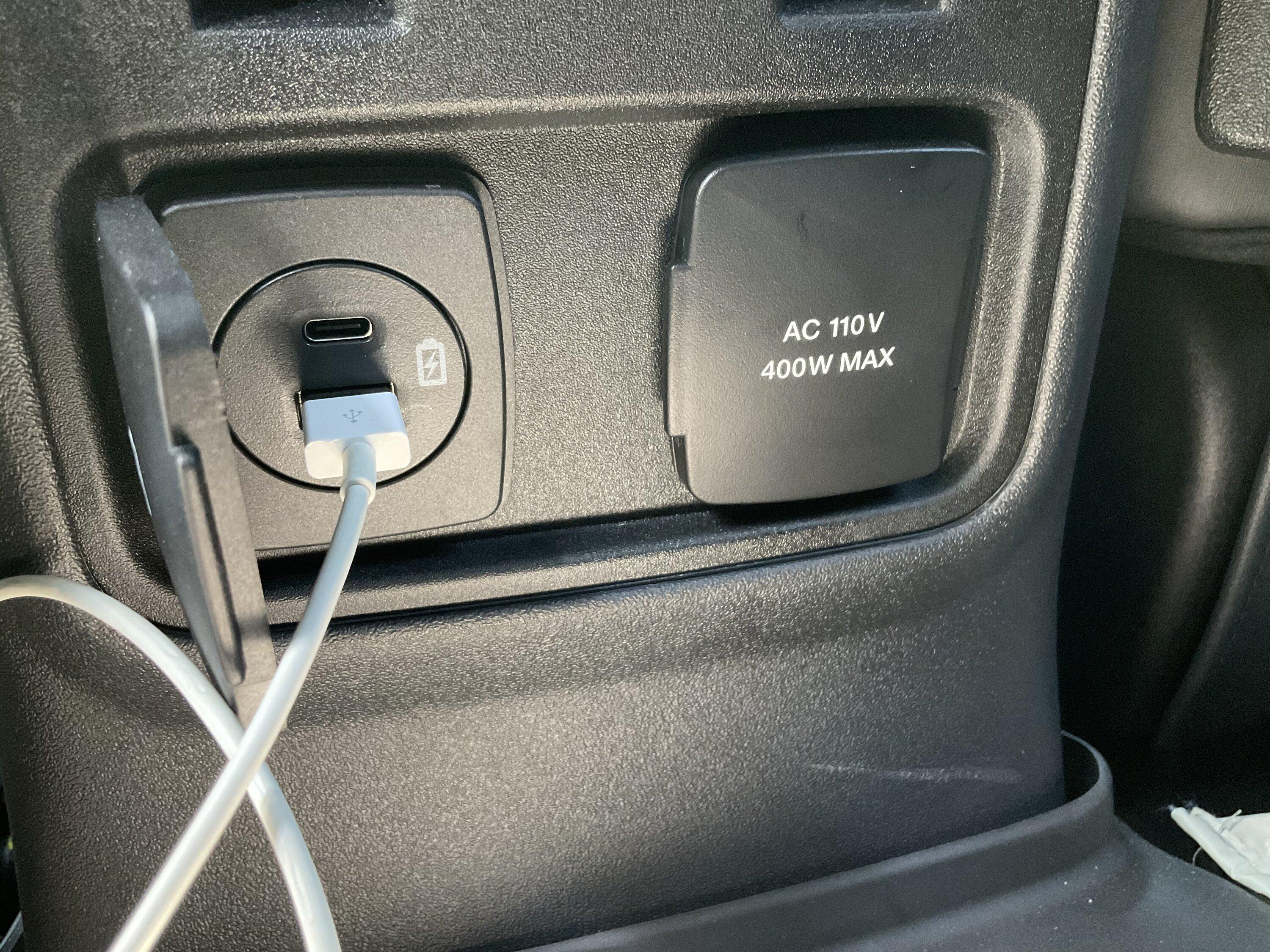

Is it possible to increase the wattage on the power outlet ?
Roger123
Roger
1,819
4,297
VA Beach, VA
Not sure that could be done, what power are you looking for? It's 400W (in park) 300w (in drive).

The photo of the AC outlet got me wondering since I have been charging my Bluetti power bank which can charge at up to 200 watts.
Just looked at my AC outlet and it is 400 watts. Lux package.
