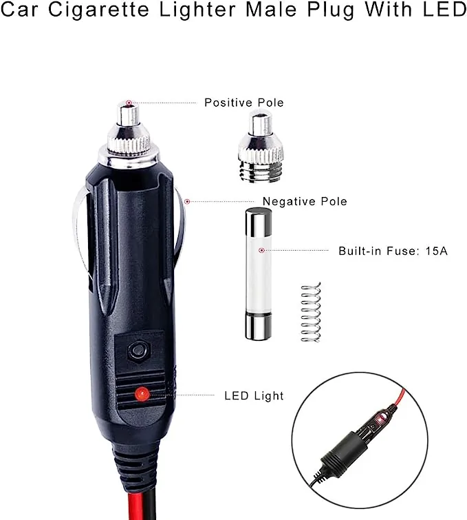

I also had the power port in my 2002 Ranger have a melt down when it was powering my refrigerator. I replaced it with a universal unit that looked to be better quality than the OEM unit. I had to replace the ARB power port plug too because it distorted from the heat. I never had any problems after the repair. I had enough confidence in it that I plugged a three way splitter into it and powered my refrigerator, CB and a lower power inverter that I could charge my phone and camera batteries.
