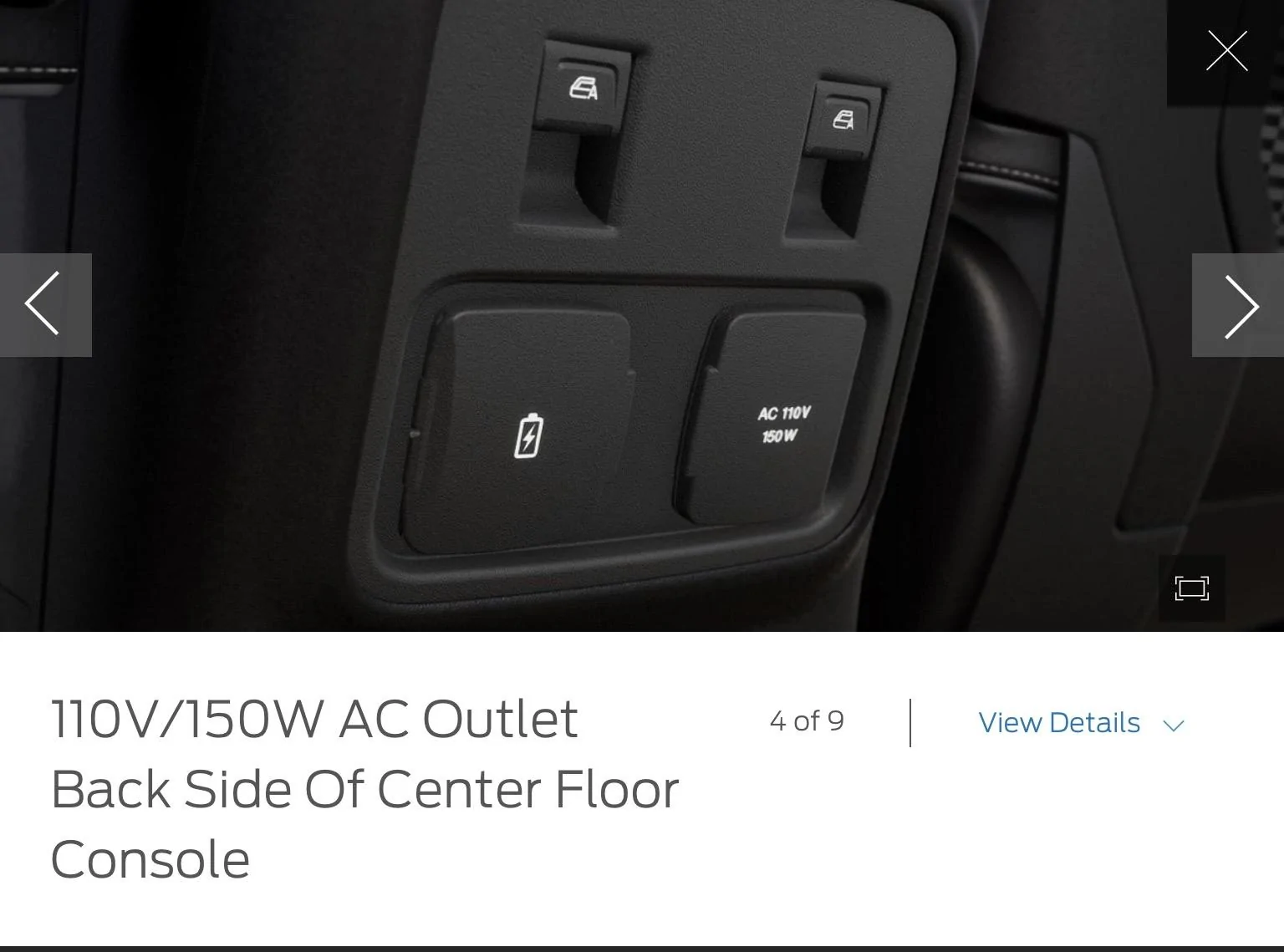

oof. thanks.
not good and glad I found out before plugging in any sensitive equipment.
What sensitive equipment are you trying to use?
I had my lap top plugged in and charging while programming forscan and had no issues.
Does the computer charger change the wave, maybe?

Right, now that I know this, replacing the inverter is another task to add to the list. Assuming it's in the read console near the receptacle, hopefully there is enough space to simply swap it out for a higher quality (also more expensive) unit.
If you're open to it, I'd love to see what your research net here if you could post it up when you're ready.
Honestly, I'm not even going for a replacement. I'm simply looking at Converters I can wire directly to the relay/battery and install in the cargo area. I'm primarily using it to charge a power station that is capped at 15A.

If using a voltage adapter for a short period you may be okay, but electronics are especially susceptible to this so I'd be cautious. Some portable fridges, motors and especially equipment with potentiometers are also susceptible to improper function and damage to both the equipment and DC converter. I discovered this sine wave issue a few years ago when I bought a DeWalt product that converted DC battery packs to AC 120V current to power corded equipment. After the second equipment failure I investigated and discovered this issue with pure vs stepped sine waves. It's worth looking into and there is research all over the internet on this. It's not some niche issue.
