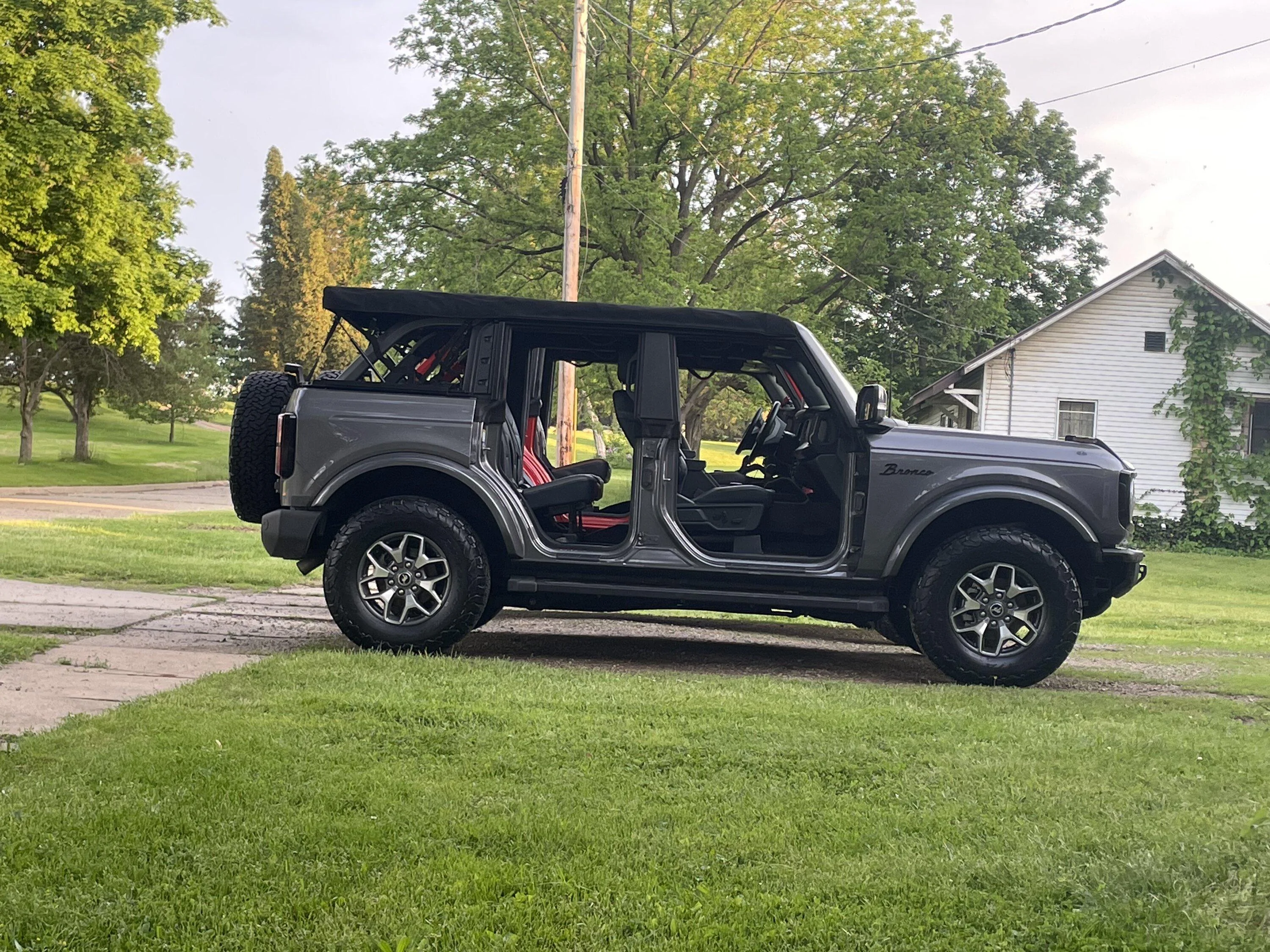

You can grab a set of badlands takeoffs with 285/75 17 for $1500 or less it’s hard to even buy the tires for that. I got my set for $1200 for 5 with sensors. No trip to a tire shop bolt on the go. They have no poke nice and even with the flares. A guy could powder coat them black I suppose. They do fill the wheel wells up tho. I do not have a straight on shot and now have a lift.

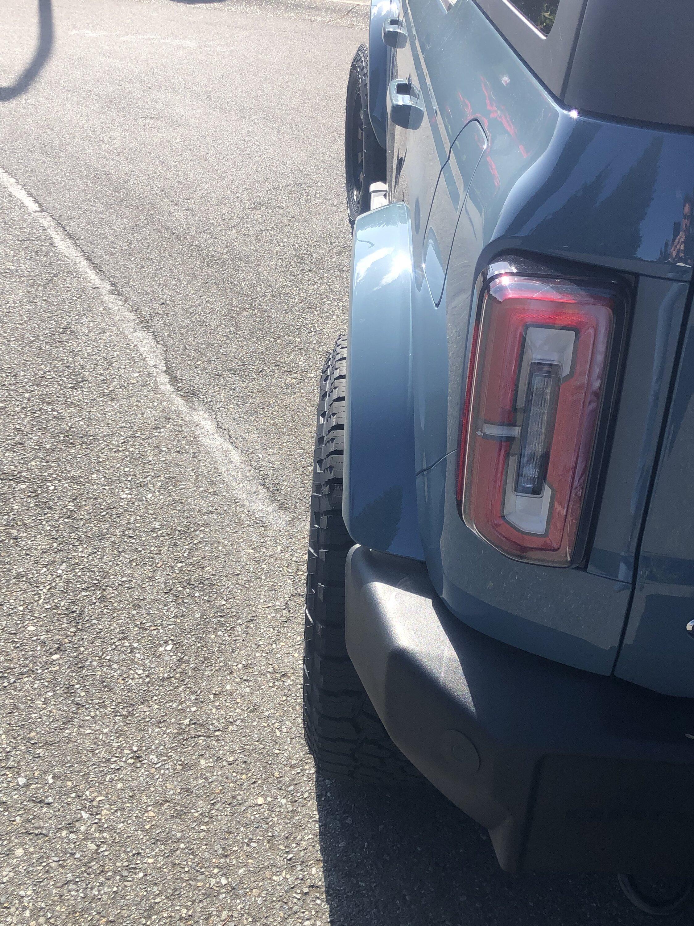

I think a lot of it has to do with the wheel width - +20 offset yielding different looks for s 9” wheel vs a 8.5” wheel. (I didn’t go and research the ones you’d called out up above).
For my OBX, I thought a little poke would be OK, so went with a Fuel 18” x 9” wide wheel with +20 offset. That limits the tires you can put on them due to the 9” width, so you’re talking about a 275 minimum tire (most likely). I put 285/65R18 Falkens on them and there is a fair amount of poke (2” maybe). It does look pretty aggressive, but was more than I expected. With a 275/70R18 it would probably be about an inch of poke.
And… to make it even more complicated…the brand of tire does seem to make a difference too. I’ve seen pictures on this forum of others with the same size tire (285/65R18) but different brands, and they look totally different (Generals being the smallest, BFGs being next larger, with the Falkens seeming massive).
