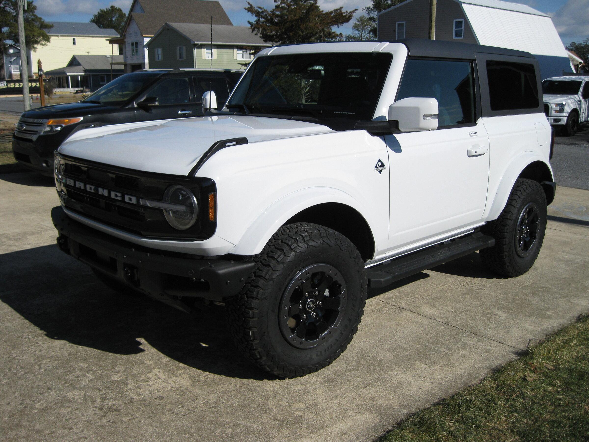

Stay between +55 and +30 and you should be fine.
Here's 285/70-17 on an 8" wide wheel +55 offset.

+55 offset will work. And if you are doing 285mm-wide tires I'd go with with 8" wide wheels... although 8.5" will probably also work. If you really want to do 9" wide wheels... then you're probably going to have to decrease your offset to +30... and my guess is you'll get a tiny little bit of poke with a +30 offset.
