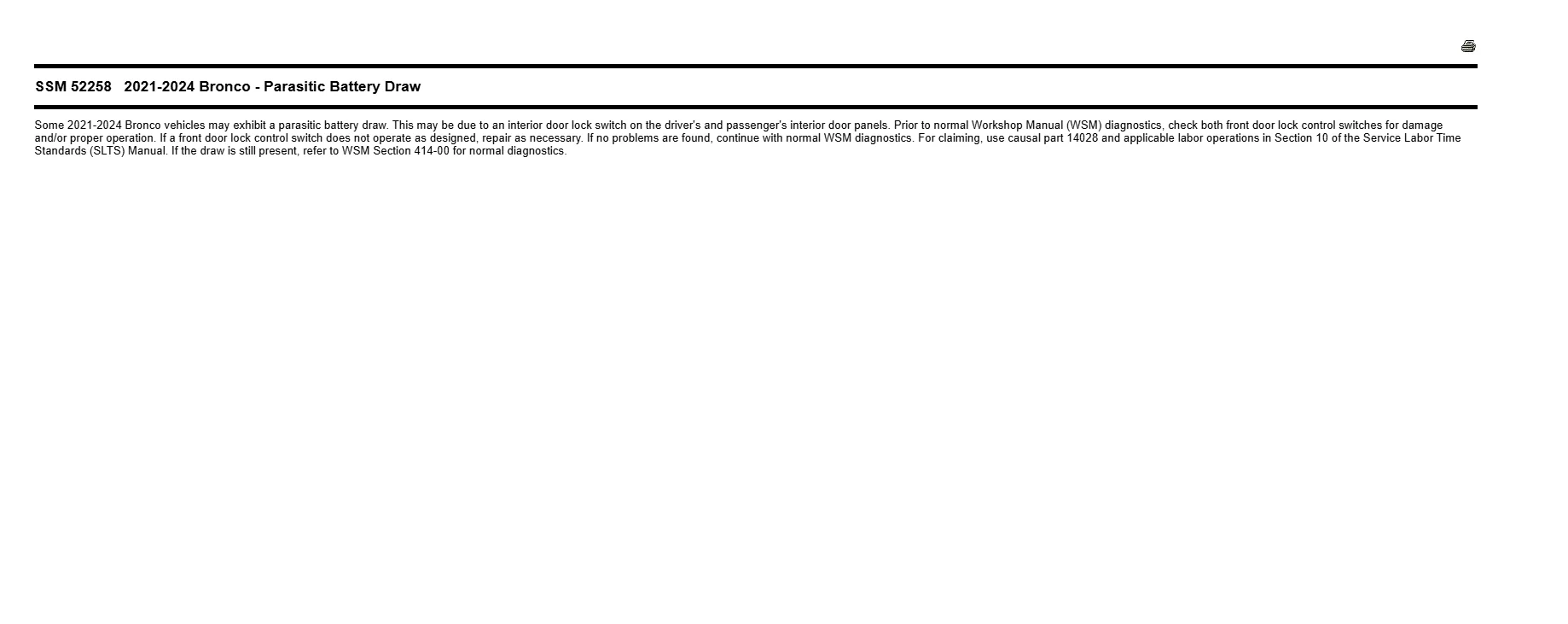

Did they check the interior door lock switches?? Common problem that causes a battery draw.

I just called and relayed everything y’all have mentioned to me to let him know and he said that that was the first thing they tried. He said they’re kind of just stuck at a crossroads right now.
