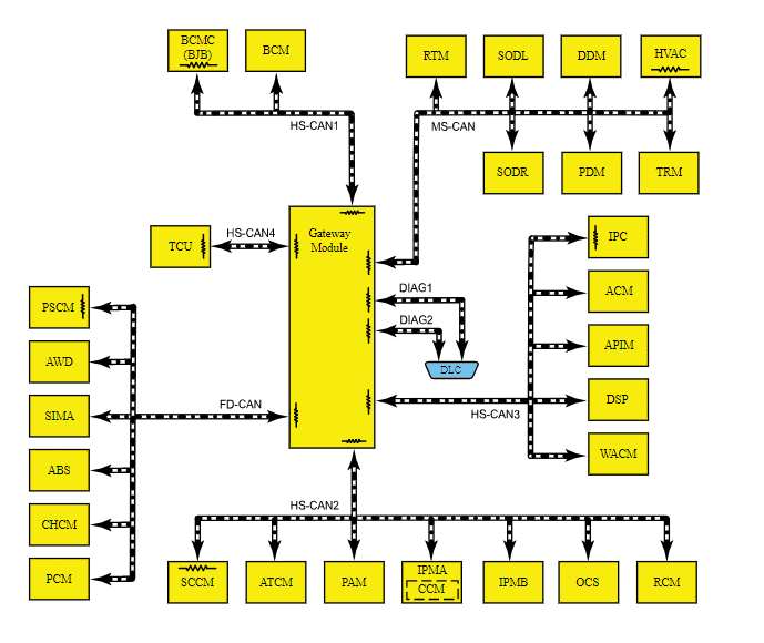

So an annoying but erroneous code pops up but is cleared, and then an airbag issue happens? I don’t see how the airbag and 2.7 engine are related 🤷🏼‍♂️
Everything is networked and has multiple modules exchanging info with each other. One module could have a parameter range setting that another is looking at and conflicts with what it thinks it should be. Networking issues are some of the most difficult electrical issues to diagnose because there is sooooo many related systems. You may get lucky and find a pin fit problem in a connector causing an intermittent concern or you could go through all of the pin point tests and find out Ford has a programming issue there is currently no fix for.
On it's face, the two post cat codes would indicate the converters are bad and not cleaning up the exhaust. First thing to do after checking codes would be to look at the connectors and terminals to make sure they are fully seated and there isn't damaged wiring. If all of that's good then the fun work starts.
