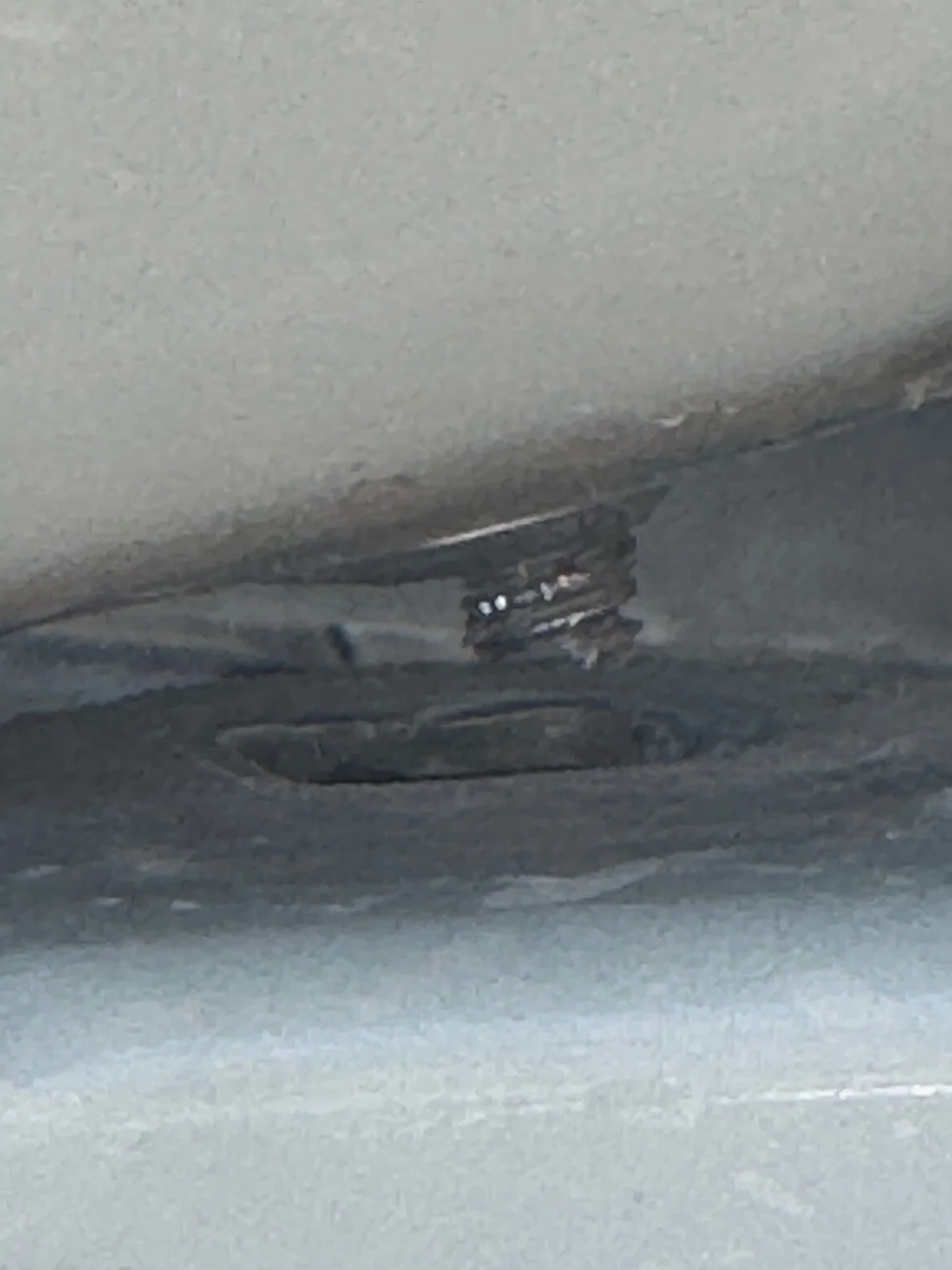

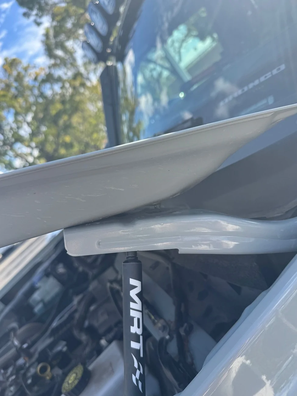

Does anyone have experience with a broken hood bolt?
I snapped a bolt in half when installing a hood strut. My hand slipped while tightening and the bolt snapped.
Dealer said to take it to a body shop but it seems like that bolt could be replaced. I wanted to check here before doing anymore damage.

Post a pic pls. The standard approach would be to drill a hole in the broken off bolt, then use an easy out to back the bolt out.

Here’s a couple of pictures of what I’m dealing with.
Ford Bronco Broken Hood Bolt IMG_7927
Ford Bronco Broken Hood Bolt IMG_7928

Looks like you need to remove the hood and back that bolt out with some vice grips.
