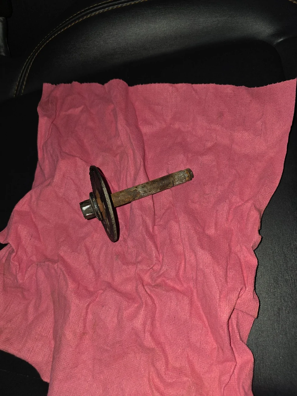

It's definitely a part with many synonyms:
Ford Bronco Broken Body Mount Bolt - RSE Power Steps Question 49446
My installer did follow the RSE guide in addition to heating the bolt to prevent stripping. I think unfortunately there was so much rust and corrosion on the bolt (originally a NY dwelling vehicle before my ownership), as well as it potentially being cross-threaded by Ford during assembly. See fruits of labor:
Ford Bronco Broken Body Mount Bolt - RSE Power Steps Question 49448

That broken bolt appears dry.
Or maybe I'm just a slob when applying penetrating oil
