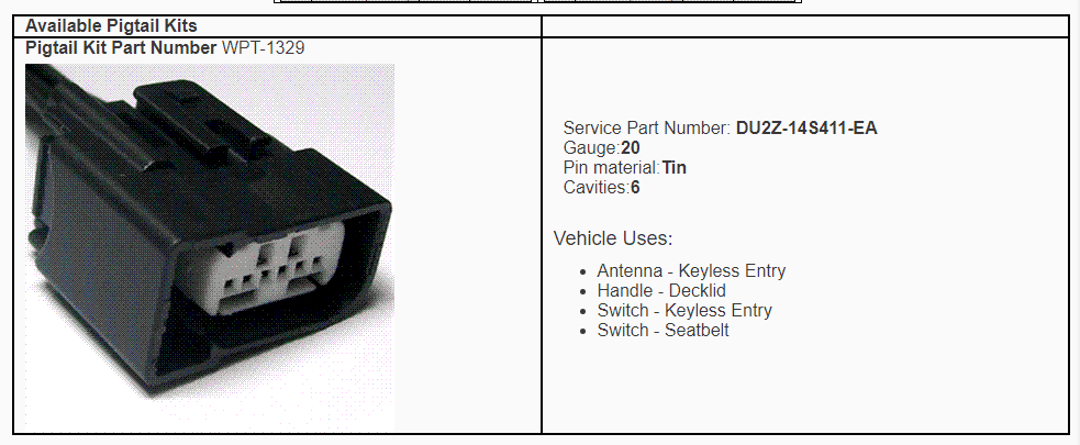

That's the female side - is the male side available as well?

Great find Flip! What site is this? I don't see a shop on the WDP website...
Sorry, this is a Ford part. You can give your parts department either the WPT number or the service part number.

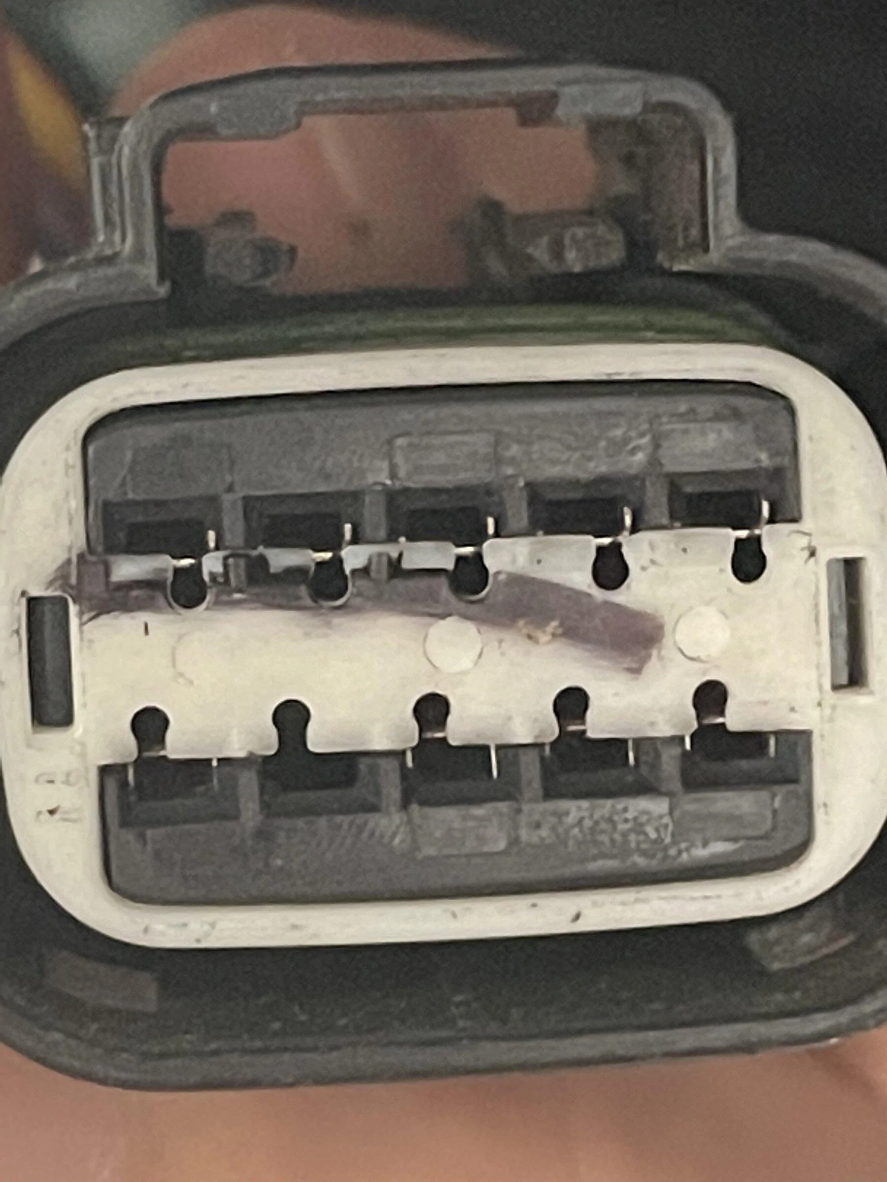

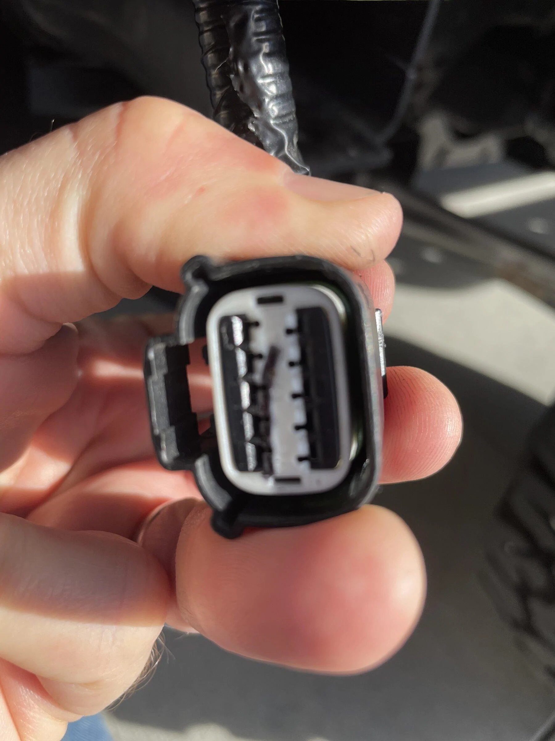

Well…. I was tired of getting the fault every time I backed out so I did a bit of trimming on the female end and removed the orange rubber o-ring (grommet?). Now I get a good connection and no fault light. It looked like the grommet was loose and binding up causing the male end to not seat all the way. I probably could have got a pick and removed it without trimming the plastic, but hey it works. Taped it up good with electrical tape until I have time to replace the connector…

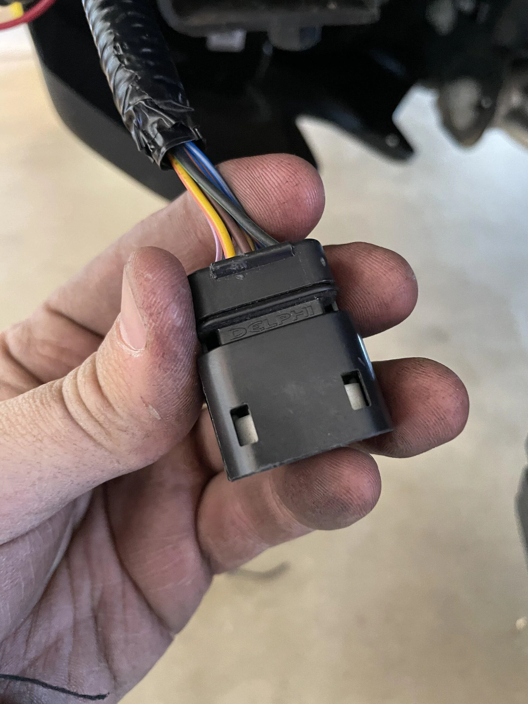

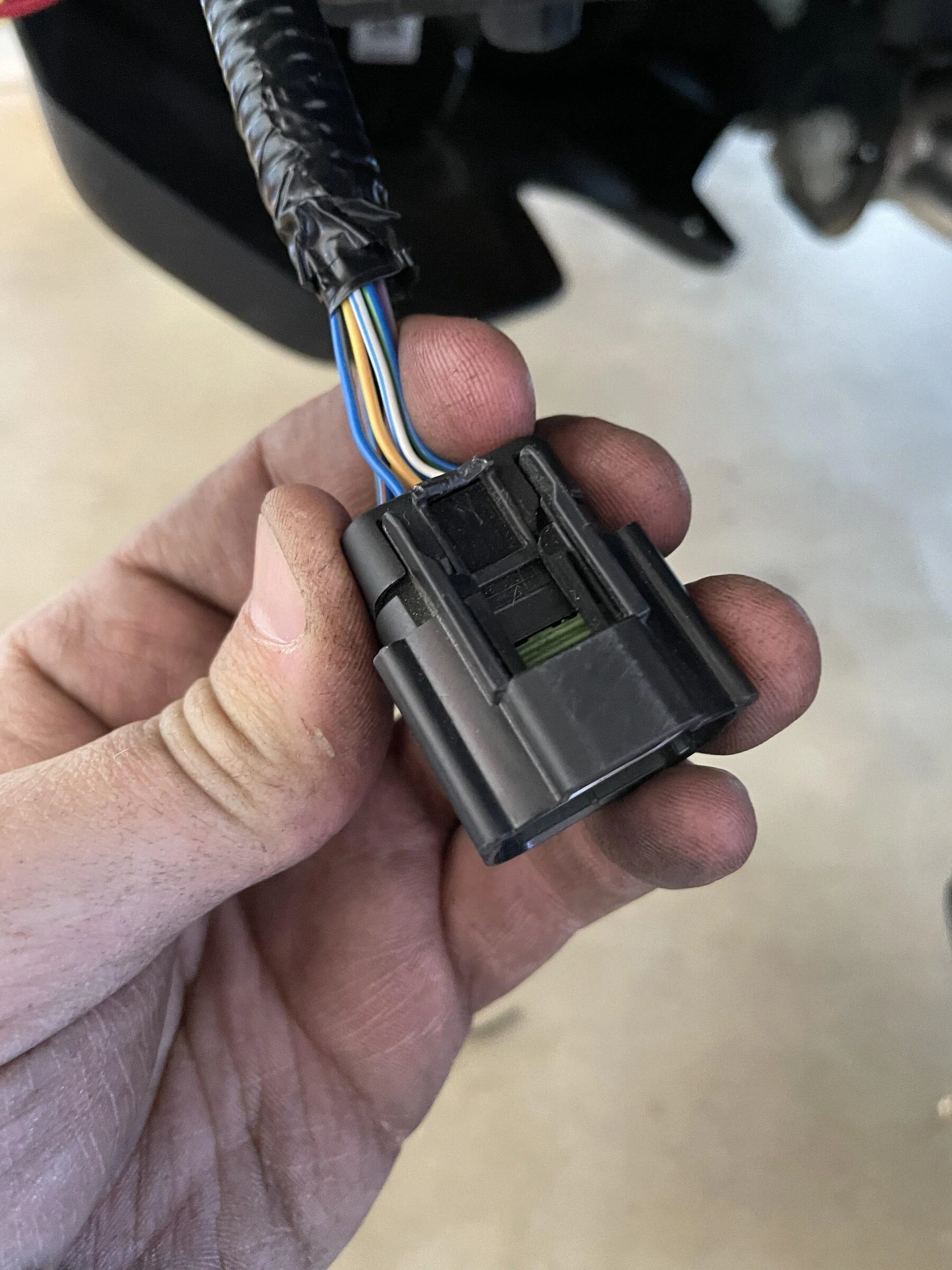

Can’t make out any PNs,
Delphi connector if it helps.
