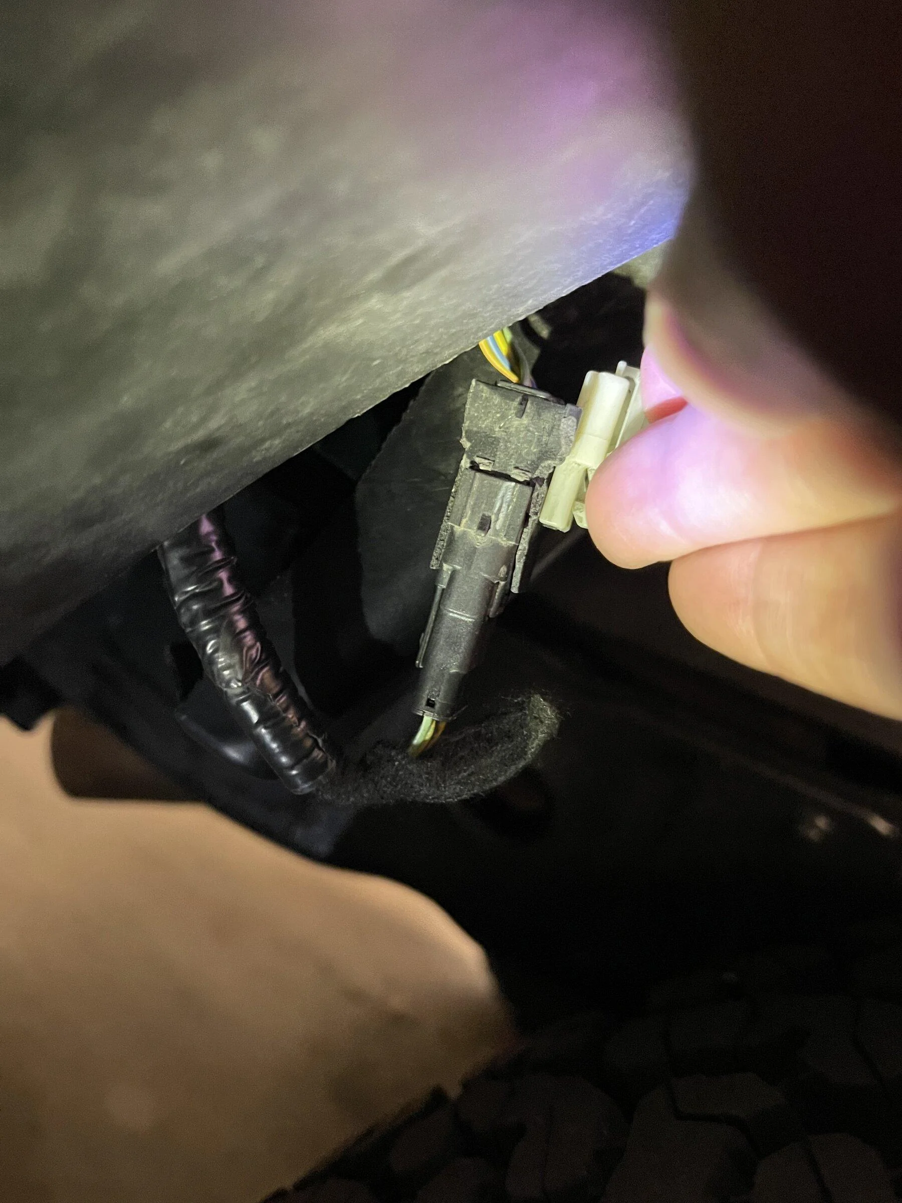

Well…. I was tired of getting the fault every time I backed out so I did a bit of trimming on the female end and removed the orange rubber o-ring (grommet?). Now I get a good connection and no fault light. It looked like the grommet was loose and binding up causing the male end to not seat all the way. I probably could have got a pick and removed it without trimming the plastic, but hey it works. Taped it up good with electrical tape until I have time to replace the connector…
i think this is the exact reason mine is not seating.

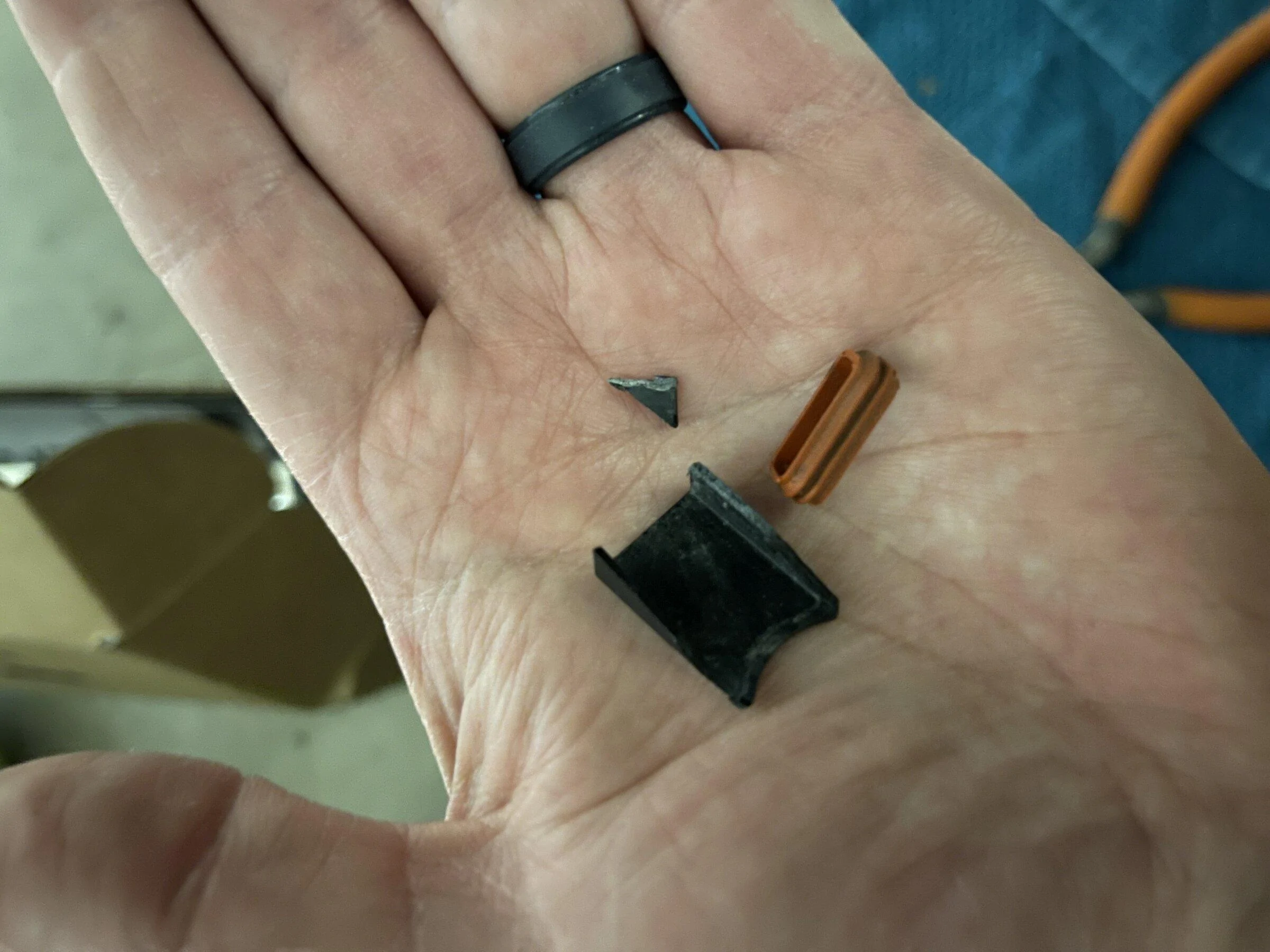

I just had this issue when installing an aftermarket hitch receiver. Ended up breaking the clip and then removing the O-ring (that's what was blocking the clip from properly connecting). Taped it together and no parking sensor error. Temporary fix until I get it addressed at the dealership.

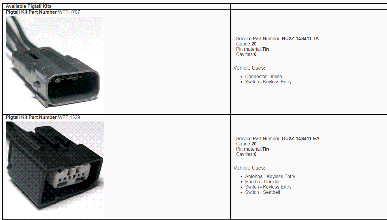

Took the Bronco in to have the tow hitch wiring installed. I asked about the connector to see if they would cover it under warranty, and if not, what would be my cost to fix the connector. I also asked if the connector was maybe part of a sub-harness that might be easily replaceable, rather than splicing in 6 wires.
I was told that the the connector was not under warranty because it broke during a "bumper replacement". The cost to repair the connector? $1100. $280 for the part, DU2Z-14S411-EA, and $800 or so for the labor.
The part is easily available online for under $50. It is just a Ford repair kit that has the connector as a pigtail with butt connectors and shrink tubing. The connector is in an awkward place when the Bronco on the ground, so I estimate that it would take an hour of being pissed off, cutting and spicing while you are hunched over or laying on your back. If I had a lift and could bring the connector up to a reasonable working height, then it is literally 30 minutes tops. Cut, splice, heat, repeat 5 more times. $1100.

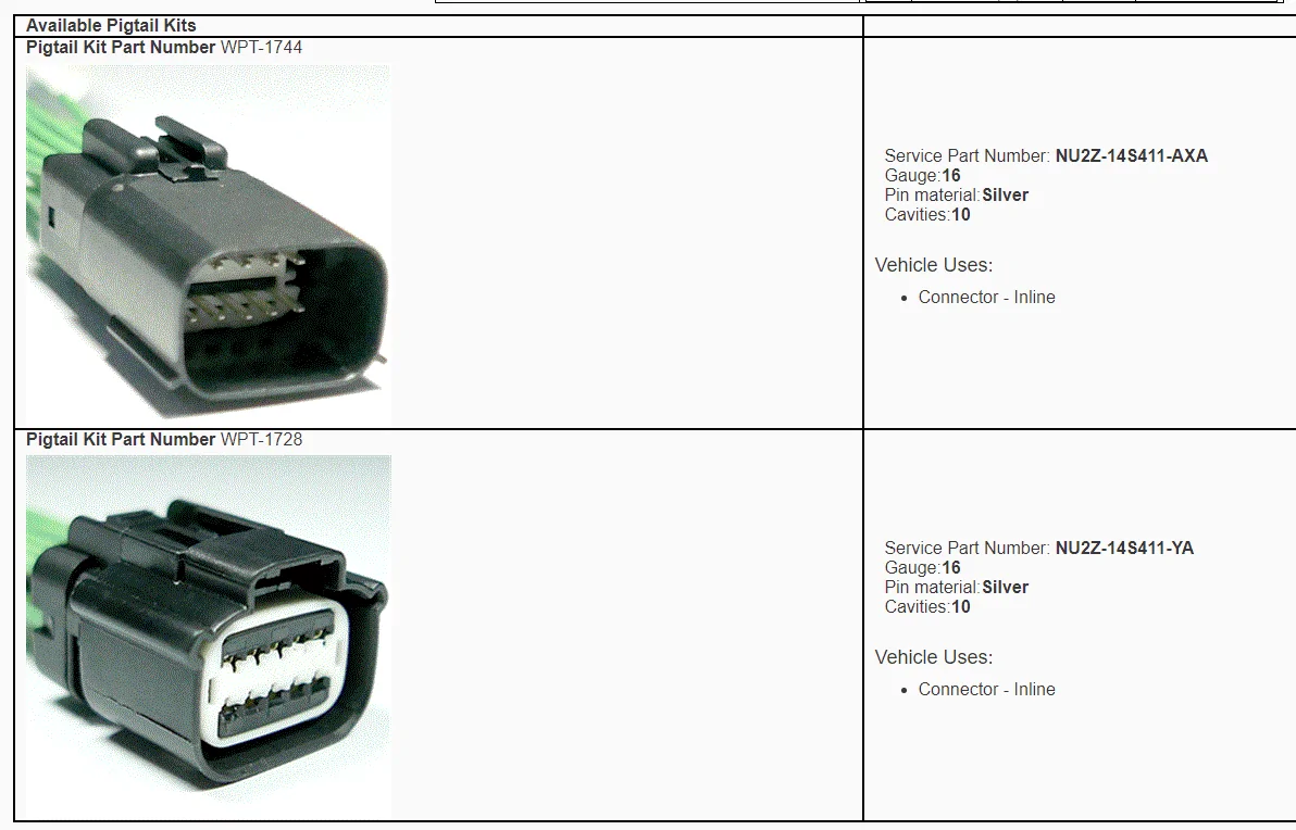

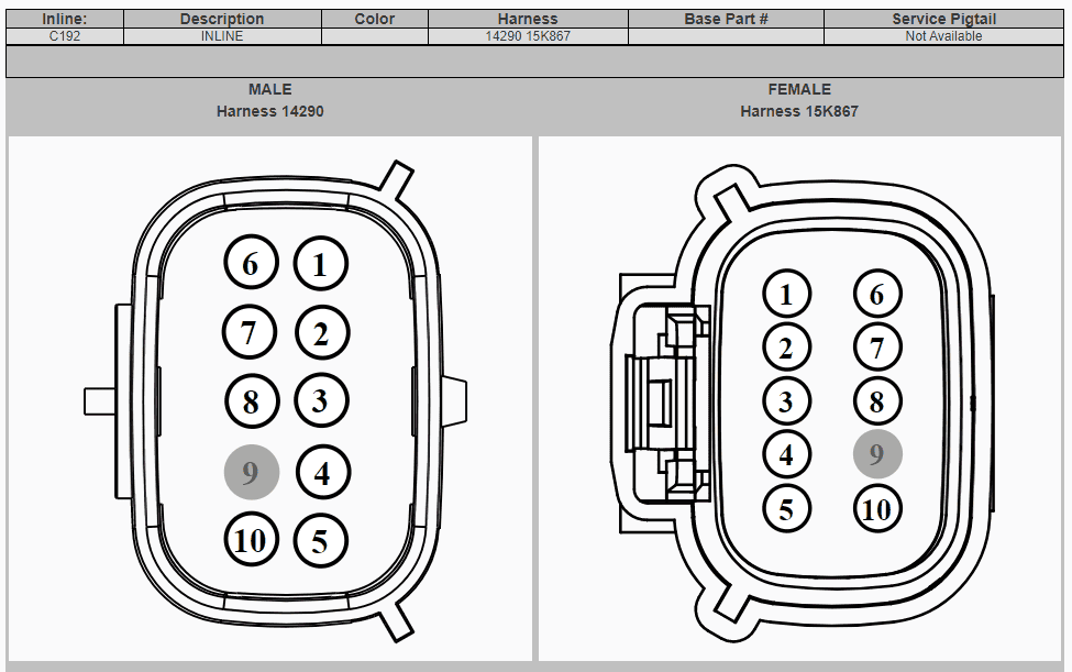

Connector not available from Ford yet. Not sure if this is a WDP part or someone else. What I've done in the past is get a magnifying glass out and look for any numbers etched or molded into the connector somewhere (it's generally damn small). TE, Yazaki and Molex are used heavily in Ford stuff and if you have a number, can usually find it. It's going to be some version of a sealed 1.5 series.
HEY WERE WE ABLE TO IDENTIFY THIS PART? I WOULD LIKE TO SOURCE IT.
