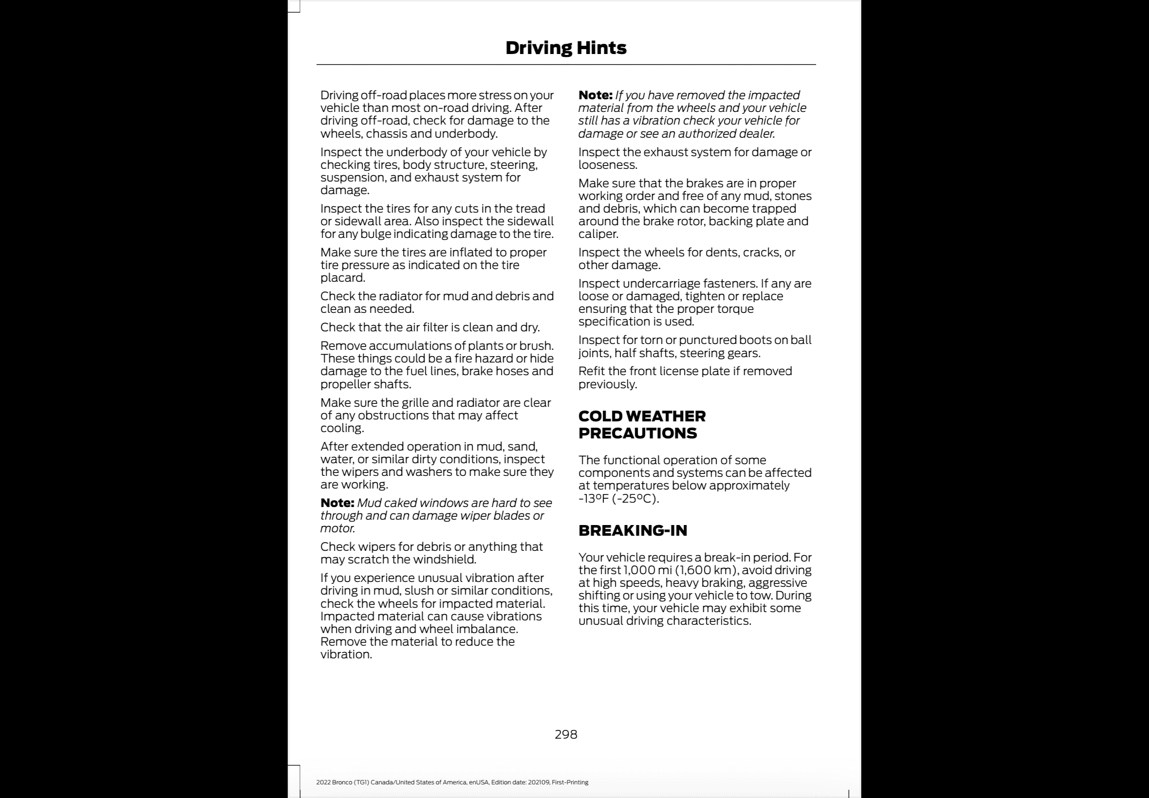

I spent the last hour reviewing the manual trying to find something about the engine break-in period, came up empty, was about to give up then I found a reference to where it’s at in this thread (Page 297 of the 2021 manual).
I copy and pasted the information below and this is the only thing I can find in the manual regarding break-in period and there’s nothing specific regarding the engine. The key wording is “Your vehicle” and that doesn’t mean just the engine, rather it means the vehicle including brakes, drive train, transmission, engine, steering, etc. Drive it gently, let all the components get lubed up and develop a little wear and you’re good to go. Further if the engine required a specific break-in procedure that would be detailed in the manual, especially in this day and age of litigation. There would be a page or pages dedicated to exactly what needs to be done to break in the engine and it would be right at the front of the manual with lots of bold print, not a tiny paragraph in the last 2/3 of the book in an obscure section that most will never read.
After reading all the commentary about engine break-in on the forums I expected to find something very detailed with precise instructions in the Bronco manual and that surprised me. Being a boat owner and running Mercury outboards (my current engine being a 2020 400 HP Verado) I’m pretty familiar with engine break-in procedures but I haven’t seen anything about this related to a new car or truck in at least 35 years so my curiosity drove me to search the manual for whatever was getting people so concerned.
For those who have a desire to see exactly what’s written in the manual I give you page 298 of the 2022 Bronco manual:
BREAKING-IN
Your vehicle requires a break-in period. For the first 1,000 mi (1,600 km), avoid driving at high speeds, heavy braking, aggressive shifting or using your vehicle to tow. During this time, your vehicle may exhibit some unusual driving characteristics.
