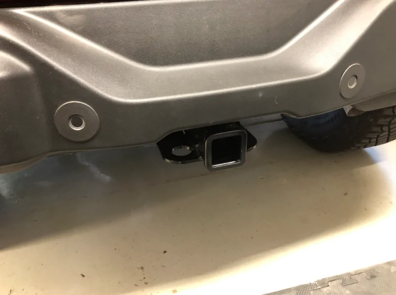

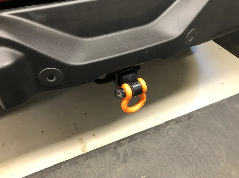

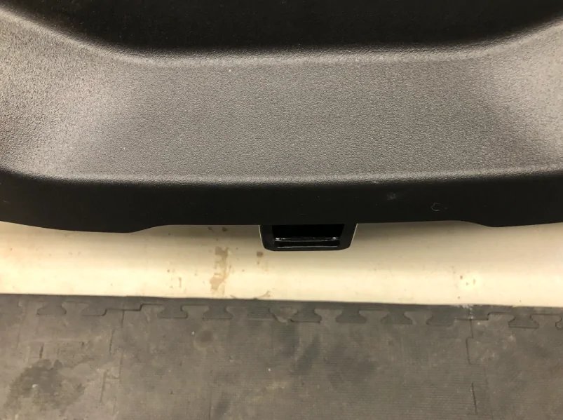

I just bought a Curt off Etrailer, for ~$100. I got it for a bike rack, I don't plan on towing anything, so no need for any wiring. I chose the Curt because it's a short neck, the receiver opening is actually inset slightly from the bumper. Install was easy, just have to loosen the bumper to gain access to the bolt locations. This one is a good choice if you don't want the hitch to protrude out from the bumper. I'll post up a picture for you tomorrow.

Here you go... The end of the receiver is inset about 1" from the face of the bumper.

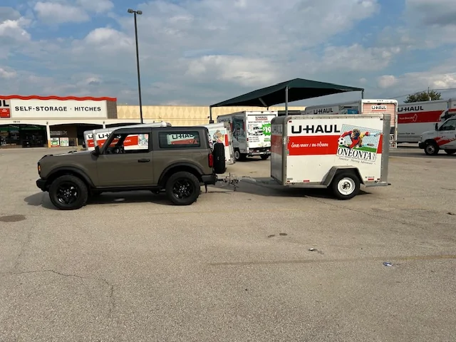

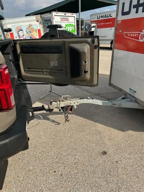

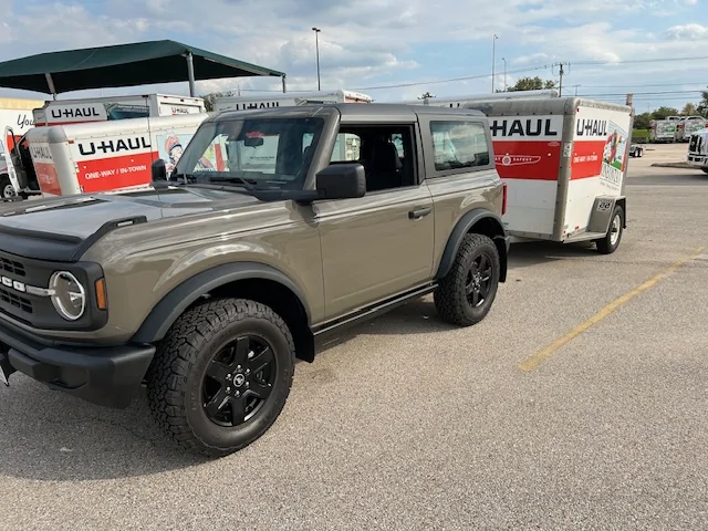

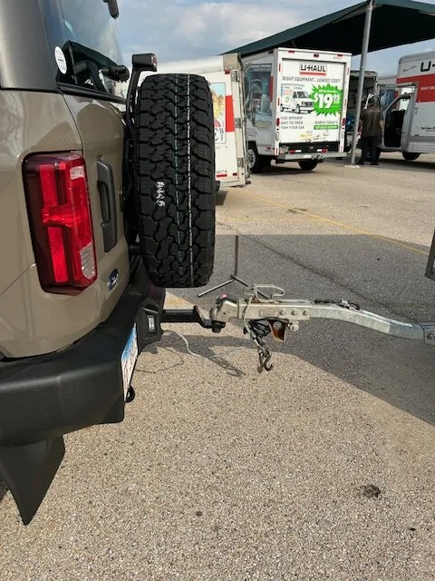

I have a 2025 base 7 speed. I installed the Ford hitch myself and was not hard to do. I just had to take it to my dealer to program the module which they did for me free. All is working fine. I got an extended ball mount to clear the spare. I went to U-Haul just to make sure everything worked by hooking up a 5x8. The end gate opens and clears fine. I could probably do another 2 more inches of drop than what I have but can't find the extended ball mount to do that yet.

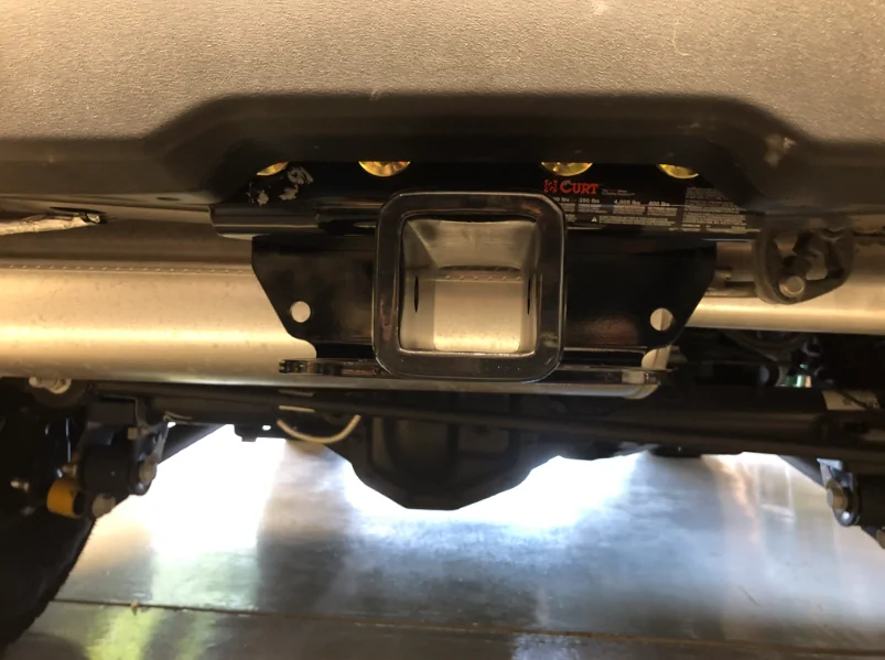

Curt hitch $100, module (for a 4-pin setup) $45. No splicing, basically plug & play. But the 2 bolts have to come off, either by cutting them or removing the bumper

It's not. Rear bumper just needs loosened enough to lift up a little to gain clearance for the long hitch bolts. Sure, you can take it clear off, but it's not necessary.

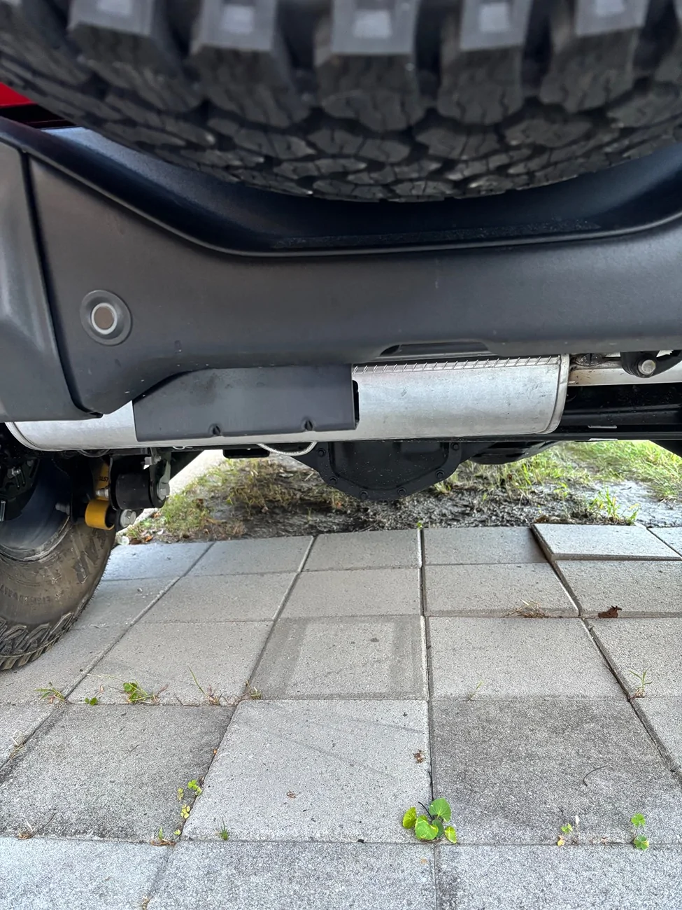

For MY21-23, loosening the bumper wasn't necessary (with the Curt hitch not the OEM), it was a 3 minute install if you inserted the bolts from the muffler side.

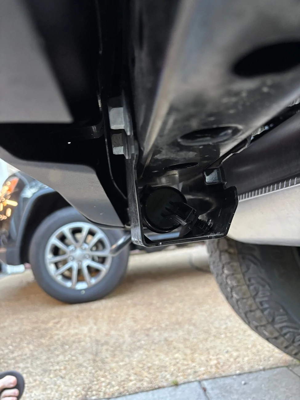

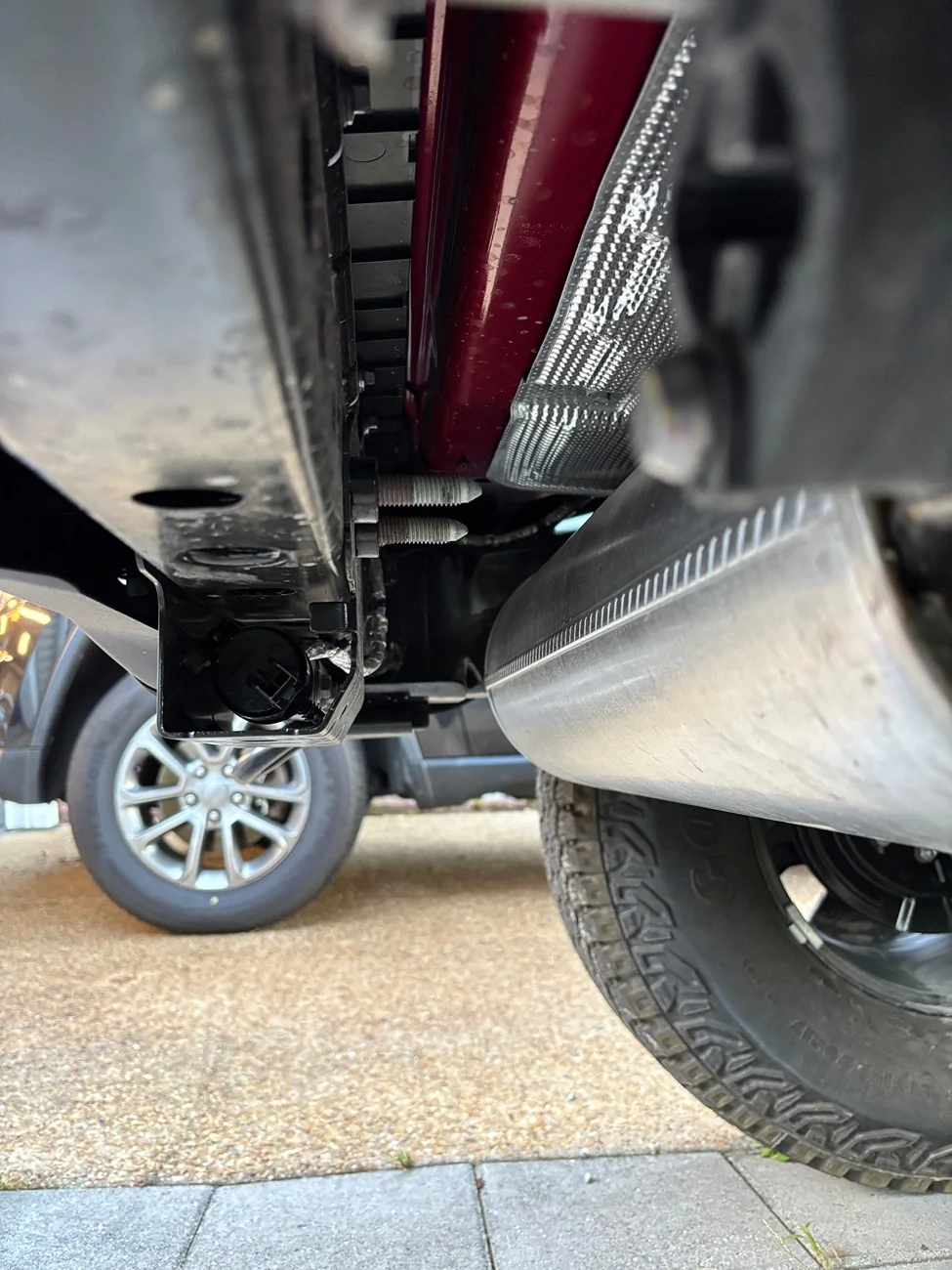

'25's come with a plug to plug in the factory hitch wiring and Ford bolted a giant cover over it with bolts that are about 3" too long to get out.
