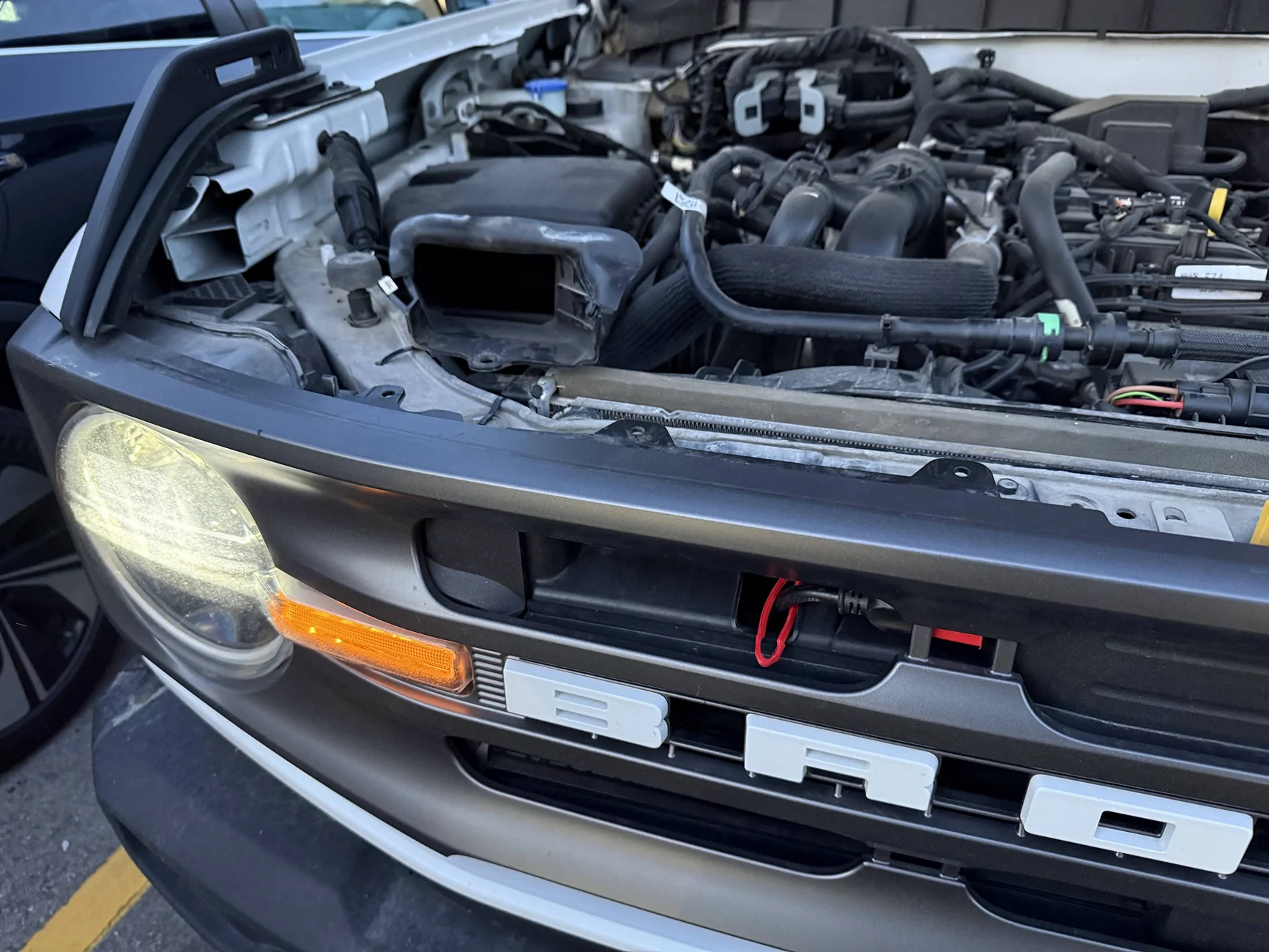

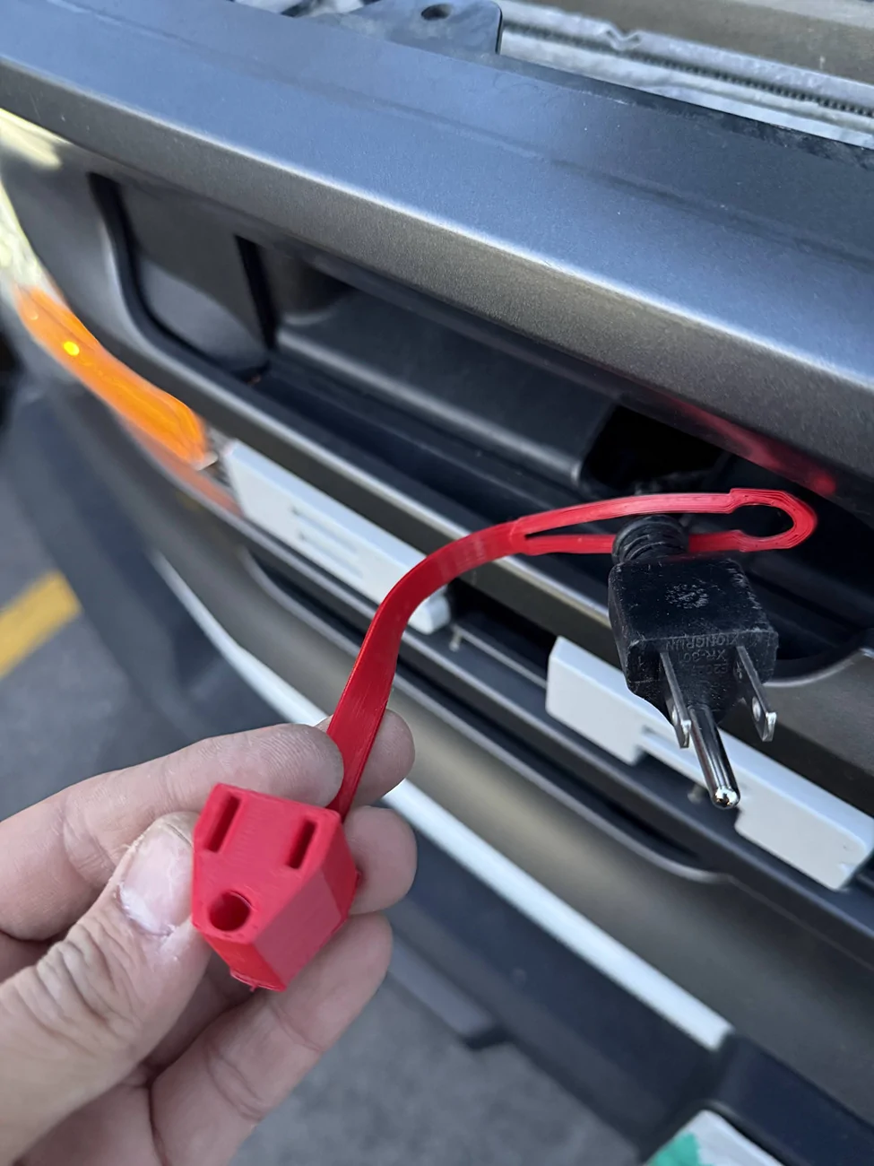

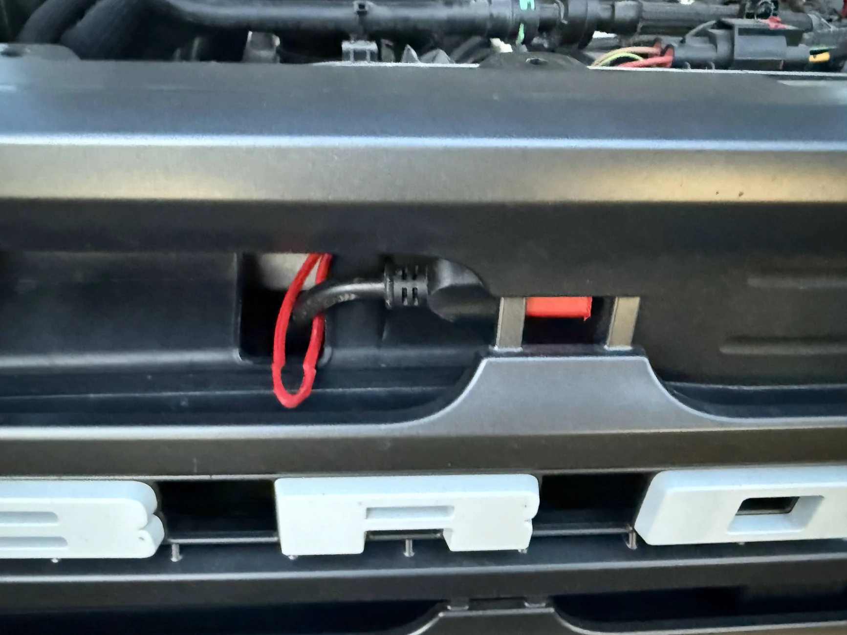

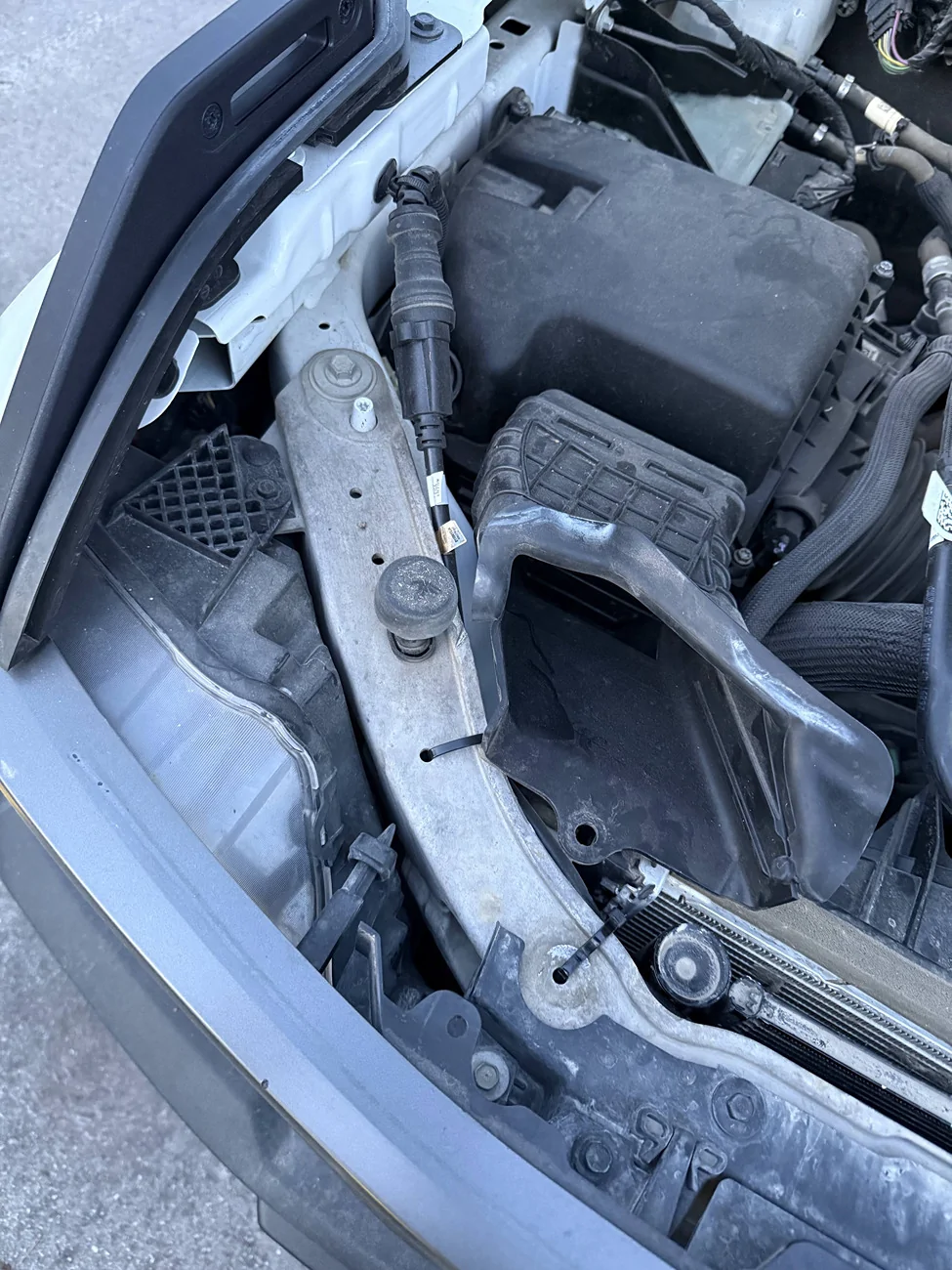

I did a mod by adding a short (2ft long) extension cord and tucking it under the grill and front cover. See the pictures and let me know if you see any issues. Initially i tucked it closer to the middle but it was interfering with movements of the active louvers so I brought it up closer to the top. I filmed it and it seems fine now (I think). Maybe this is something someone will find useful OR let me know if I am out to lunch so I can get rid of it.
PS: I also 3D printed a TPU prong cover which I will place a link to.

3D printed part: https://www.thingiverse.com/thing:4699240

Just unhook 2 clips and skip the extension. I unclipped about 4 and ran it out the bottom through my bumper, since I didn't have a OBX grille.
I should have done that but it's too late now. We will see if I have any issues down the road.
