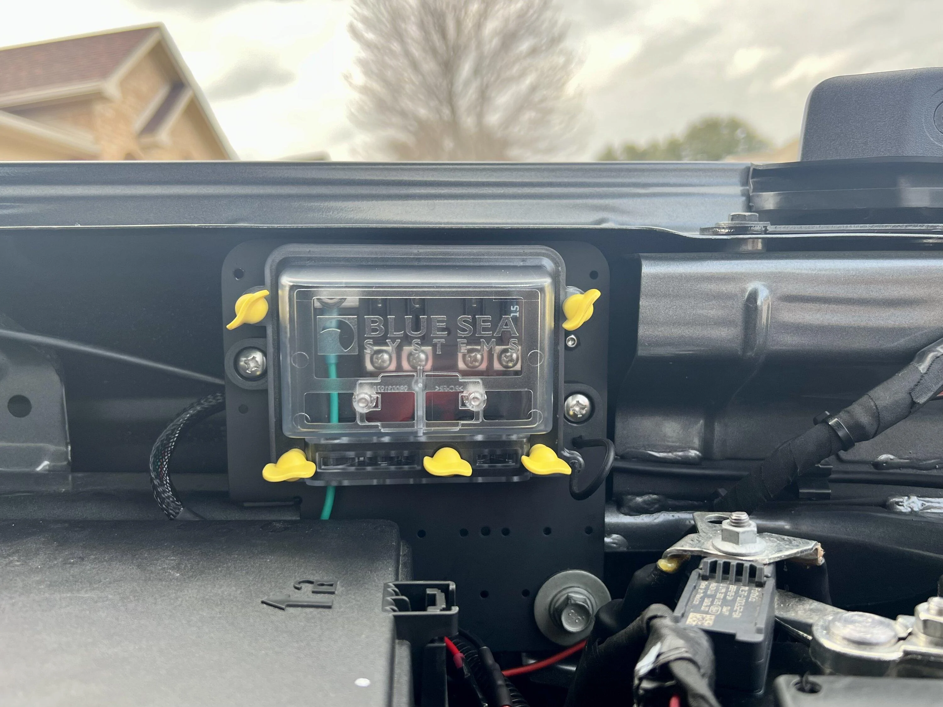

So here in a bit I'll be adding the whole fog light set up and kinda like the way the amber back lights look. I did have an issue with having a bunch of wires tapped into a single fuse for my switched 12V so decided to add a relay and a small fuse block to make things a little safer and allow me to add on to it if I need to later. This is what I ended up with a Blue Sea Systems water resistant fuse block, seals all the way around and around each wire, built for boats but wanted something that sealed up for the Bronco too just in case it ever gets wet under there.

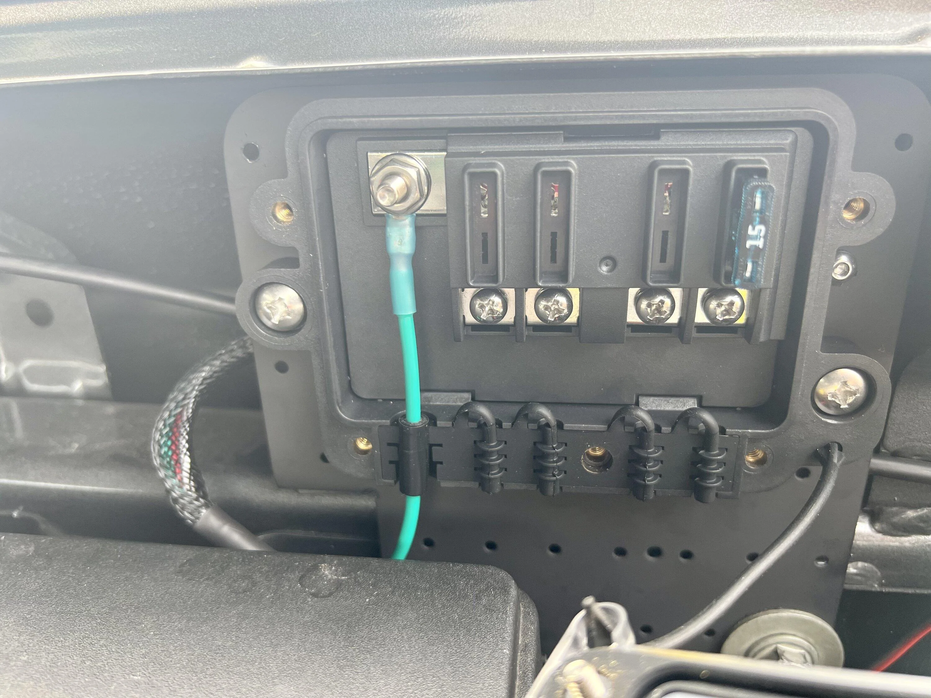

Inside I have the Switched 12V coming in (green wire) and then 4 circuits that can then feed back lights or other stuff I may need eventually. I have the whole setup rated for 40 amps but don't think I'll come close to that. Will probably set up two of them for 10amps then two 5amp circuts for my backlights.

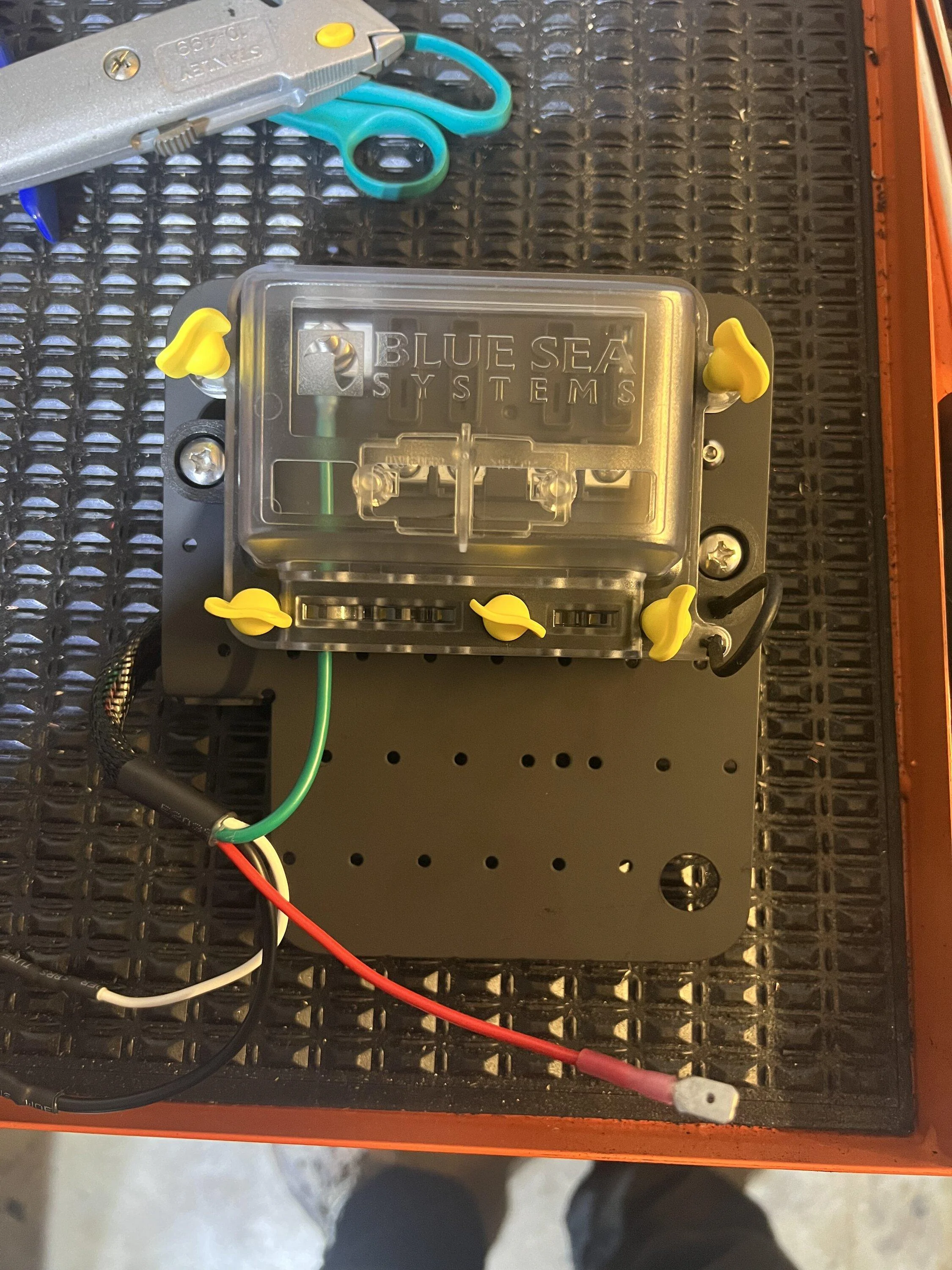

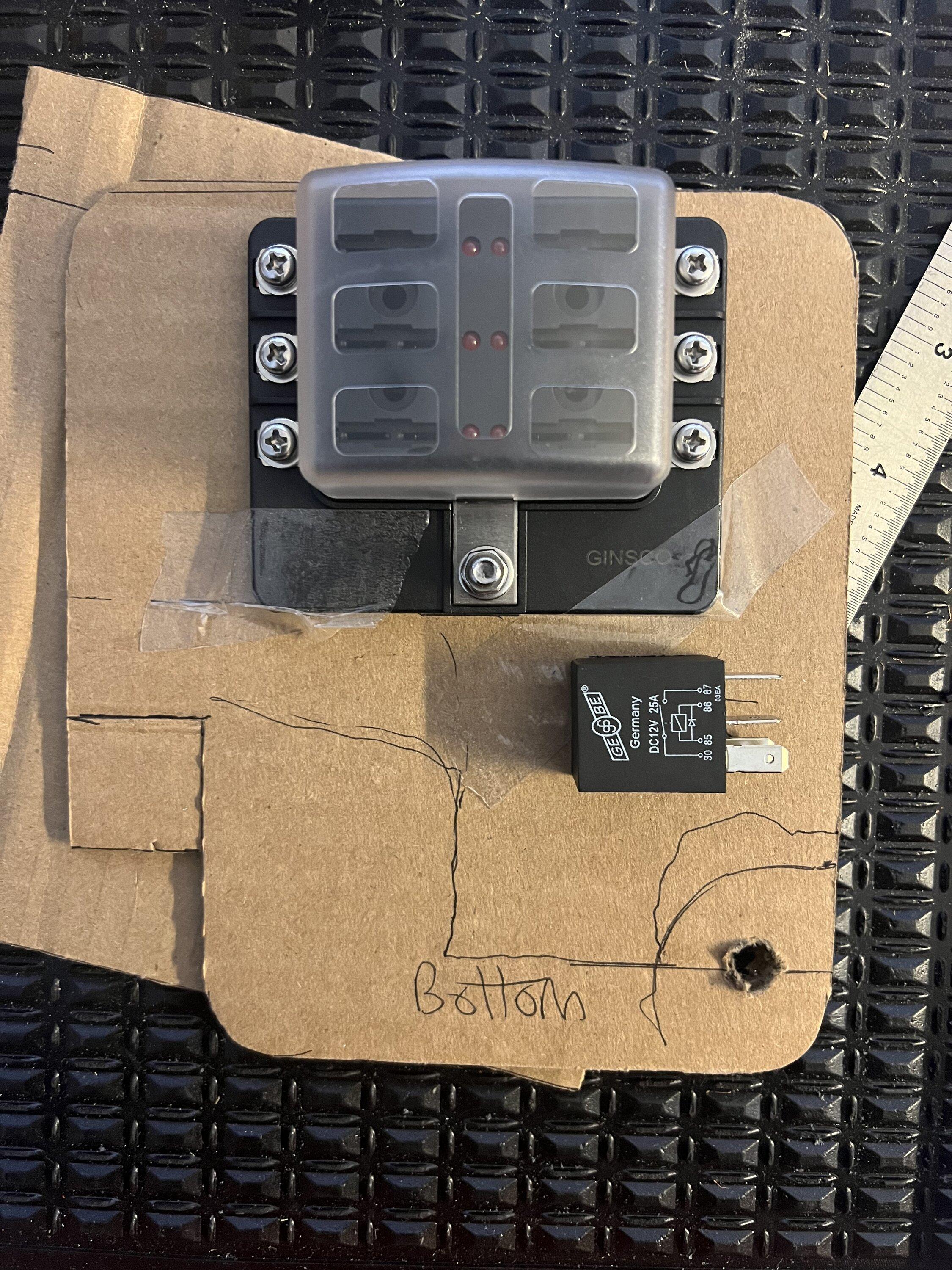

So this is what I started out with, a cheap little $10 unit and smaller 25amp relay from Amazon. What I didn't like about it is that it didn't seal up and the back of the block has exposed metal that shorted out when installed onto the bracket, very poor design. But laid it out on cardboard first to get everything mocked in place.

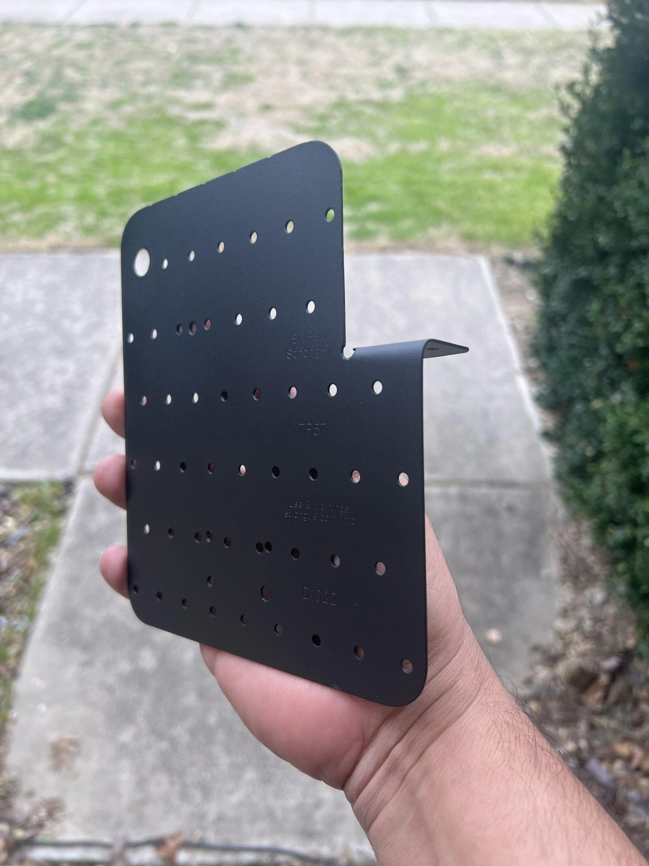

The bracket is a Galvanized Strong Tie bracket from Home Depot, it was cheap, like $3 but thick enough so that I didn't have to worry about it bending, but too it was thin enough for me to bend with what I have here at home. Added a couple of bends and holes and it was good to go. Primed and painted it flat black so it didn't stick out too much under the hood.

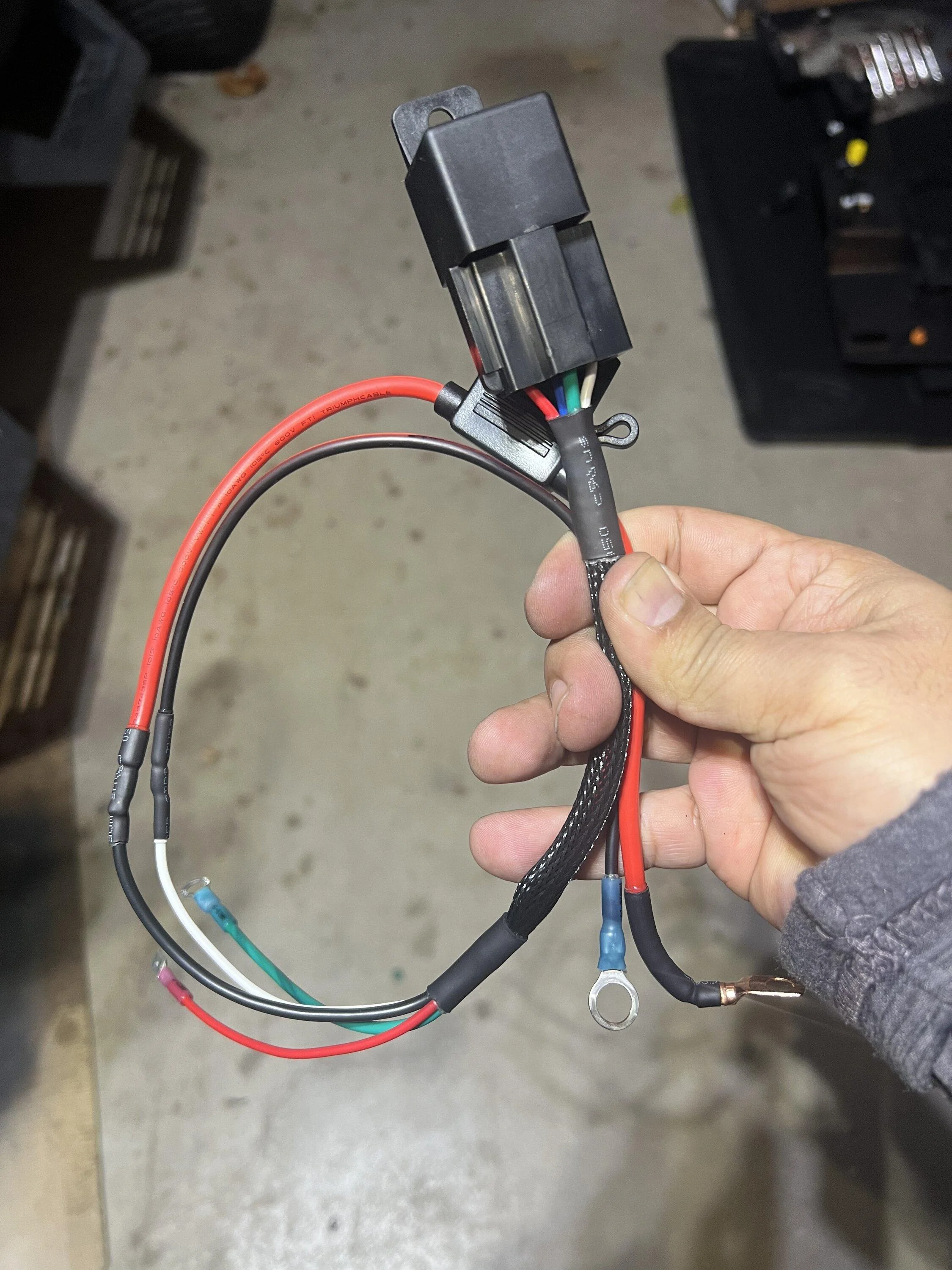

Here's the relay and harness I made, the relay is a 5-wire 40/60 amp relay with a built in spike supressor (diode supressor) to avoid back voltages when the relay de-energizes. I saw quite a few videos on youtube talking about the amount of voltage that can get induced into a circuit once the relay is de-energized (100V+) so I didn't want to take a chance of it blowing up the circuit I used to trigger the relay. If you guys end up doing something like this don't go buying just any relay on Amazon, make sure it has spike supression. Yea if you're using it to power a fuel pump or cooling fans then a regular relay is probably ok, but for anything electrical I'd suggest you get one thats protected. This relay can handle 40amps NC and 60amps NO, so decided to go with 40amps just to be on the safe side. There was a 60/80 amp one on Amazone but thought that would be a bit overkill.

Here's the fuse block mounted on the bracket ready to be installed. Overall I'm pretty happy with it. Feel a lot better adding accessories to this than tapping one circuit over and over. Have plenty of inline fuses here so it's super safe and I don't have to worry about it pulling too much current. Now just have to save up some money for my fogs!!! :)
