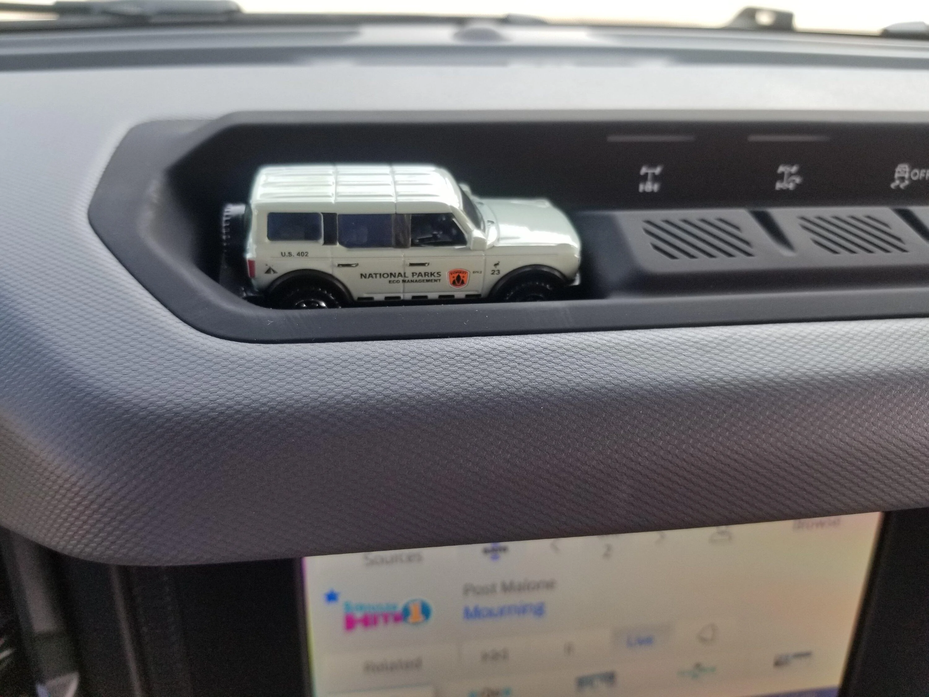

I'm going to try and revive this year old thread. My bronco has the 3 switches and a big empty space and no overhead aux switches. I'm wondering if I can swap out the switch bank here with a full set of switches and pick up some aux switches this way. Any new information?
The switch pack is basically its own module. Not a typical switch pack. The BCM supplies power to the switch pack, but each switch does not have its own dedicated power or ground. The FD-CAN then provides input messages to each of the switched components. So without the input messages from the FD-CAN, the additional switches would be nothing but decoration.
Long story short.. add switches somewhere else.

Thank you for the straight answer.
