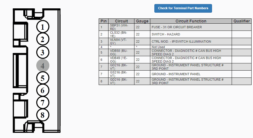

The switch pack is basically its own module. Not a typical switch pack. The BCM supplies power to the switch pack, but each switch does not have its own dedicated power or ground. The FD-CAN then provides input messages to each of the switched components. So without the input messages from the FD-CAN, the additional switches would be nothing but decoration.
Long story short.. add switches somewhere else.

No. How would you run your own power and ground into one specific switch? Like I said, these aren't just normal on/off switches, it's a module with an internal circuit board controlling what each button press does.
