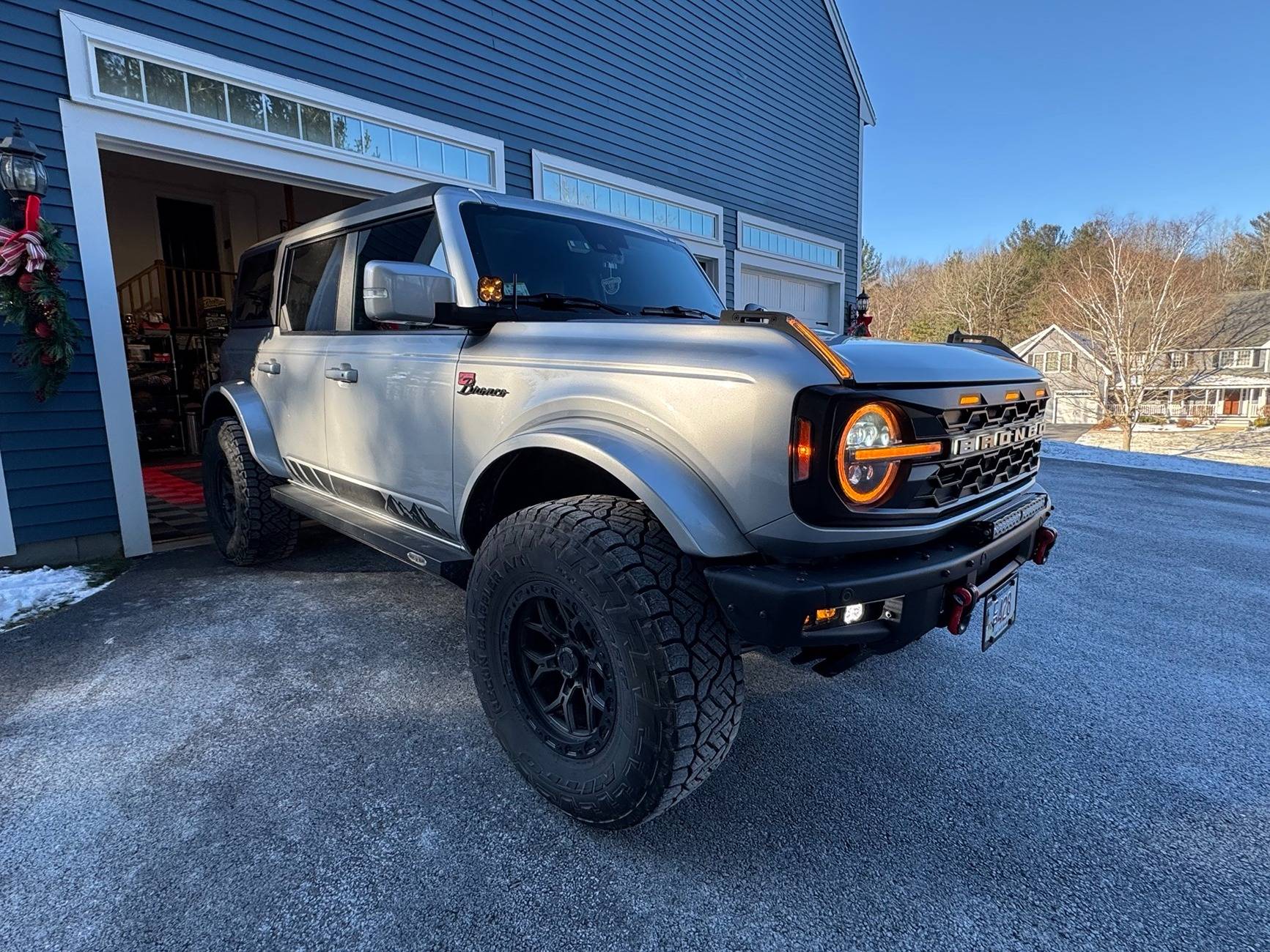

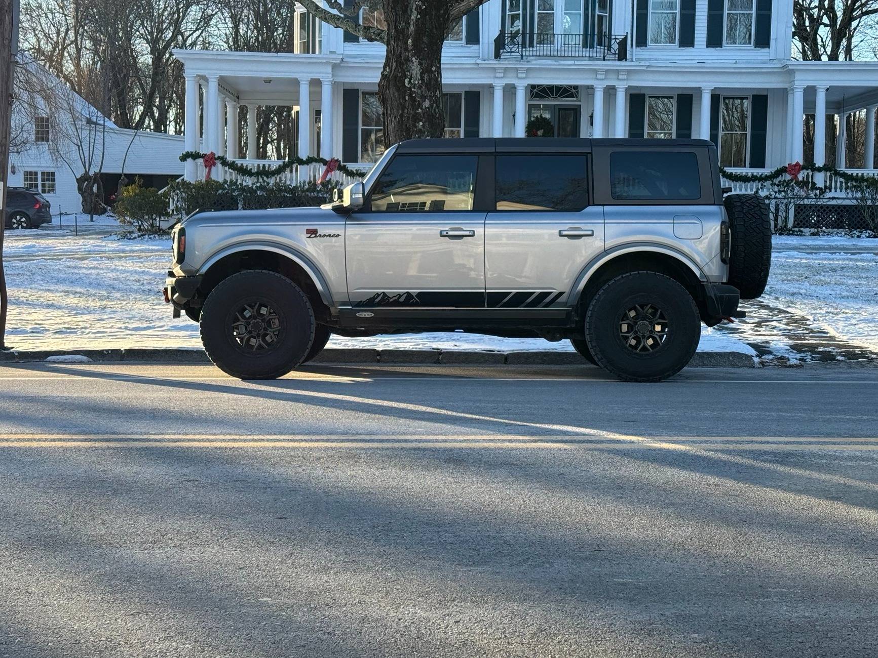

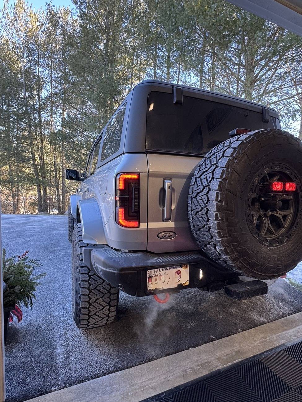

I purchased the set from Shock Surplus and they installed the spring/shocks prior to shipping. For a stock SAS suspension and wanting to retain as close to the same height and leveling out, they set the rears on the 1st setting, and the fronts on the 3rd. Pretty much came out level with about maybe a 1/2 - 1" increase in total. Super happy as many have indicated on the ride quality and with the Nitto Recons it helps with softening up the ride where needed!!!!

Several questions
Are the Recons 3 peak rated?
315/70r17 non LT?
Is that an optical illusion or is the rear squatting in the side profile?

I think the tires are LT E load so that’s why they are so stiff. Don’t think they are 3 peak rated.
must be the pic or the angle I took the shot at, but it’s pretty level! The folks at surplus shocks recommended this setting to get it as close the stock SAS but leveling out.

In my first post there are pics of what it looks like post install with 35s. My goal was to keep it as close to stock SAS height, so the rear is at the lowest setting ( about a .5” lift) so my default raised the front about 1.5 to make it the same height and get rid of factory rake ( setting 3 I think). Hopefully that makes sense - if you are trying to get real height to get 37s in there I’m not sure what setting you would need but assume there is plenty of left you could get with raising the circlip setting!
