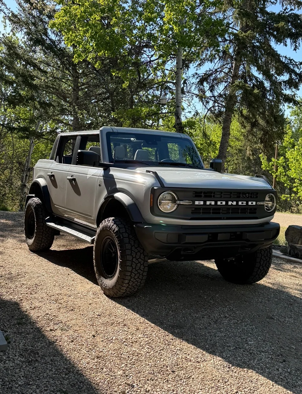

I have a 2026 Big Bend and did a 3.5 inch lift with 35x12.5x17 wheels. No rubbing and love the stance.
Ford Bronco Big Bend Tire Upgrade - what do I need to know? IMG_1182
