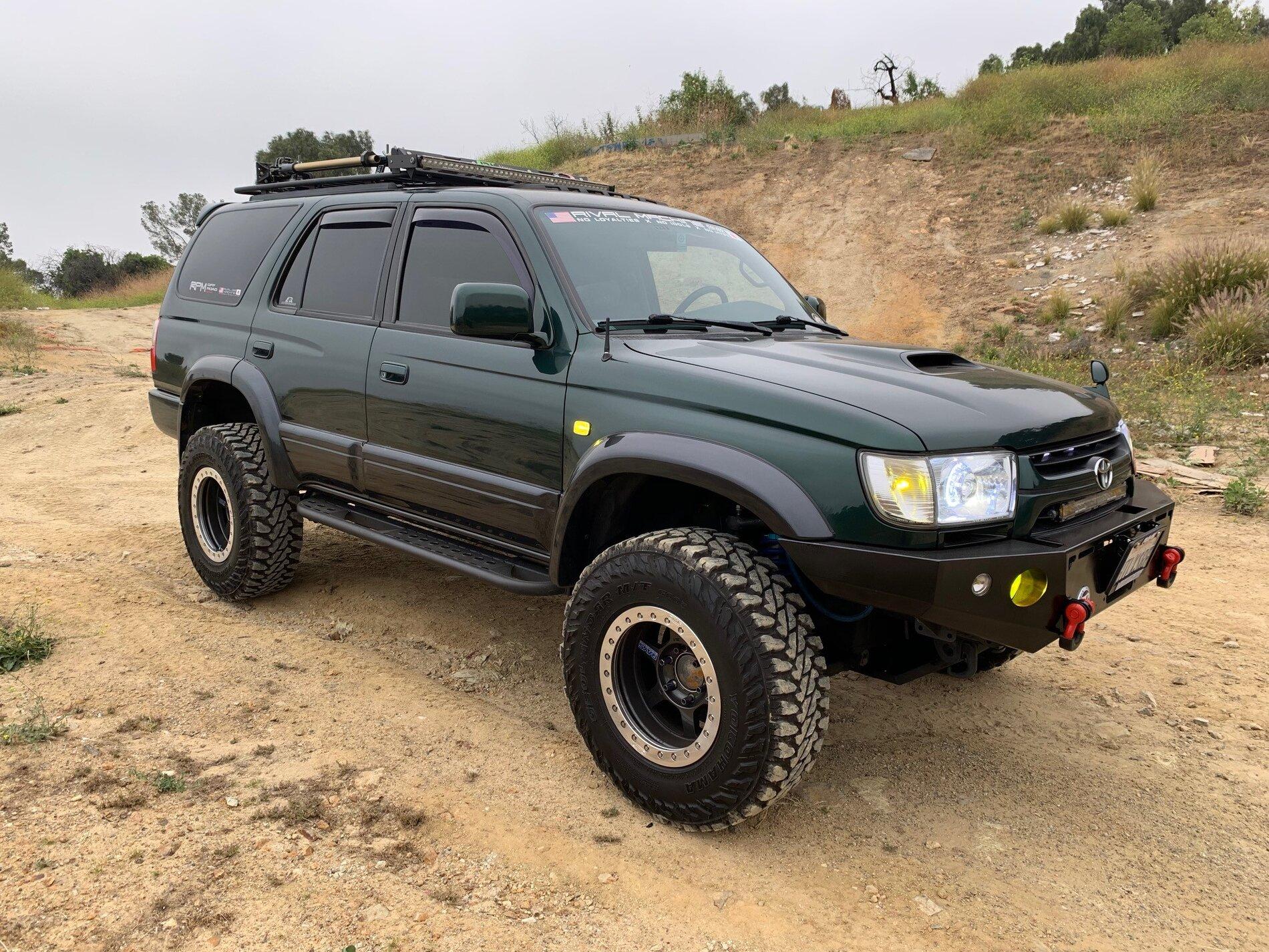

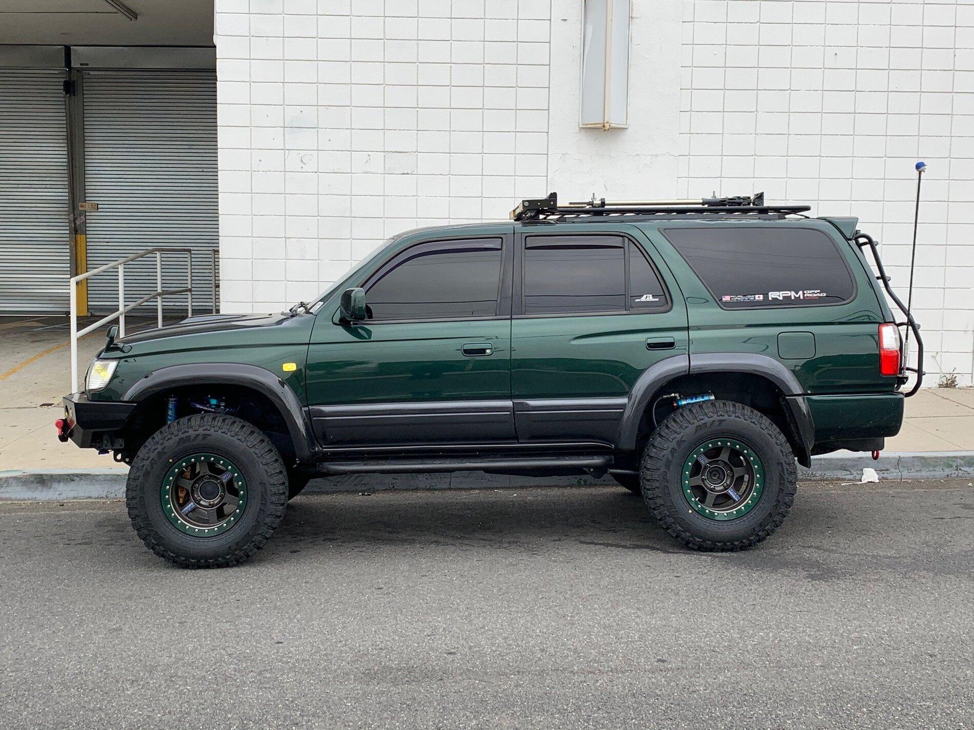

if you are not planning to offroad ofthen where you are indeed airing down to gain more traction do not fiddle with the beadlock option.
1. tire shops hate beadlock wheels and most will refuse to mount and dismount them. take this hassle on at your own risk. i personally know friends in the industry and usually can gety into a shop to do my own mount and dismount of my wheels and tires.
2. beadlock wheels require more time to work on and maintain. you will also need to torque down to spec and re torque every first 100 mile, 500mile,1000 mile and 3000 mile to make sure they are torqued to spec and seated properly after each time the beadlock ring comes off or when you change tires. if you bolts show fatigue or wear you will want to change them out so they dont fail. i run arp stainless hardware on my wheels expensive but i dont have to change them out due to corrosion on zinc plated bolts.
Super nice ride, any pics aired down to 8 psi rolling over some boulders!!??

good lord I never liked the look of bead lock until i saw these - sweet
i drive on the beadlocks 24/7 365. they have never leaked or let me down. when done properly they will do their job. the are a 1 of 1 set done for me after i hit a curb at high impact during an acident a few years ago.
think long and hard before going beadlock. do you really need it? or is it just a cool factor thing? i use my beadlocks to airdown to single digit psi when i wheel. with these wheels i have aired down to 8 psi to wheel before. beadlocks arent dot aproved normally or street legal only 2 brands that i know of that are street and dot aproved beadlock wheel manufacturers. Hutchinson beadlocks and Walker Evans Racing.
