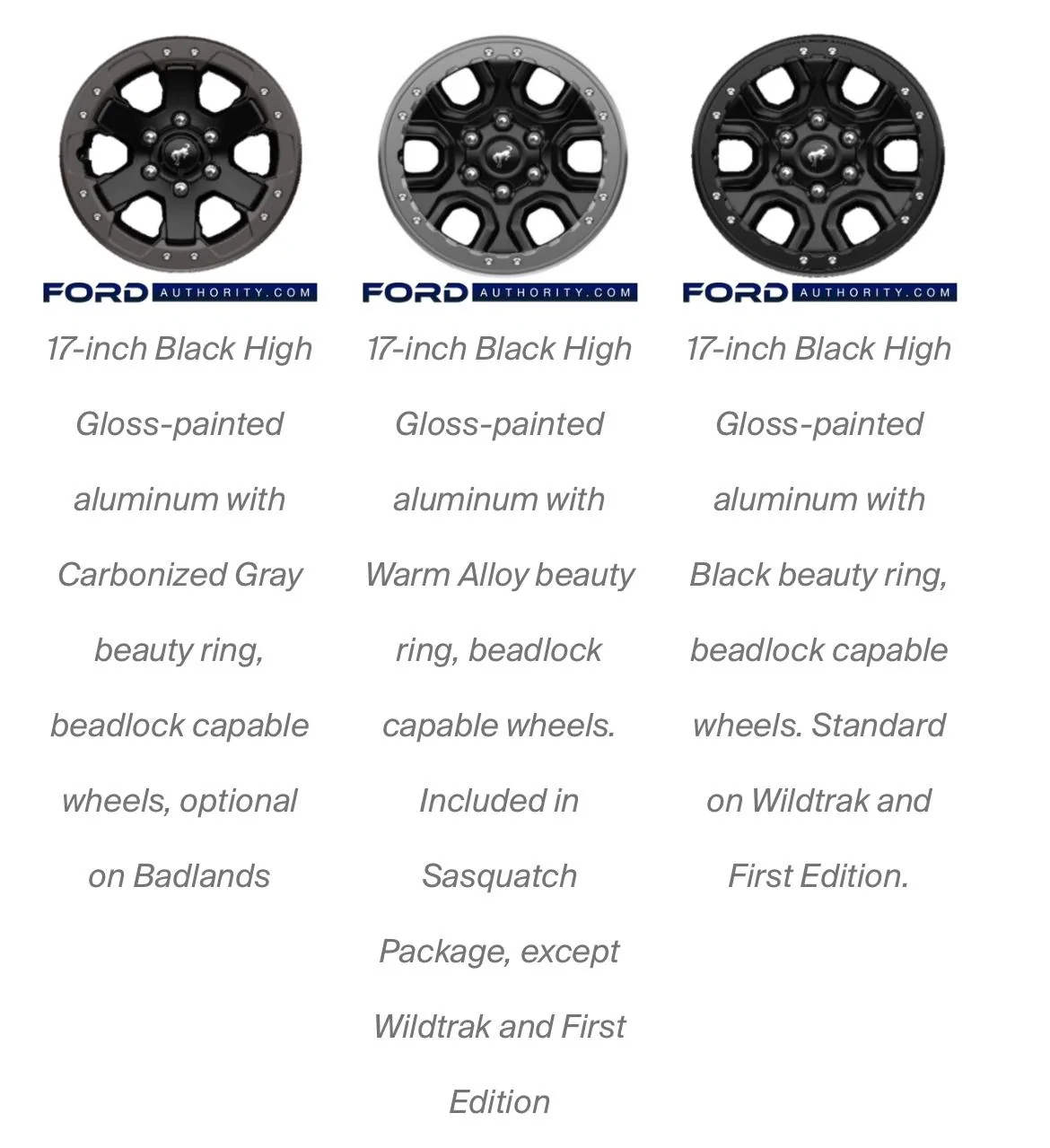

Sasquatch wheels are all black
Only the FE and Wildtrack wheels are all black with black equity rings. All other models with Sasquatch are all black with a Warm allow beauty ring. (Silver)

What is a beauty ring and is it easily replaceable?
I'm going sasquatch but not going to beadlock it. The "warm alloy" look is not for me and I'm hoping the all black like the Wildtrack will be available for purchase.
Yes, you will be able to purchase different coloured beauty rings for your rims. They are shown in the Ford Accessory listings.
Also worth noting that the Badlands has a carbonized grey beauty ring option. But not with Sasquatch. I assume the rings will be sold separately at the parts counter.
Ford Bronco Beadlock capable wheels (rings) are factory installed? 12D7B893-AEA9-4EFF-AA35-FB36EAE198F5
