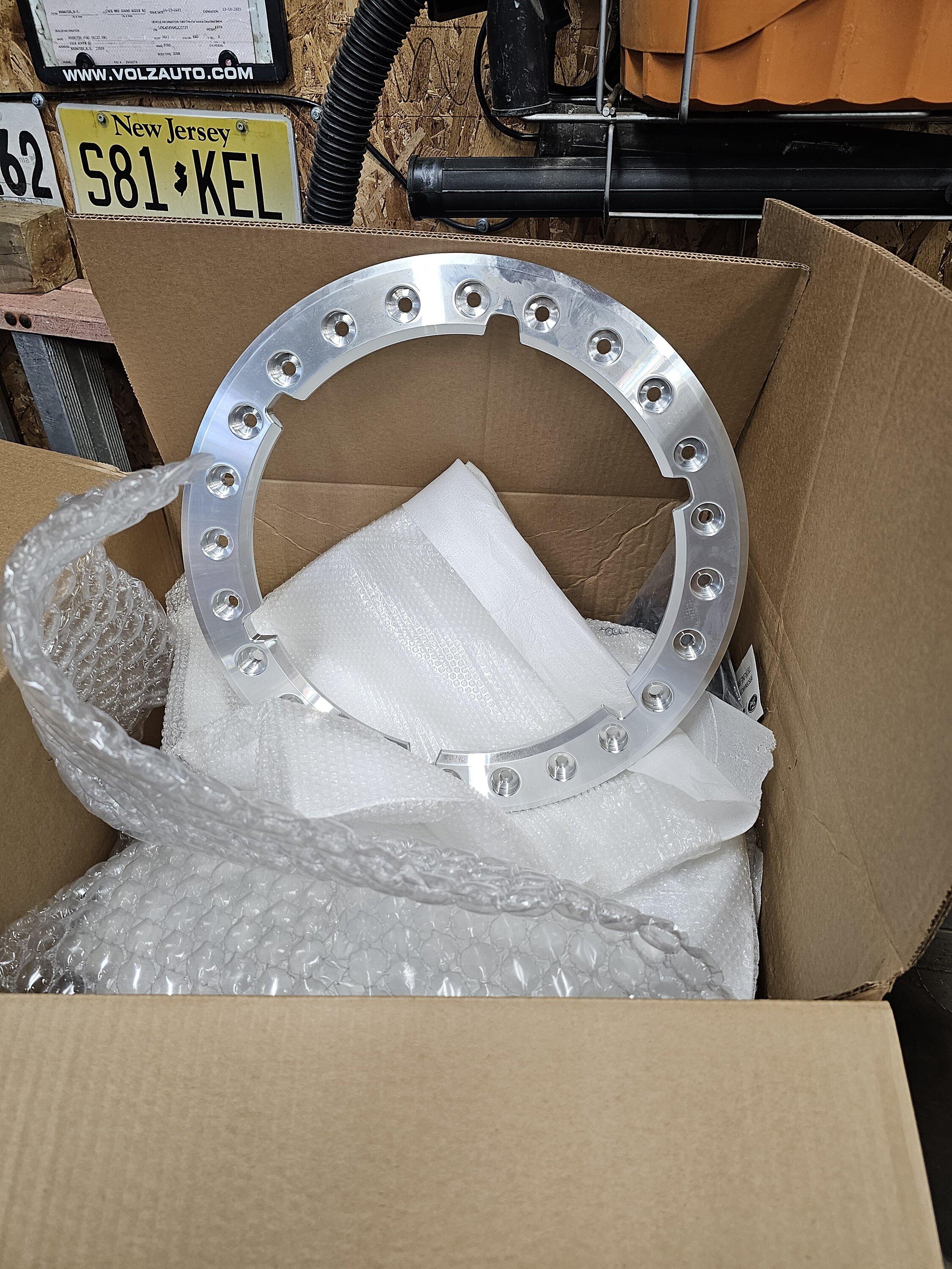

Picked up today
Ford Bronco Badlands Sasquatch Beadlock capable 20231124_091346
Niw the question is to powder coat black or not?
My FE has black and I really like it.
