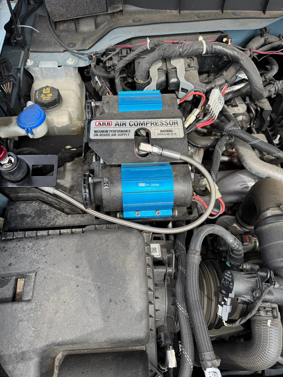

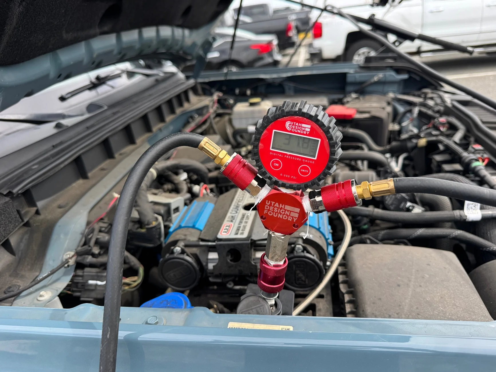

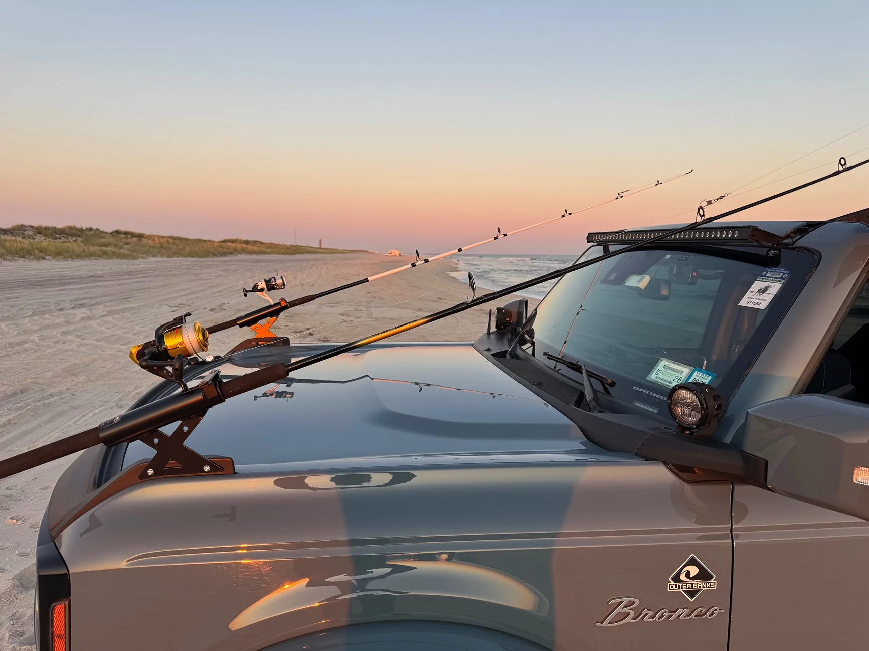

I highly recommend the ARB twin. You also need some fishing rod holders from Xrack.us

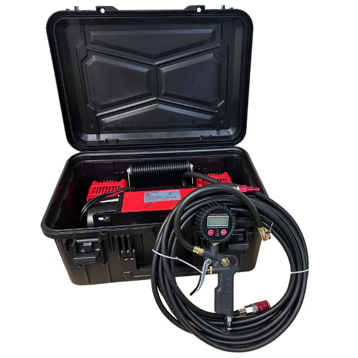

It can get expensive. Air-up times get to be a brag point, like we used to have with acceleration back in the days of muscle cars. (Dating myself, there.)
If you think you'll be airing up a lot, consider one of the NAPA-based two cylindar compressors. Moreflate, our own TrickyDick (a vendor here) are based on them, and I bought the ThorsLightning with the two-hose/four tire manifold setup. Once you do it a few times, you can get aired up in 10-12 minutes.
Ford Bronco Beach camping trip planned; do I need a new compressor? 1770219552697-eo
https://thorslightningairsystems.com/
Experiment with different pressures for the sand you're going on. Cape Cod sand calls for 10psi. YMMV. But with 4L or 4H, you may not need that. I found the Goodyear OEMs very adequate. If this is all new to you, remember to get out of 4L or 4H when you get back on pavement!

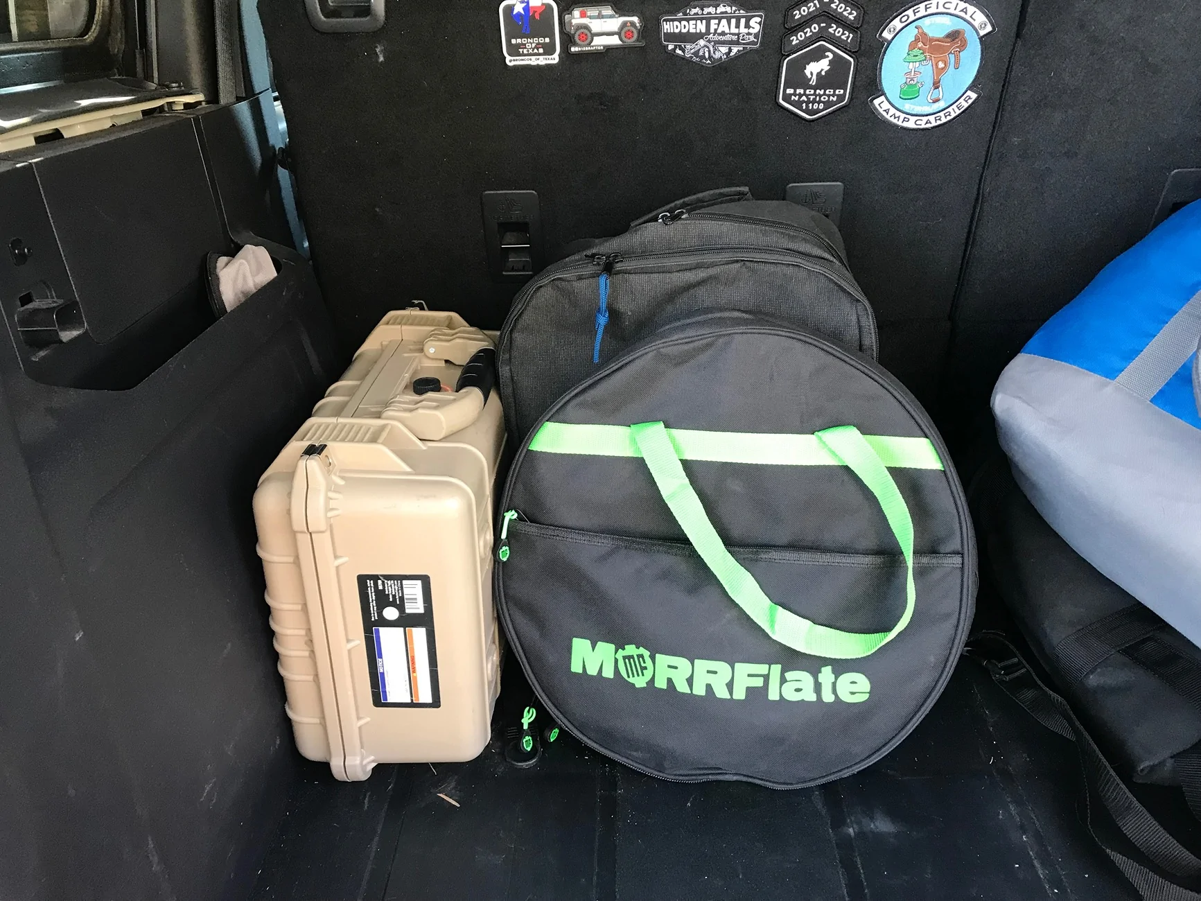

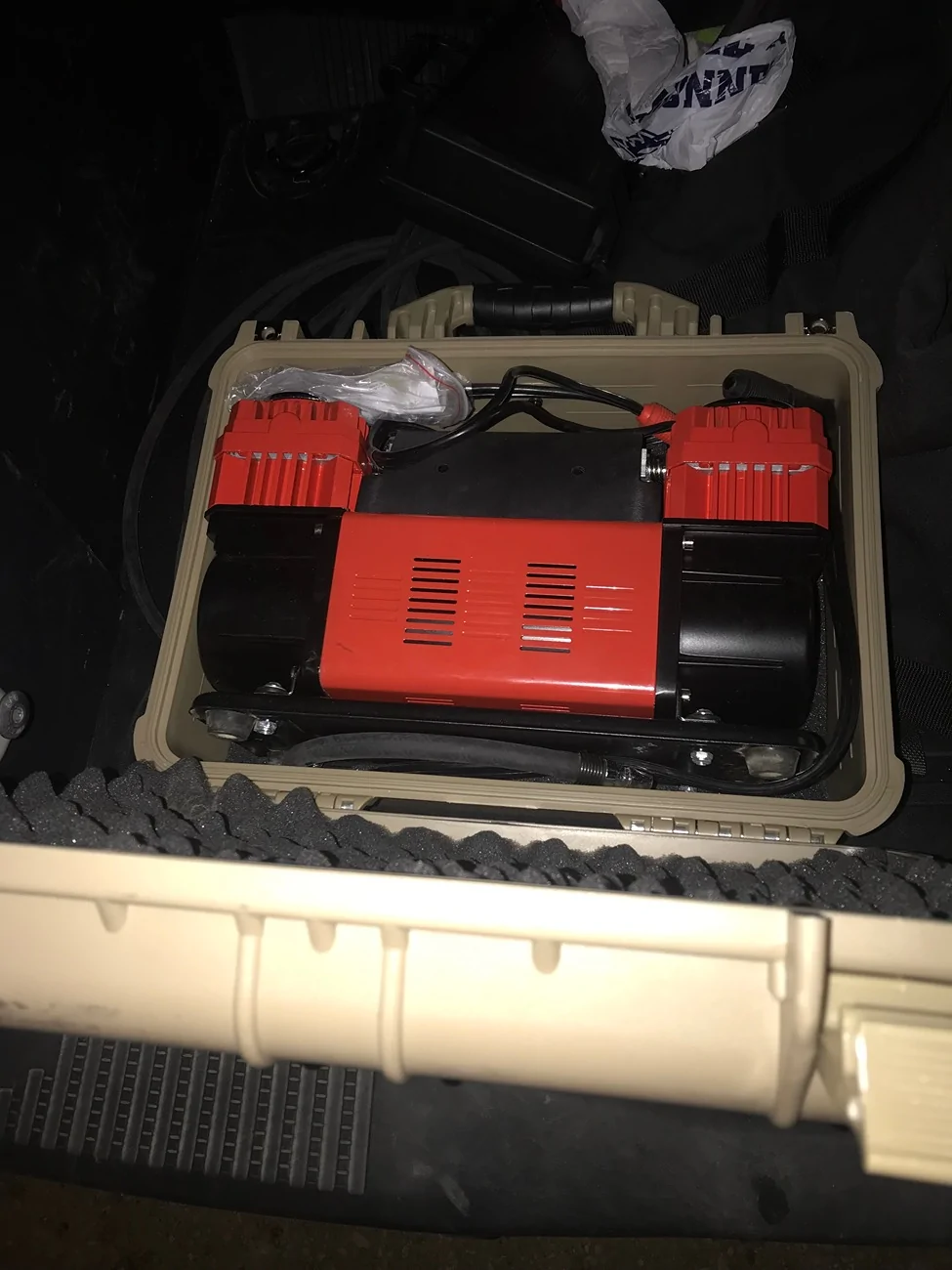

I hit the Texas beaches regularly and have not had a need to air down, figured if I need to air down I can do it when I need to. I have a modified trickflate and the MORRflate 4-way hose and the wife and I can have the Bronco aired up (18psi to 38psi) in about 7 minutes and that includes putting the hoses and compressor up.
