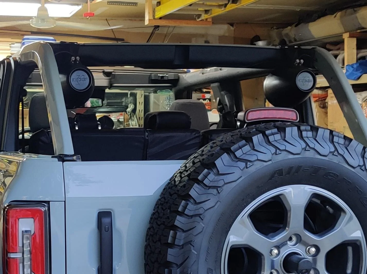

I've done alright with the PLA so far, printed a second version with more infill and just had to tighten them after some initial shrinking of the plastic! But I think I might still get them printed in ABS from one of the online print farms and test that out, but would be happy to "bring them to market" of the demand is there and the material holds up!
They definitely alot for good visibility out the back too!
Im very interested in the adapters also
