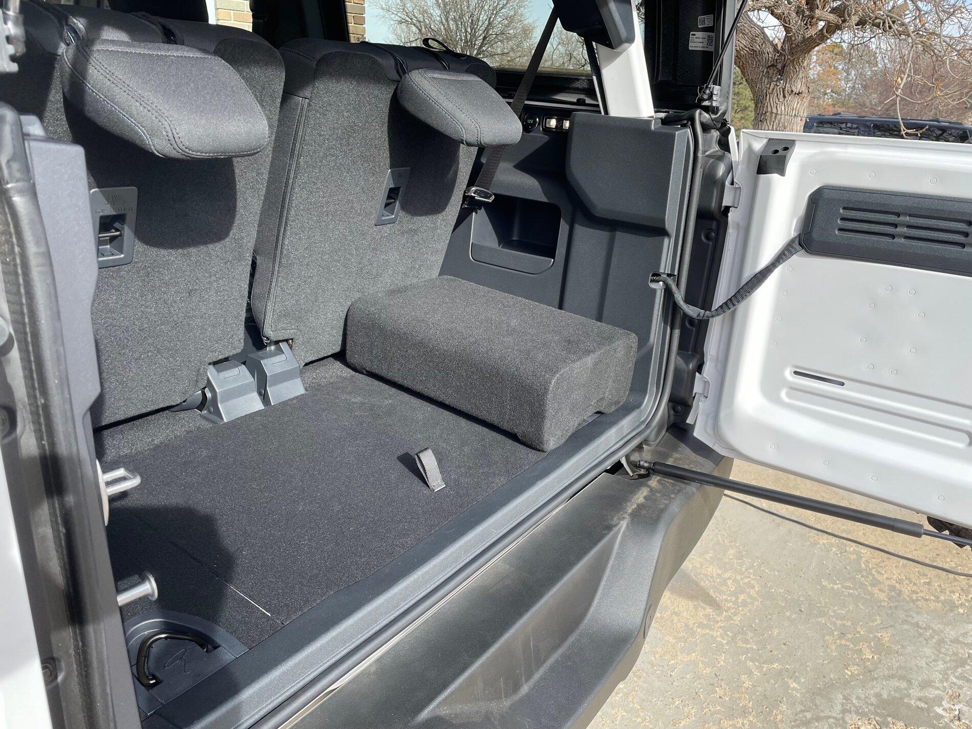

Big thanks to the contributors of this thread! I just completed my upgrade and am very happy with the results.
I decided to start with the addition of amps and a subwoofer, leaving the factory speakers to see if they would wake up with amplification. After install, I've decided that no speaker upgrade is needed - factory units perform very well with an amp and equalization.
I have included pic and model # of a great fitting loaded sub enclosure - even the carpet color was a near perfect match.
System:
Factory 6 speaker system (2 door Wildtrak) - now connected to a Kicker Key200.4 (installed in dash on factory knee brace/support). This amp did an amazing job with it's auto programming and auto equalizer (done with included microphone). Retained wiring in factory configuration (kick panel speakers and dash speakers on front channels, rear pods on rear channels).
Subwoofer/enclosure: Kicker 10" downfiring, shallow mount 48CVTDF102
Sub Amp: Kicker Key500.1 (installed under driver seat), also purchased the subwoofer remote level control Kicker 46CX (installed in recess below climate controls).
Sounds fantastic and capable of unbearable volume without distortion.
Thanks again for the info - schematics and pics were very helpful.

Looks great! Do you happen to have a picture of the subwoofer remote level mounting?
Thanks!
