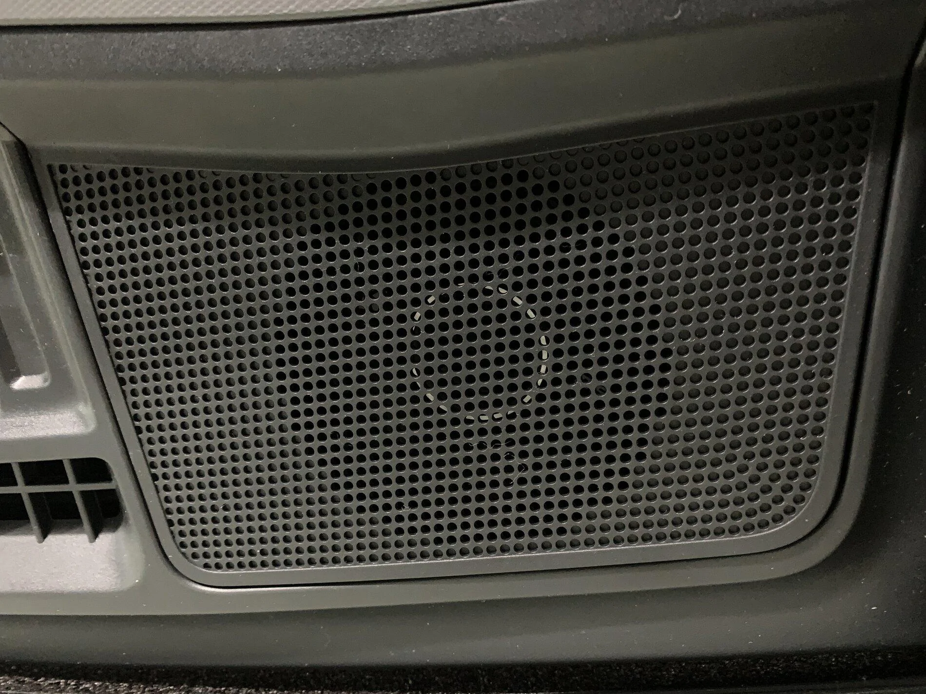

The grill only has holes above the 4 inch speaker so offsetting a tweeter in that space might be an issue unless your going to mod the grill as well. Originally, I was thinking of a 3 inch mid and 1 inch tweeter in that space.
If the tweeter is not cut out on the grill for the base model, it must be for the B&O. I will have to see the grill if it can be drilled out above the tweeter to look clean? Ford will have B&O grills in the future. Will the 3" and tweeter fit together under the cutout? Do you have pics of the grill? I would like to see both sides of it.

I do think the three and one inch would fit. Here’s a pic of the grilI. didn’t take a pick of the backside since I’ve already busted a tab on one of them. There are grill indents so I suppose you can drill them out.
Thanks for the pic! Looks like it can be drilled out for the tweeter and look clean. A punch tool and new drill bit will do the trick. Punch through the holes from top then drill from bottom. Easy enough.
