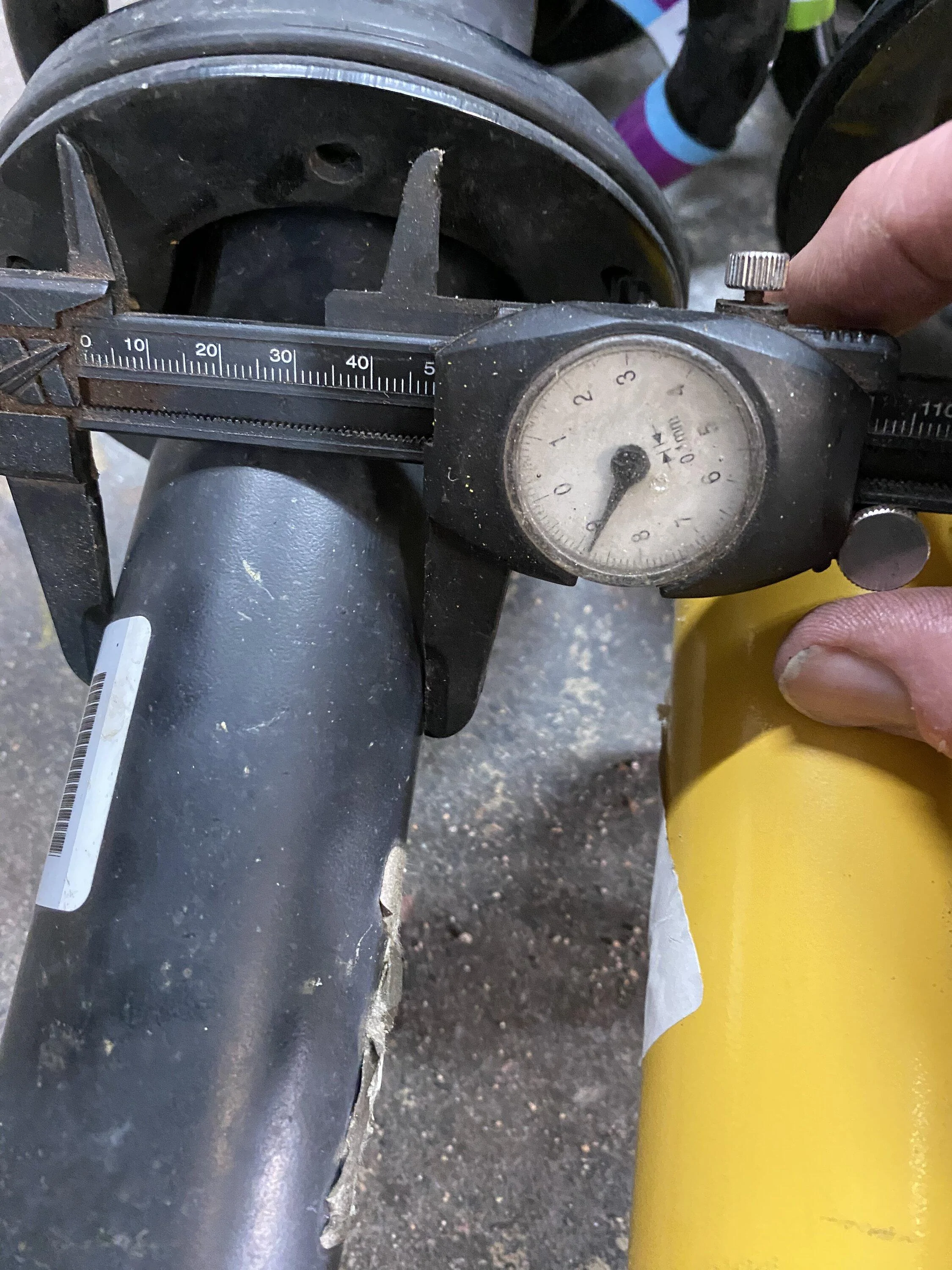

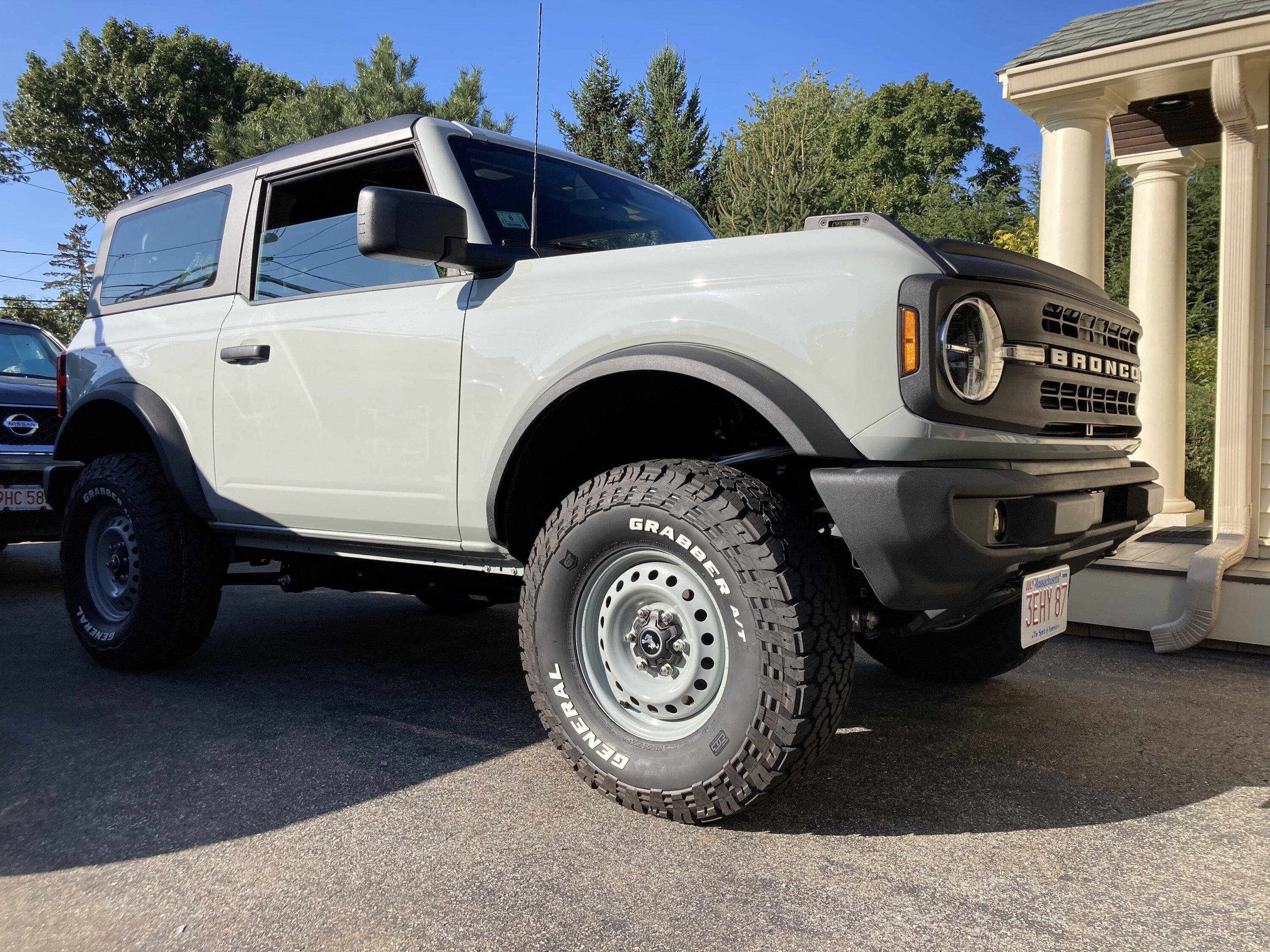

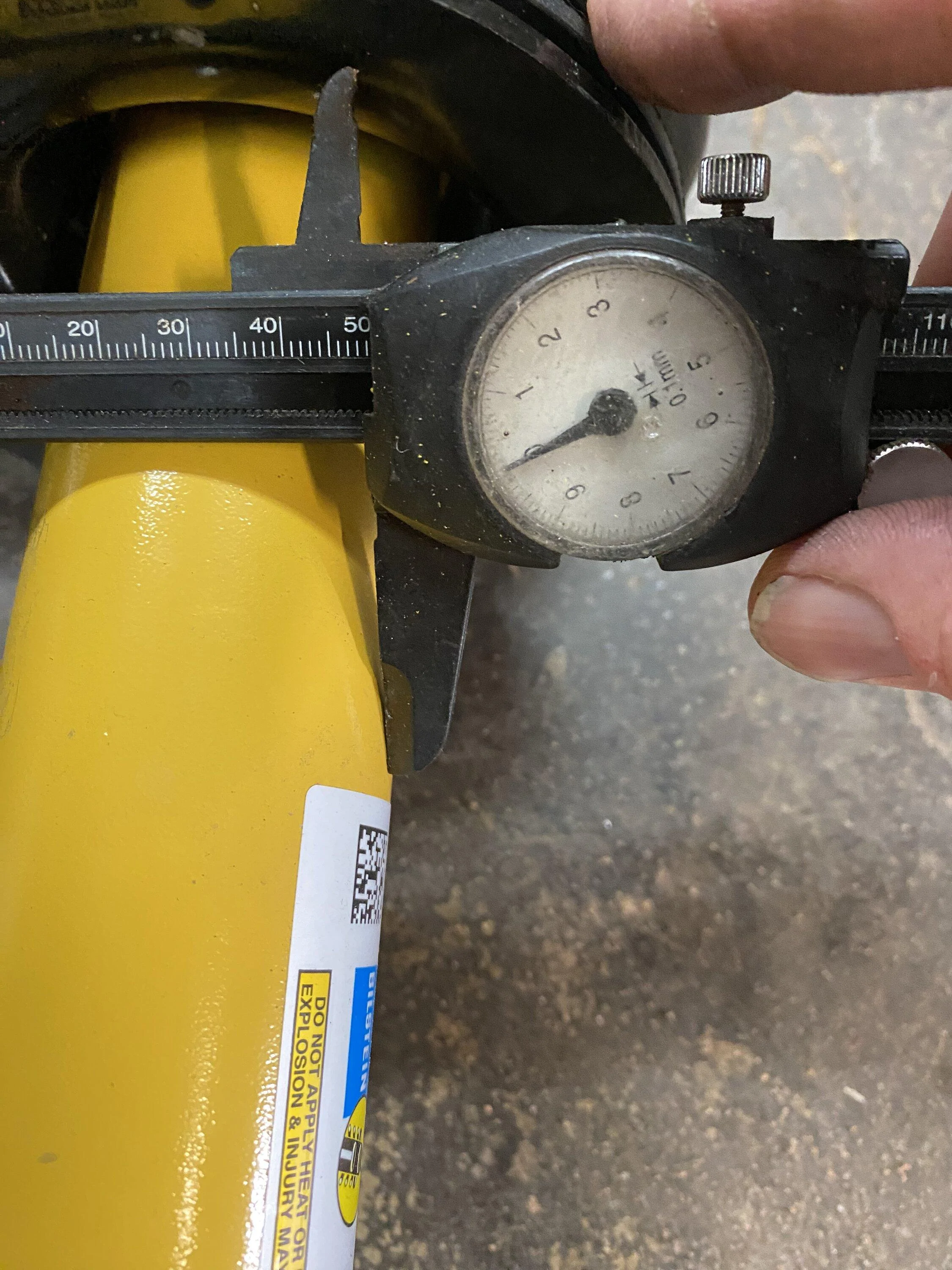

Honestly most will not notice a difference in spring rate between 2.3 and 2.7 shock/spring. From what I have read about a 100lb difference is all between the two motors.

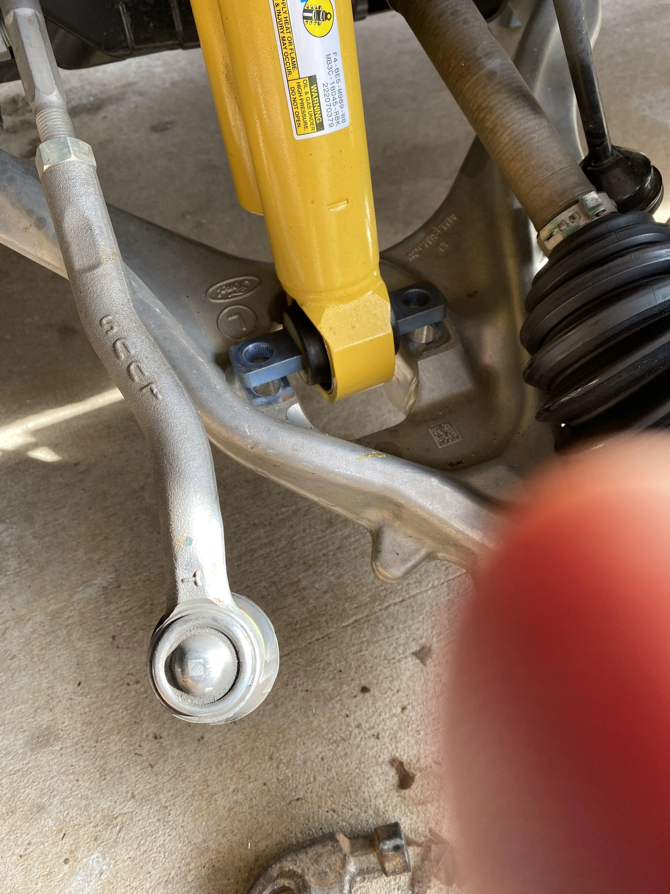

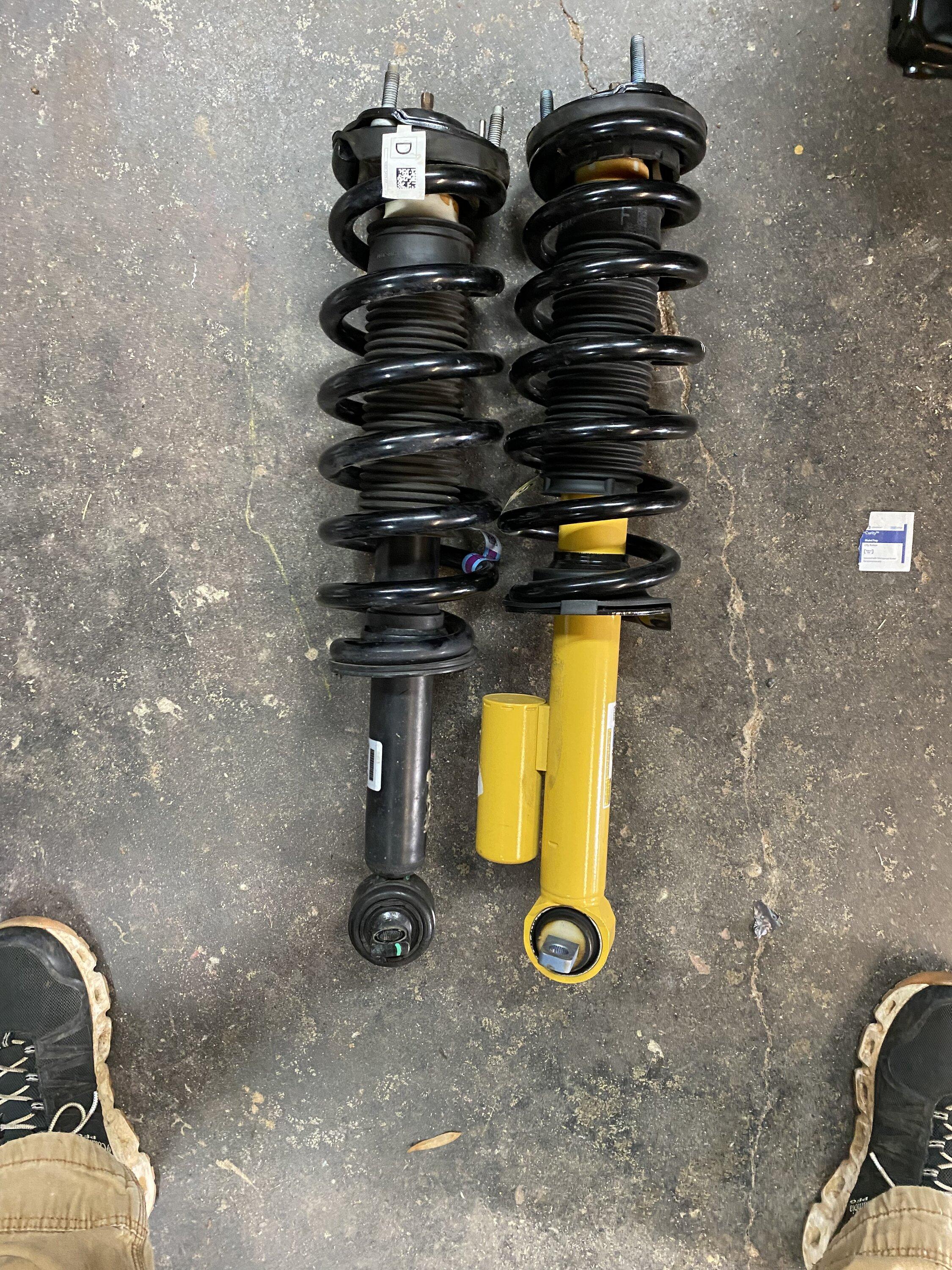

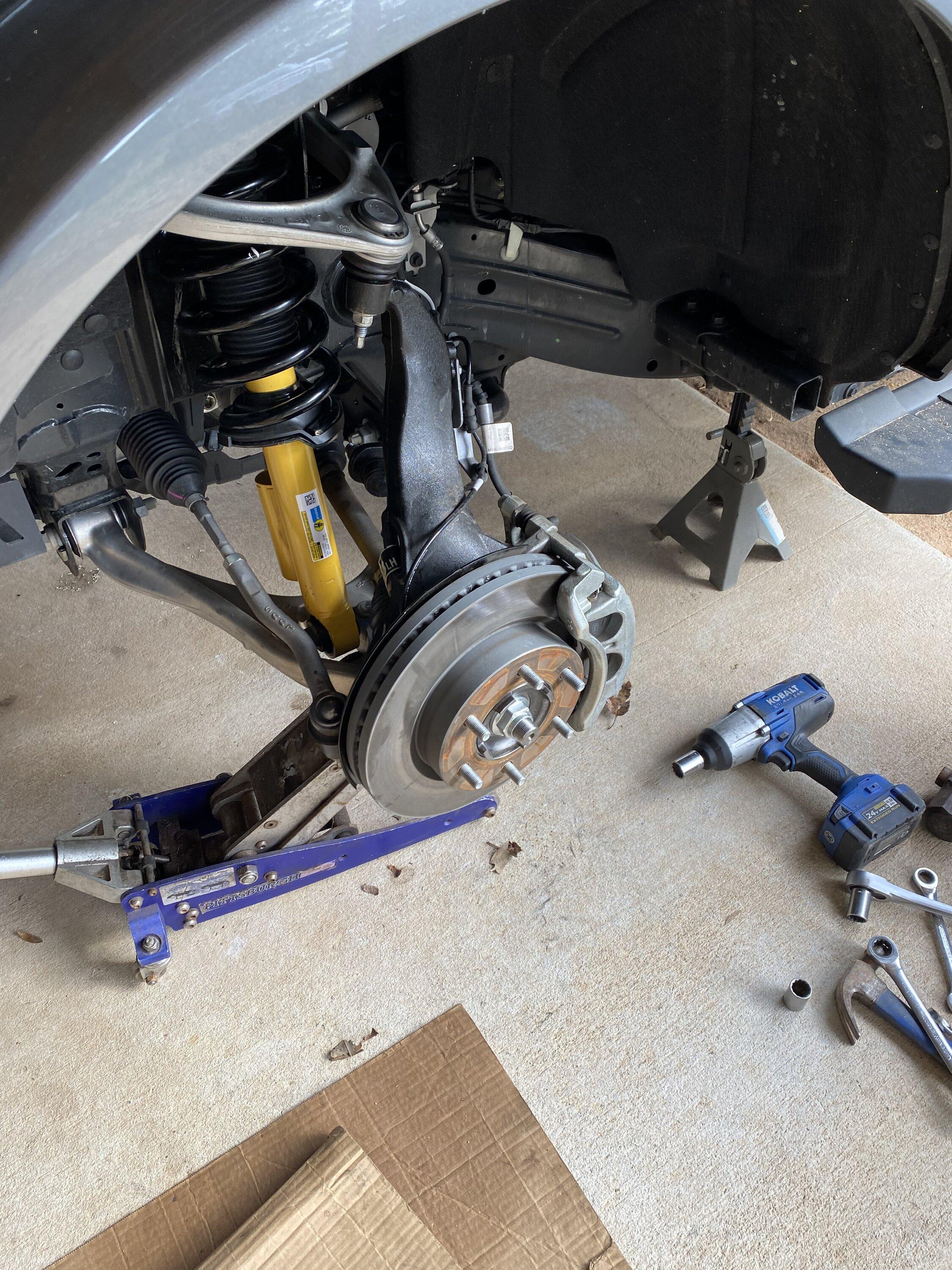

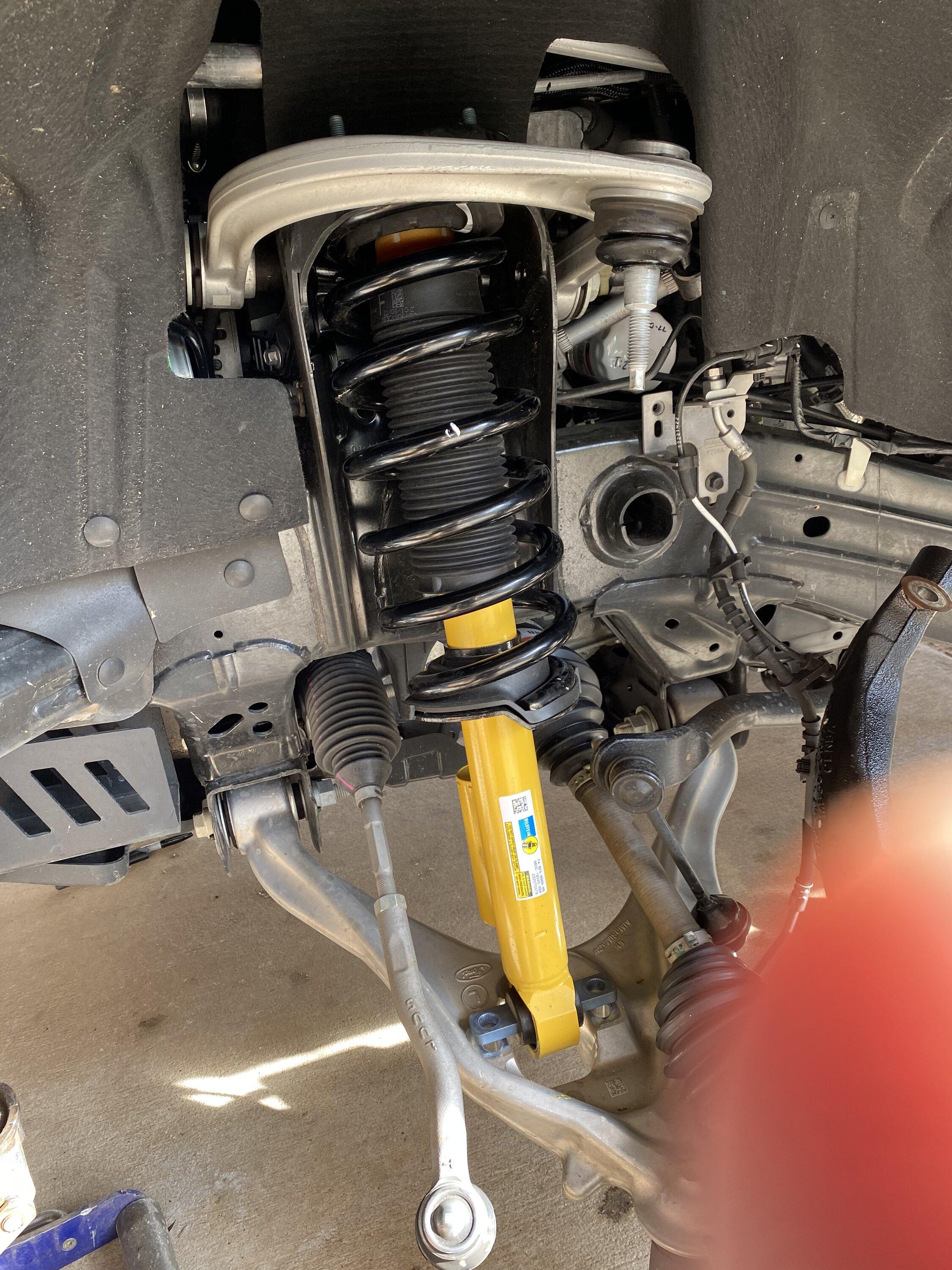

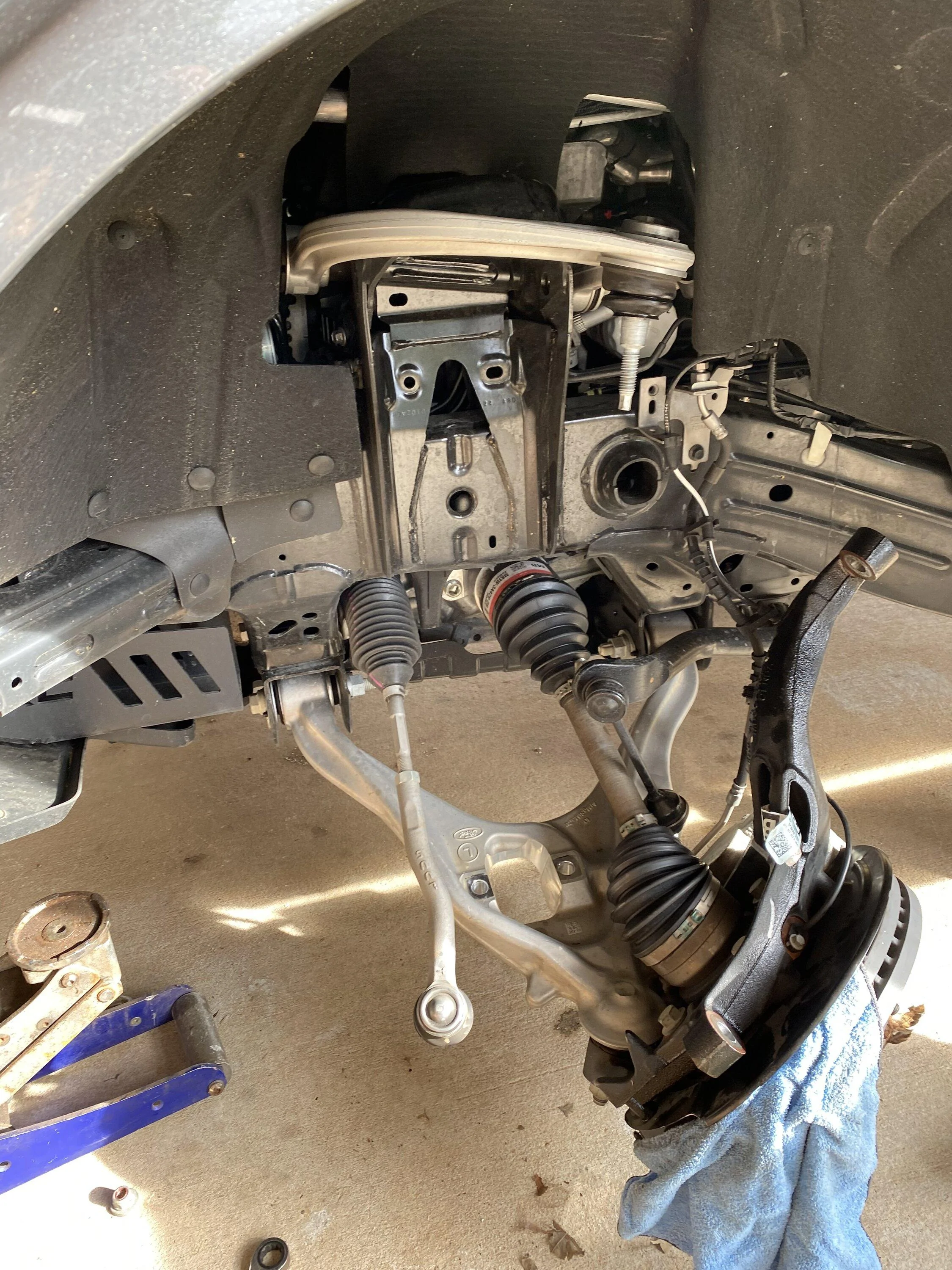

Just finished my 2.3 OBX Non SAS to 2.7 Badlands Squatch Suspension. About a 4 hour job in the driveway. Nice lift, perfect for my liking and I can tell spring rates are a little higher but still smooth. The Bilstein is a nice upgrade, lot less body roll. I didn’t drop the arm as I wanted to keep alignment close.

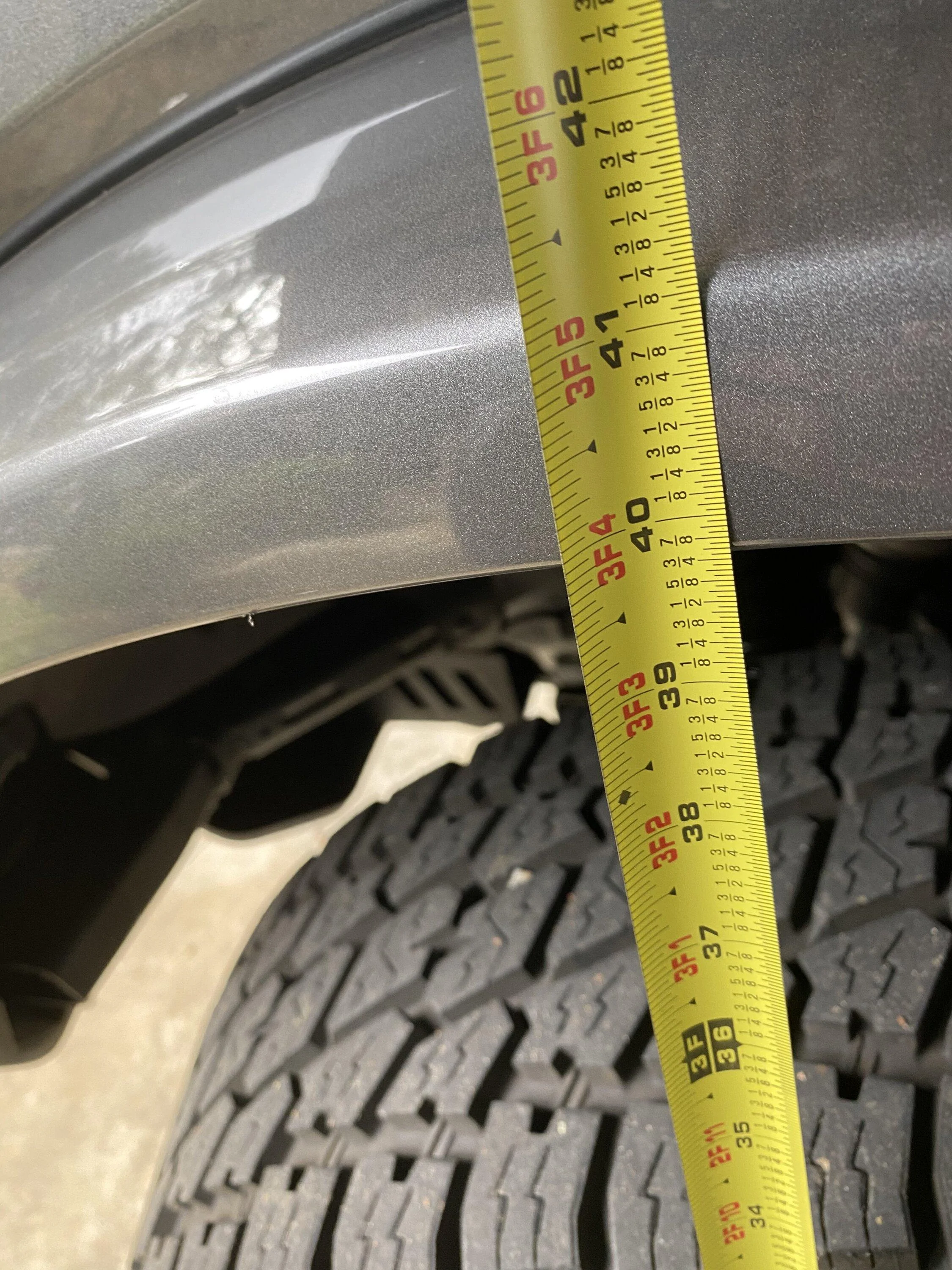

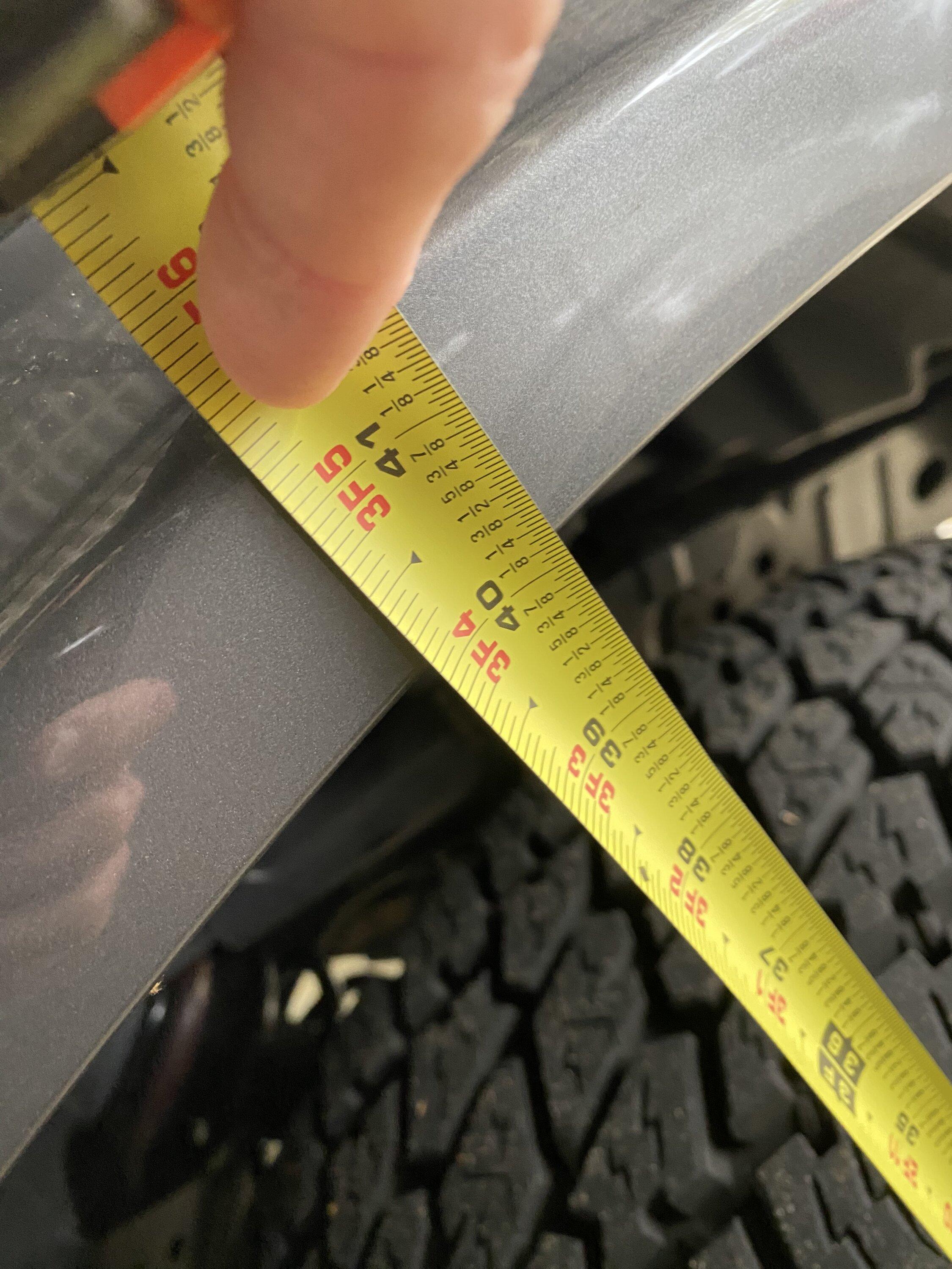

Wheel arch measurements after with 33” tires
