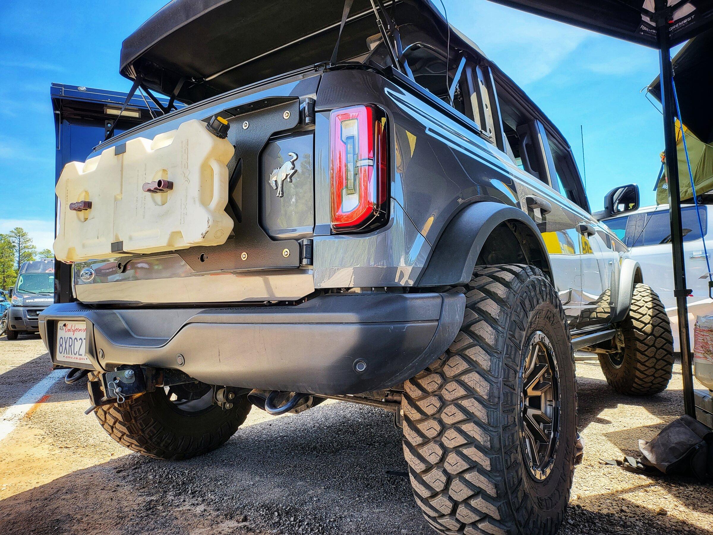

Any chance of making jerry can holder instead of rotopax? Or is that something that will require a hinge upgrade.
We will have that was well, A jerry can will require a door stop most likely so the jerry can doesn't get crushed by the tire and the fender at full swing.

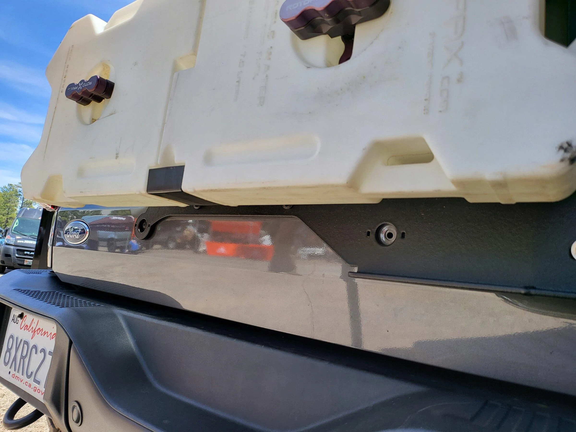

Do you have any pictures that shows the bracket installed before putting the spart on? Specifically, i'm trying to see what it looks like to the left of the spare tire holder. Do the bump stops get installed again? Thanks.

I'll get one for you. But the first post shows the render of what it looks like under the factory tire mount.
Yeah yes the bump stops have added support and 1" spacer for the 4.5" bs wheels most people's get.
Ford Bronco BAMF Tailgate reinforcement 20220519_124058
