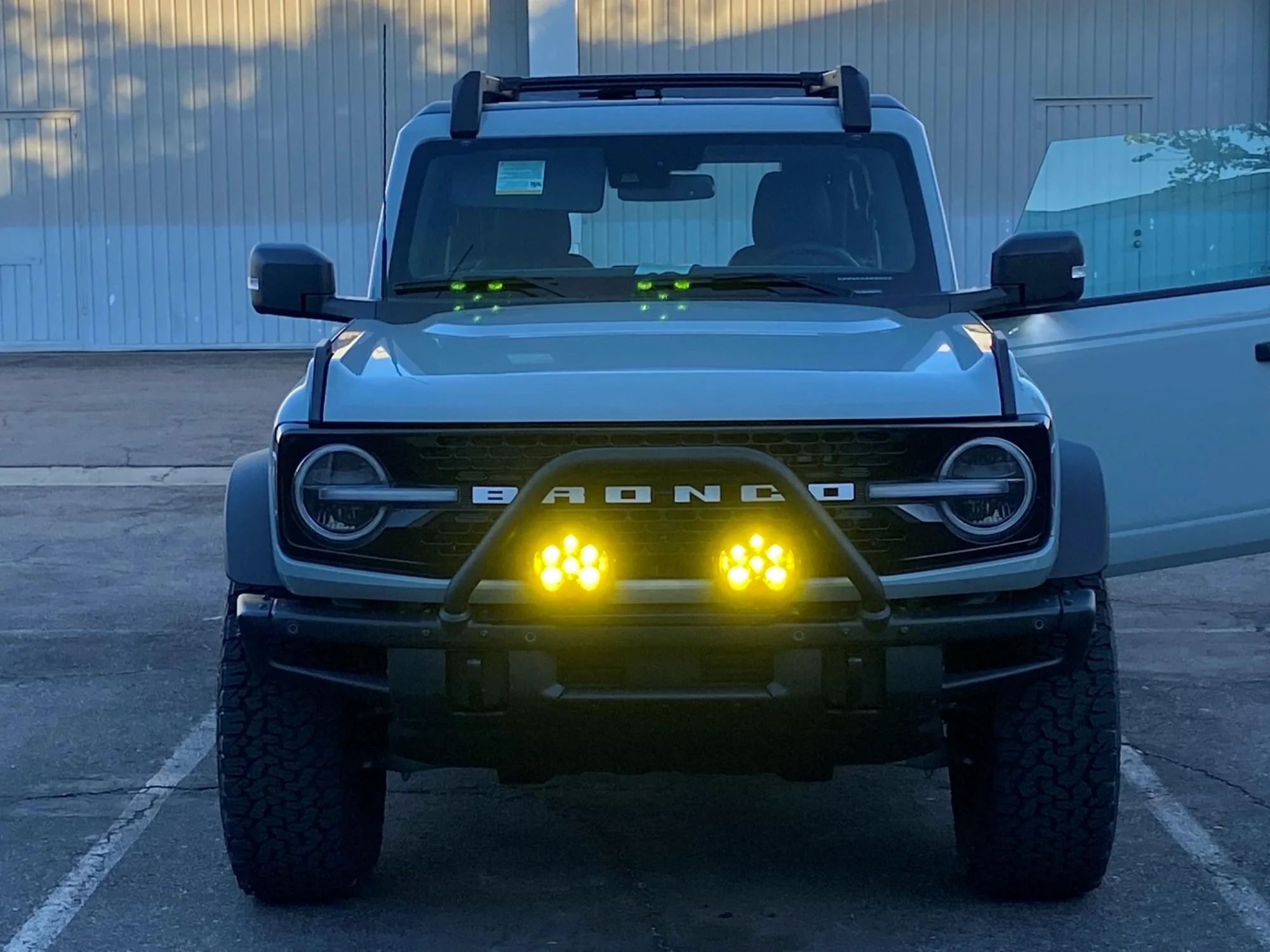

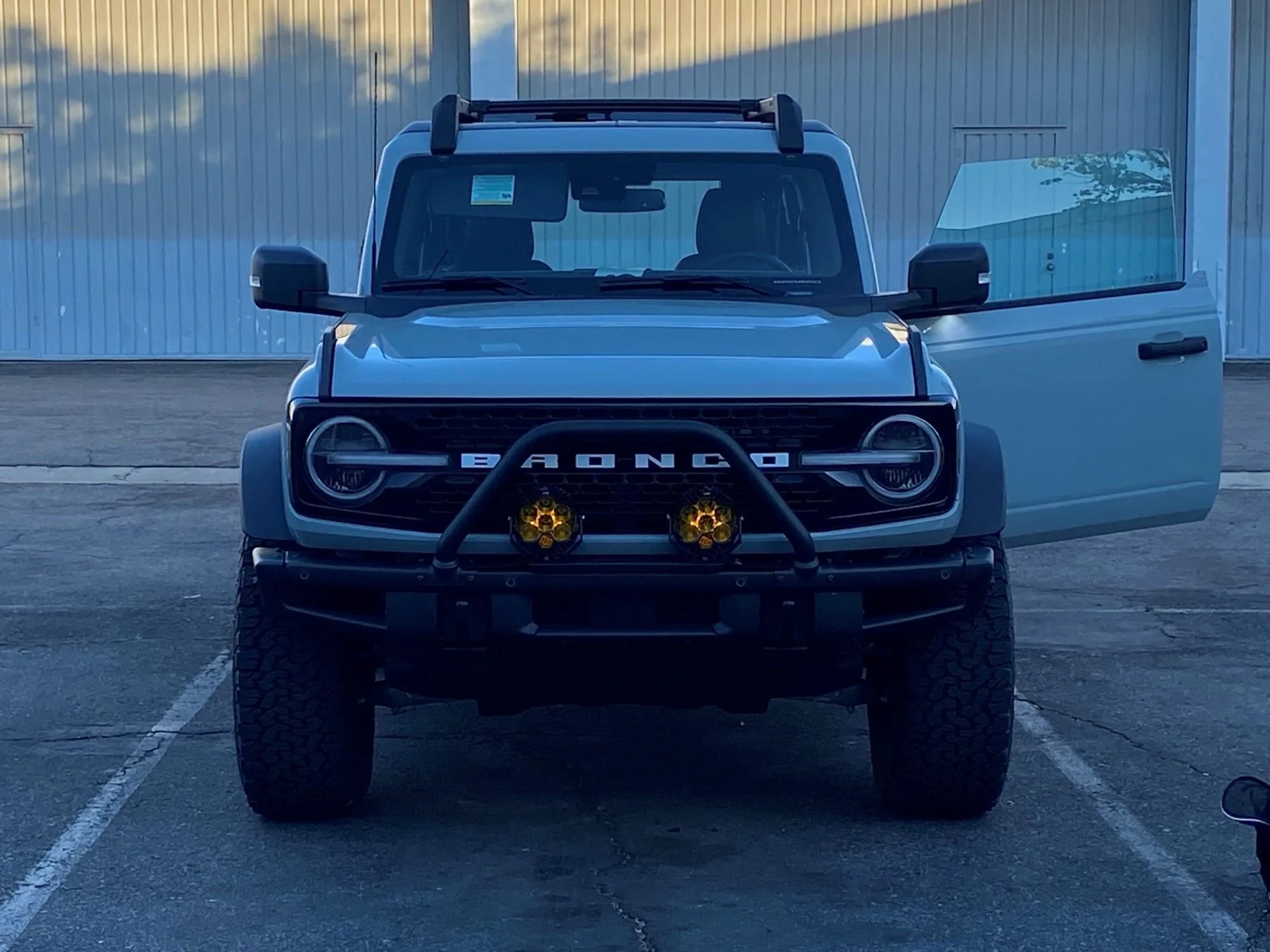

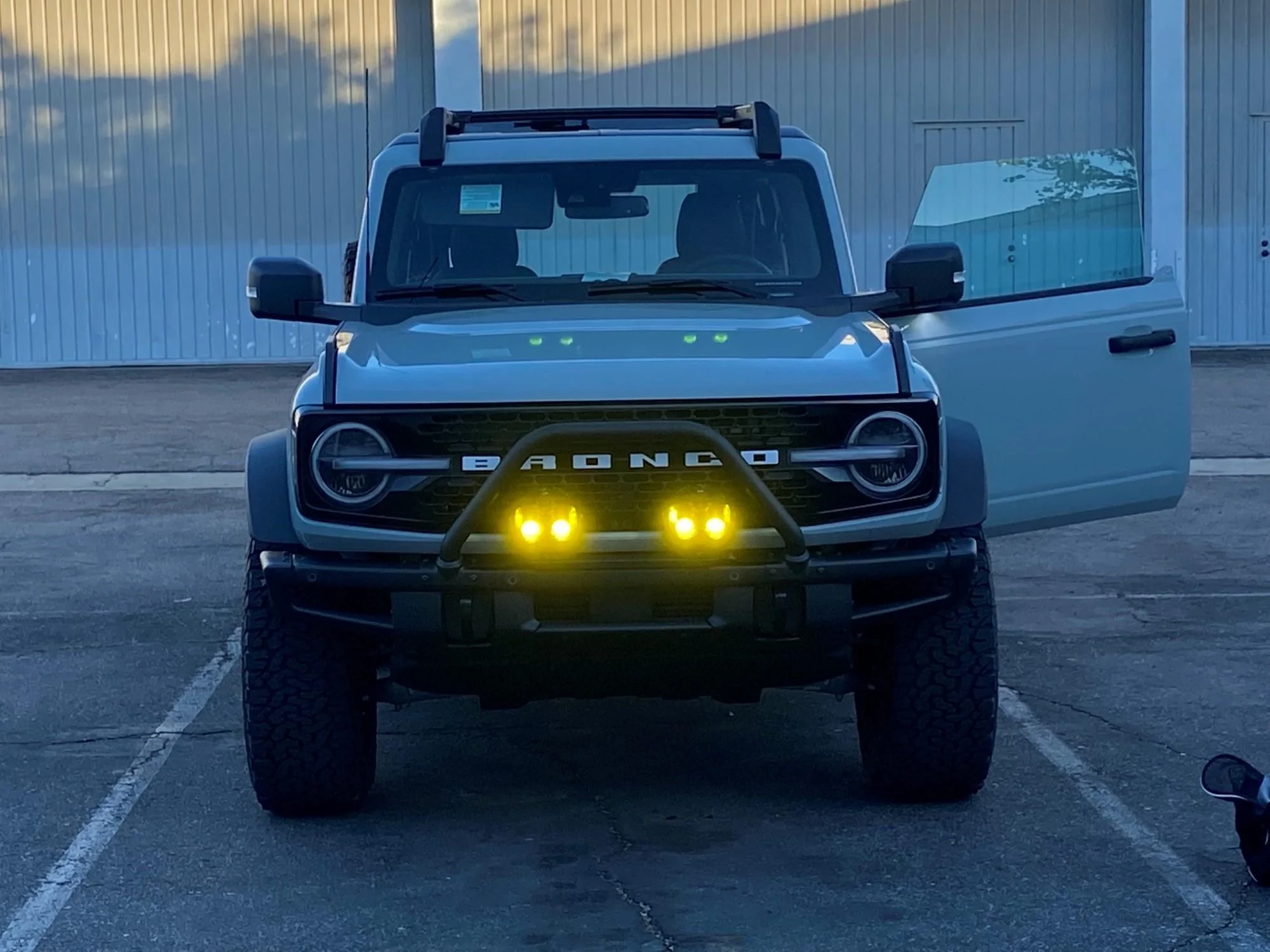

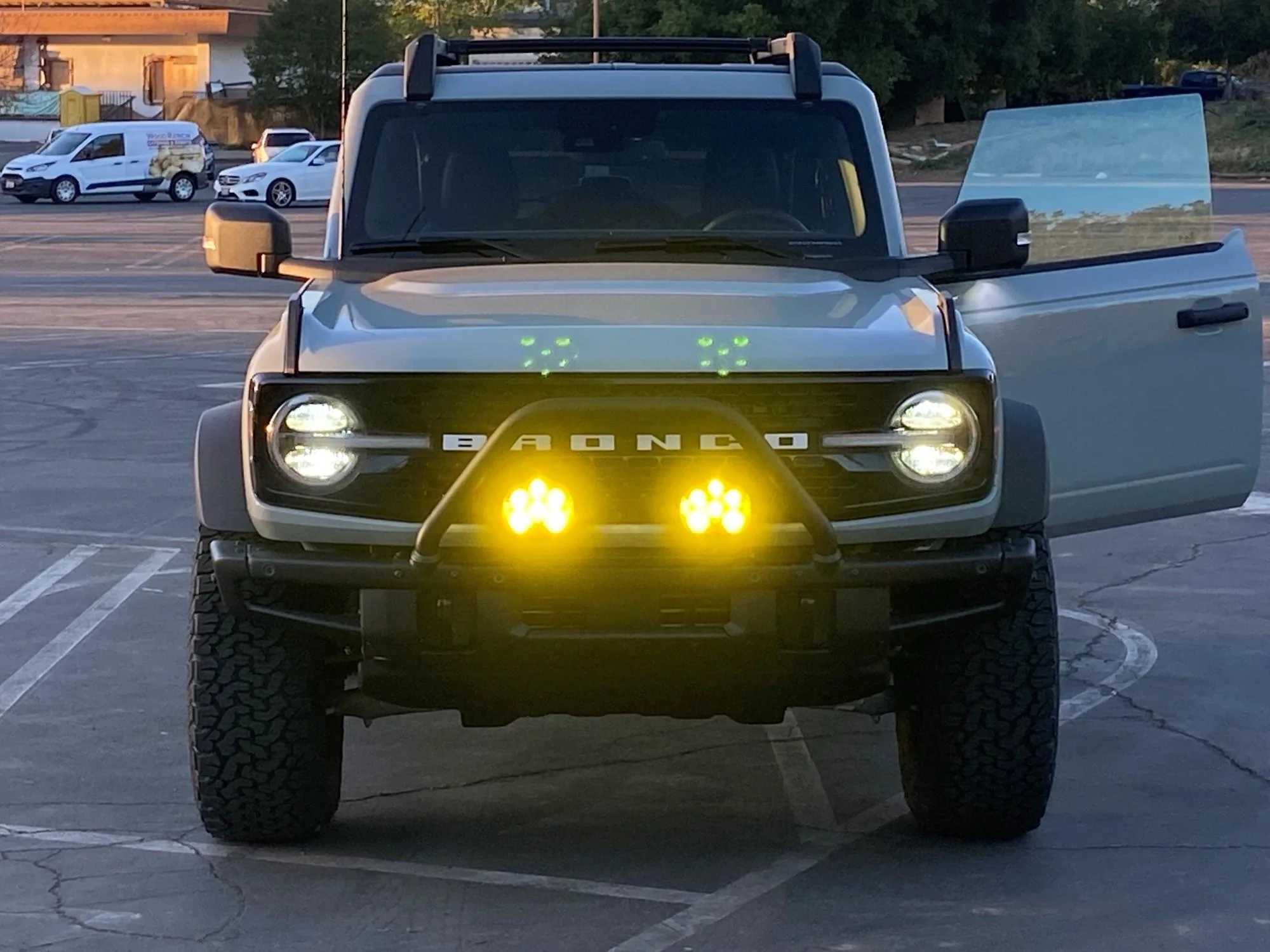

Got my two LP6s installed using the outer two mounting points on the Swarfworks bracket. Amber backlighting tied to DRLs, Aux 1 is low beam, Aux 2 is high beam.
can you show us how the camera looks with the lp6? does to covert to much visibility??
Can not decide between amber and white. What made you go with Amber for your LP6’s?

Two reasons: I like the contrasting color aesthetically, and the amber light improves viz in foggy or dusty conditions.
Do you care to grab some more images of the set up in different lighting conditions?

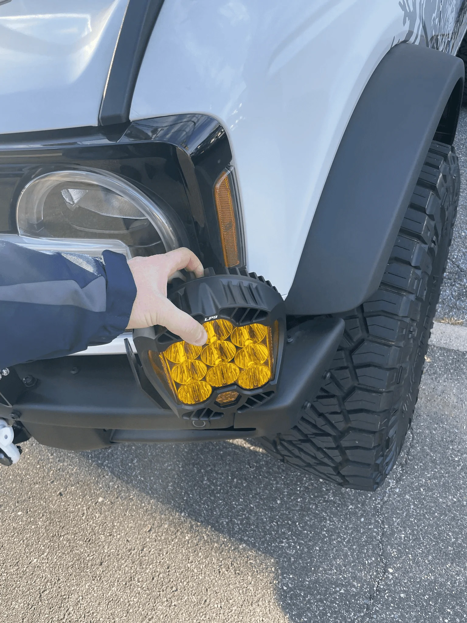

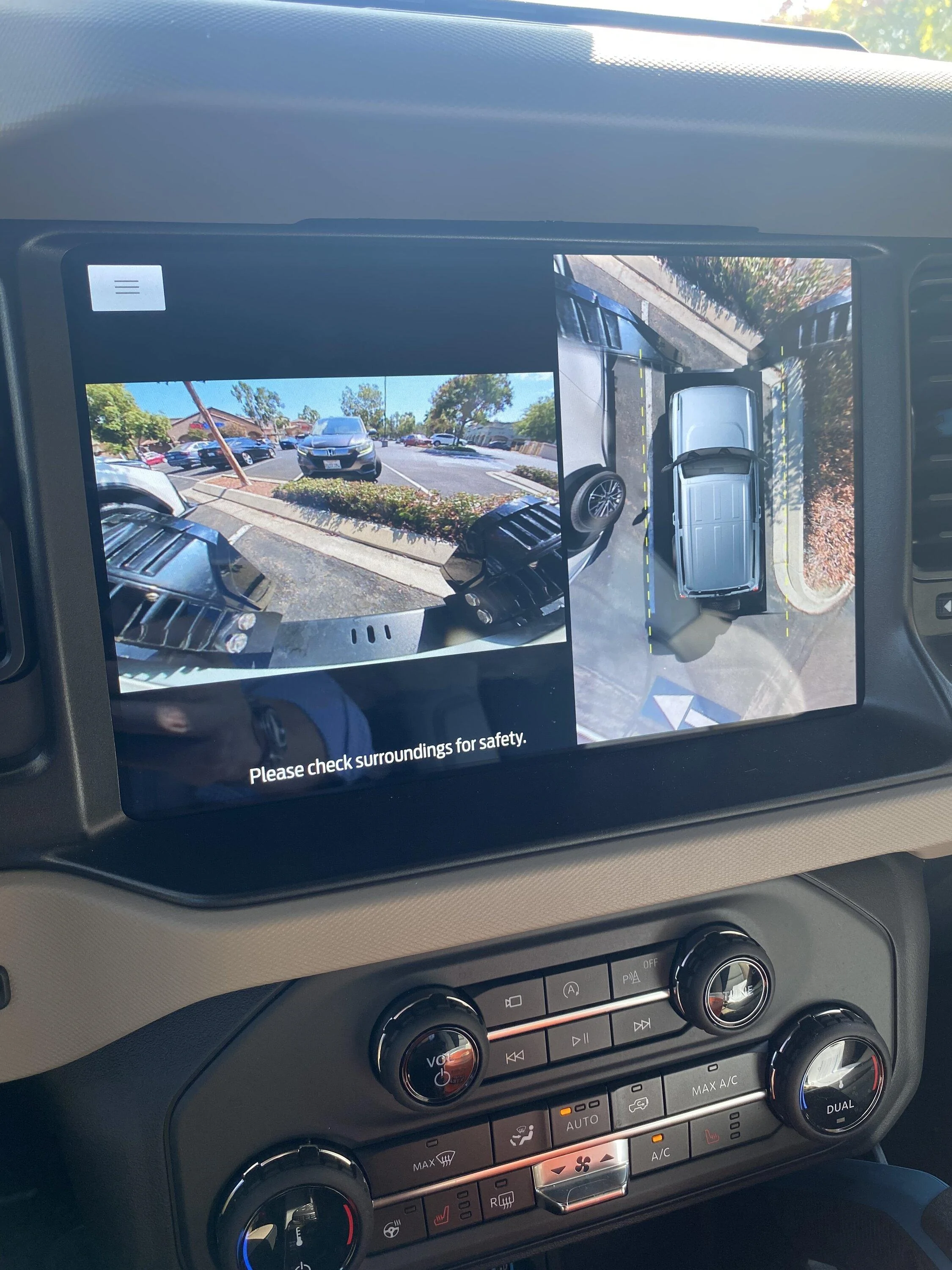

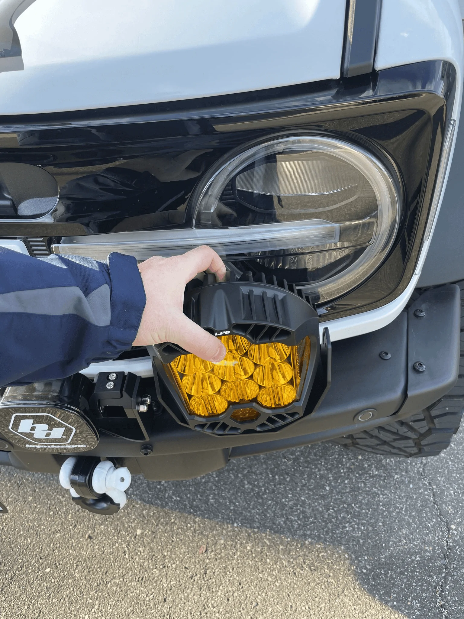

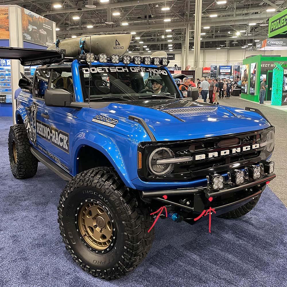

The bumper doesn’t have to be removed. Drilling was relatively simple. You can get them from the front underneath with a small wrench. The wiring harness plug goes right through the grill without modification. If you put a third light in it with block adaptive cruise control as well as the front camera. The Lp9 pro lights are very bright and provide plenty of light.
I can see it blocking the front camera, but isn’t the ACC module dead center in the lower part of the bumper? That’s where it sits on most Ford trucks.

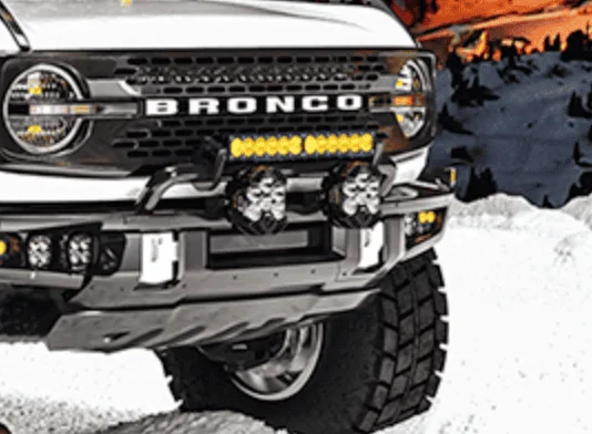

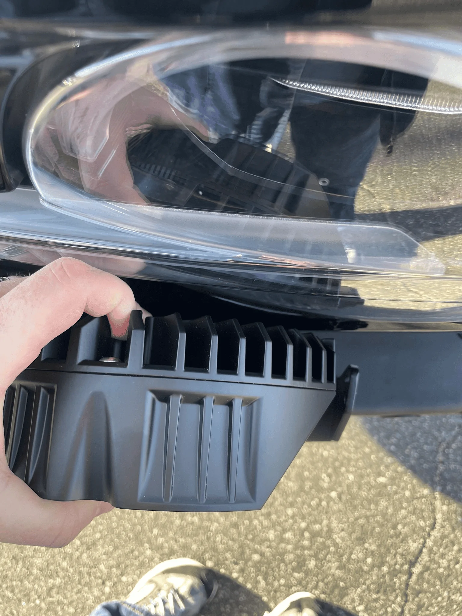

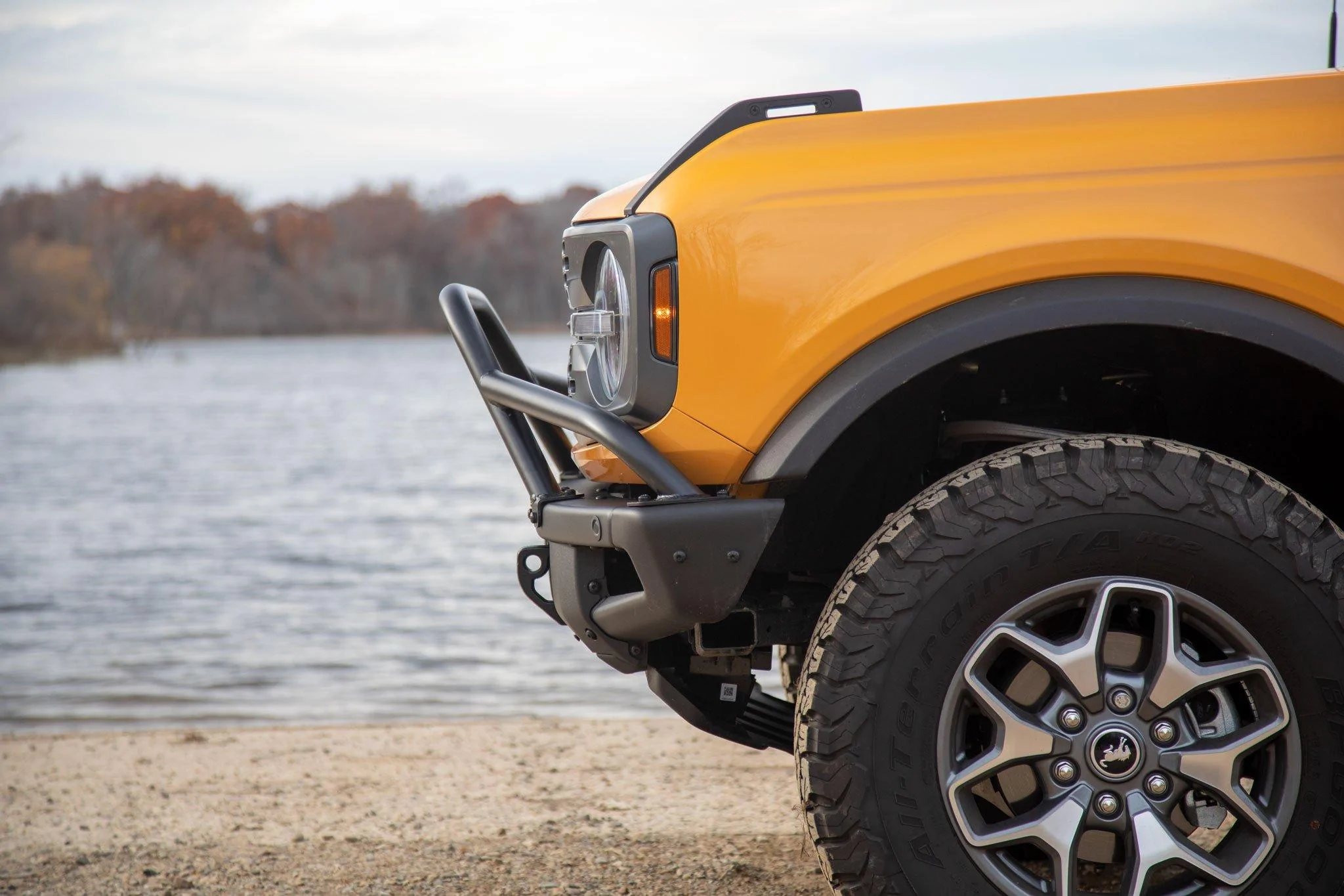

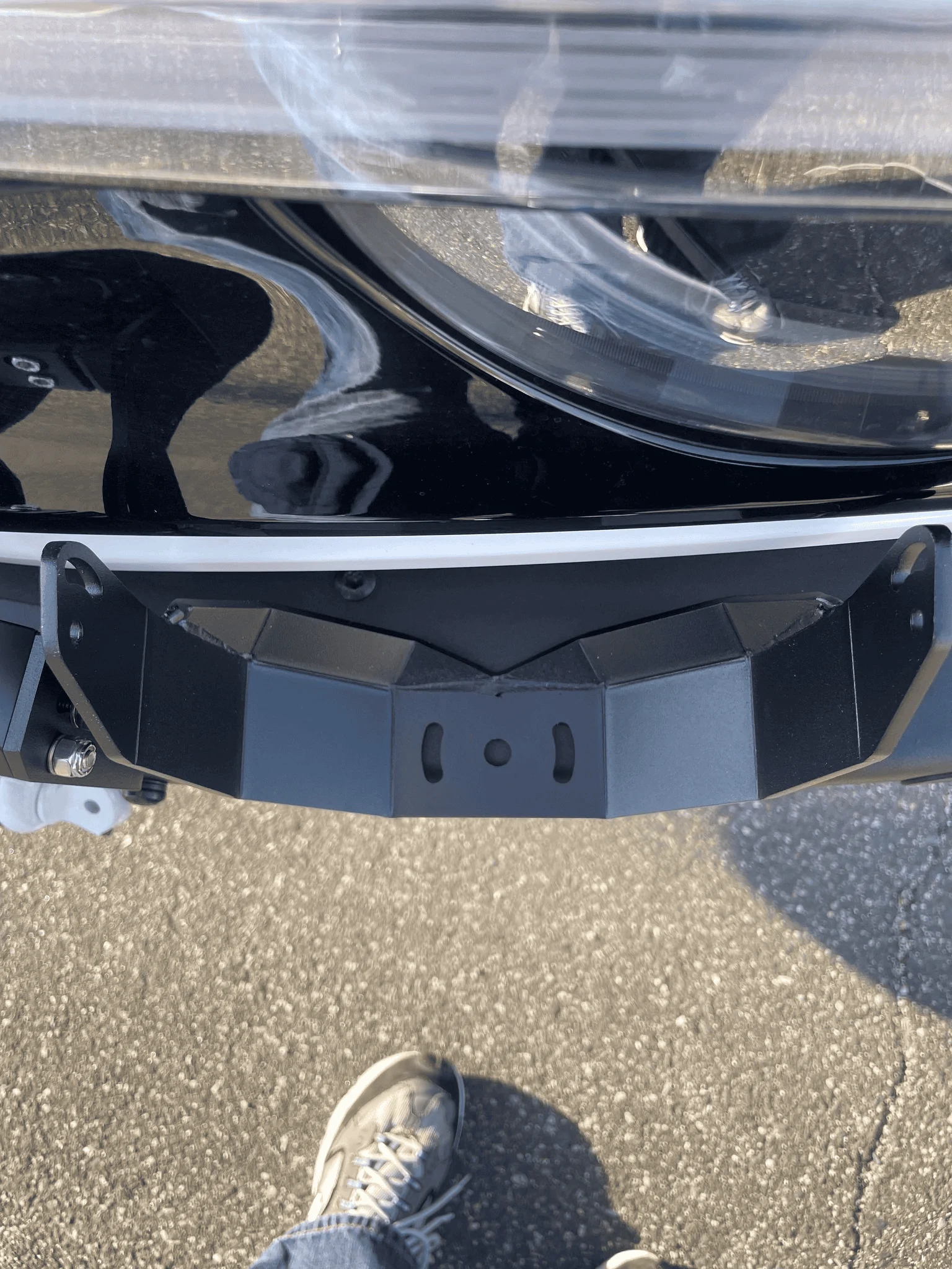

That looks like the LP series would bounce around a lot unless they are bolted TO the bumper. I only see a single mounting point on each side and a long piece of metal. That would flex in the middle and bounce around.

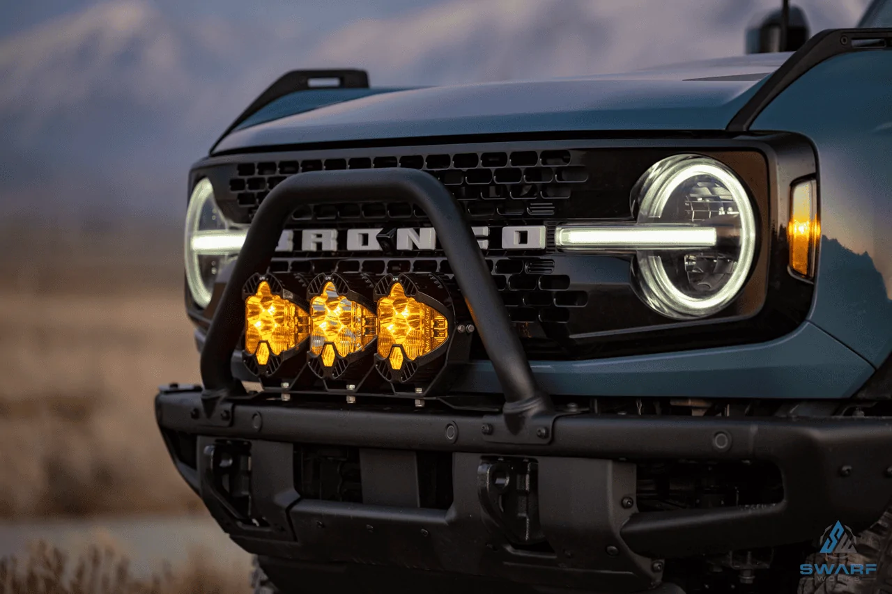

The SwarfWorks one has a bend in it so it bends upwards and allows clearance for the bolts. It also means it's not going to FLEX on you since it's bent upwards
https://www.4x4truckleds.com/swarfworks-triple-lp6-light-mount-for-2021-ford-bronco/
This is the kind of info I love hearing from a vendor! The first thing I thought about was weight of the lights, real off-road conditions, and flex. Adding bends/folds in metal adds tremendous rigidity.
The molle panels in my last truck bed were made by Valhalla Off Road. They folded the metal about 45 degrees on all sides of the panels. In my opinion they put every vendor to shame. A little extra attention to detail was a game changer!

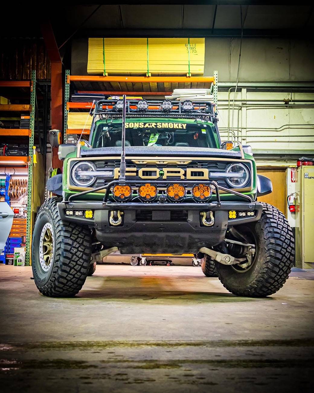

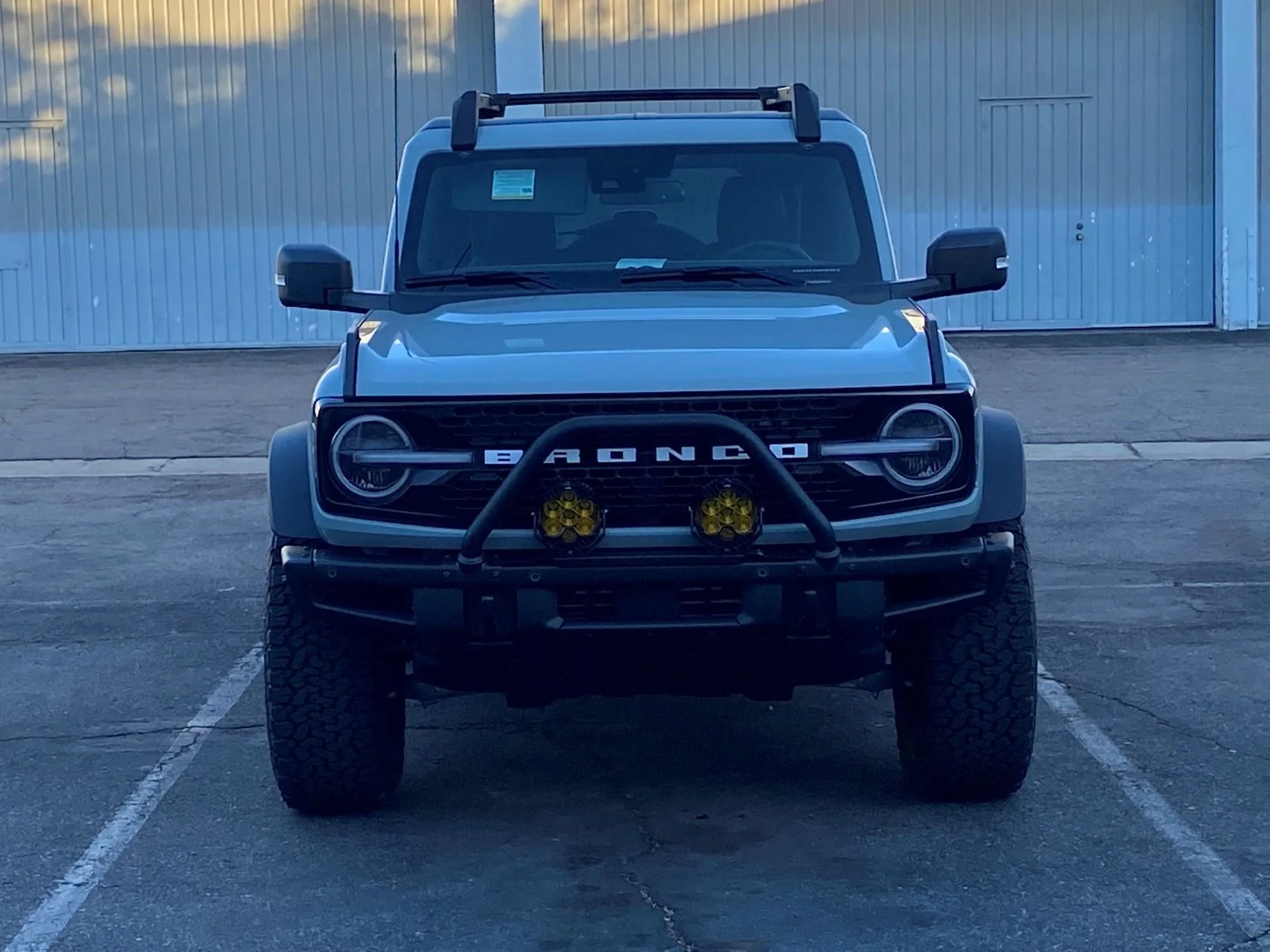

I run 4x LP6 on the bumper. Controlled via SwitchPros panel, with a total of four circuits being used (2 spots, center, as a pair, with one circuit as high, the other as low. 2 wide/cornering, same configuration as the spots)

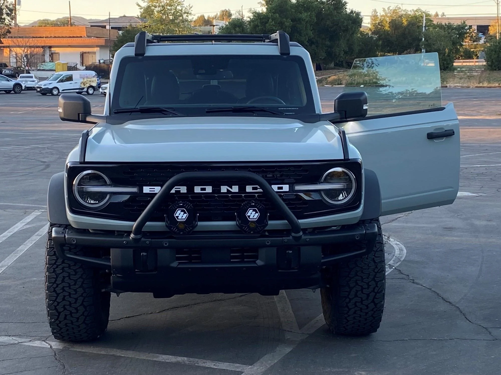

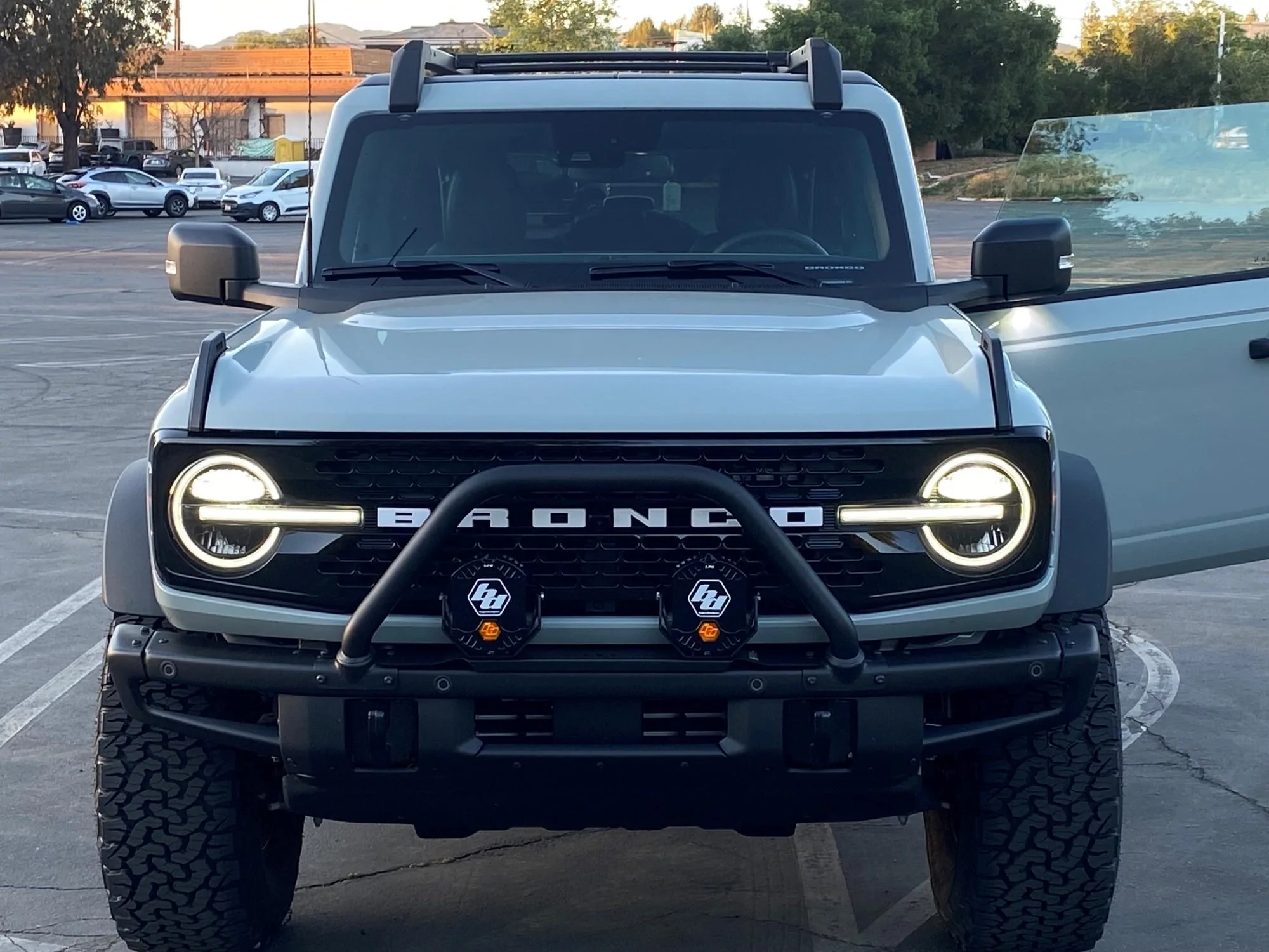

you could get LP9s on this mount but they would be partially obstructed by the top of the bar. That said, the fabricator who made this Nerf bar (i know it’s different from what Jeepers call a nerf bar but that’s its actual product name, so we don’t need to debate whether calling it a nerf bar is accurate or not) would undoubtedly make a variant of it for the LP9s if the buyer was willing to pay a bit extra. US made in Kansas by Allied OffRoad (@AlliedOffroad). Been on my truck for two years, regularly used in all kinds of conditions and has held up beautifully. I paid retail for mine, so not shilling for them, other than as a happy customer.
in the middle of my bar up against the bumper is the camera relo bracket, so I lose none of the baja forward visibility with this setup. I had one of the first of these bars and I think he’s improved the way the camera relo works in later releases
