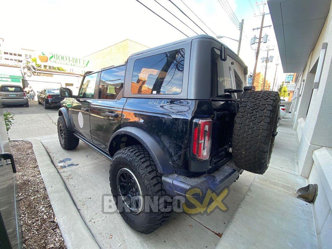

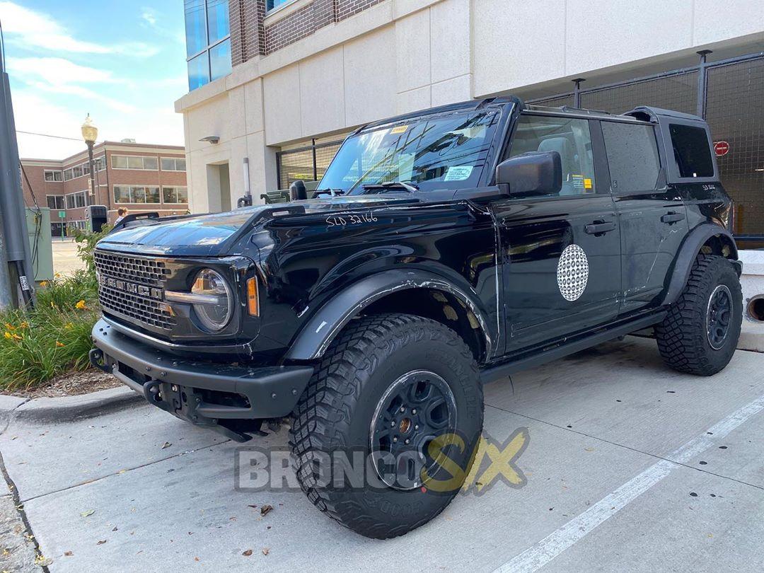

Yes !!!!!! ........... Mine too !!!!!!!
Is this a badlands with just 35’s added? I think it looks good even with the smaller flares, that’s my plan is to add 35’s on my badlands, will they fit without a lift? Anyone know the details on the sas wheels? Offsets and such.

Sasquatch wheels have +30 offset versus +55 on the non Sasquatch. Not sure about the wheel width difference, and don’t have time to find it. There is a lot of info on it if you can sift through the search though.

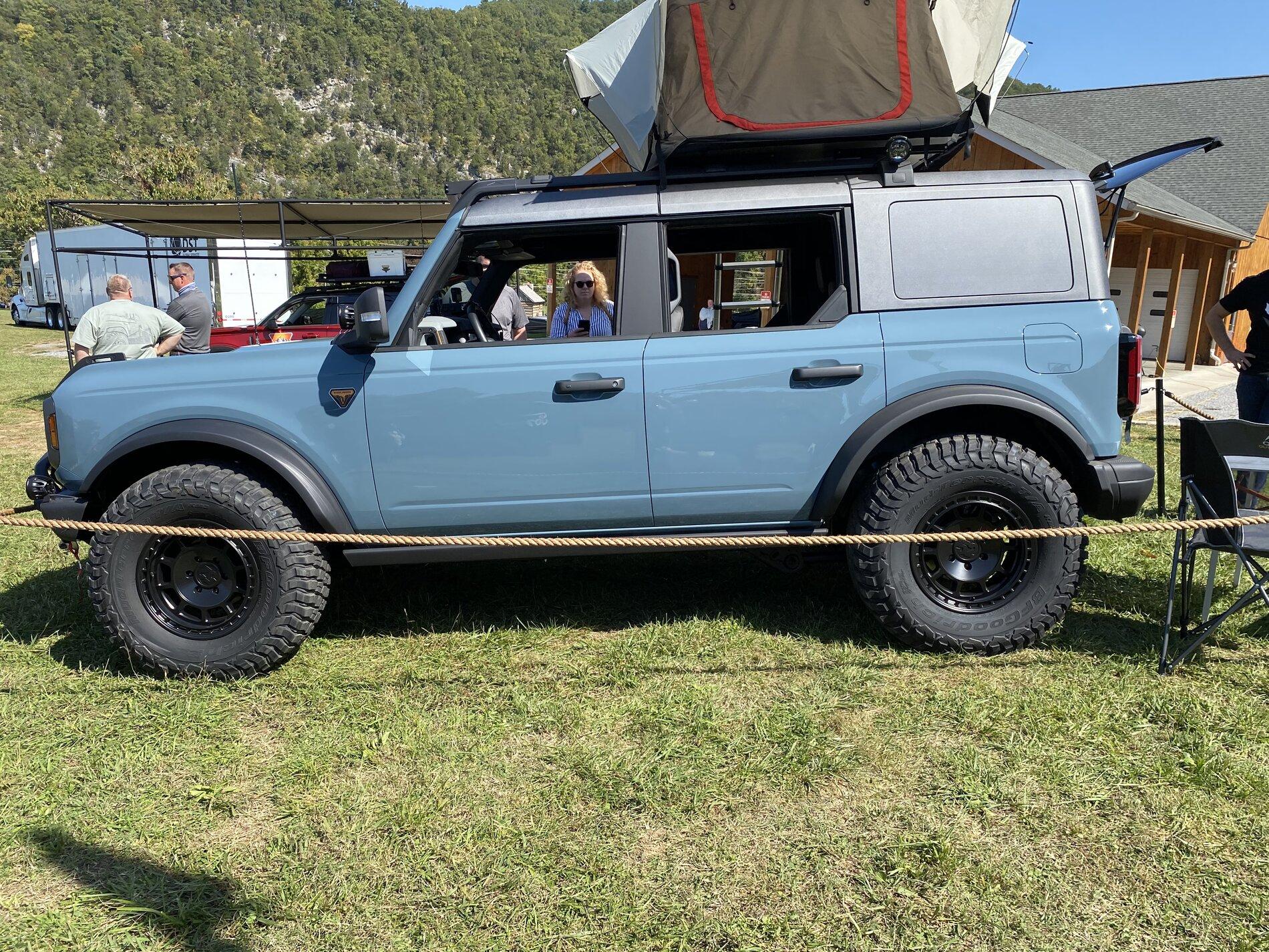

Well, Ford was the first to do this. And here it is, the Overland concept revealed last October. I was there and spoke to the driver and he said it’s fine most of the time but rubs slightly at full turn and probably off road ing at full flex. You can also see how the tires look stuffed in there as it needs bit more lift.
Ford straight out said this was a non squatch badlands with 35s added, except they did add sqautch flares.
There was that A51 overlanding/camping model that they just threw 35s on standard BL suspension and it looked like it had no room in the wheel well and would probably rub
Everyone should be careful with the overland assumptions. That demonstrator was slapped together with the parts they had lying around.
What the Ford people said was that it wasn’t Squatched and that they intended to put a lift in it but ran out of time... they didn’t elaborate whether that meant squatch, some 2” thing, or even just the BL a suspension. I’m not confident it was a BL in anything more than name only.
Besides, how much weight is in and on that thing? That might be why those tires looked so stuffed.
Basically I point to that vehicles as an example of what 315s look on 0 offset wheels... we got reports they rubbed, but we don’t actually know what else is going on under there.
The 35” tires are wider (315) and you need +30 offset wheels for them to clear the upper control arm. BL comes with +55 (closer to the center of the vehicle).
First step of swapping tires is new wheels. I know the first half of this post almost sounds like I’m suggesting 35s will fit no prob on a BL, but what I’m trying to say is, we just don’t know yet what happens when you put 35s on a BL.

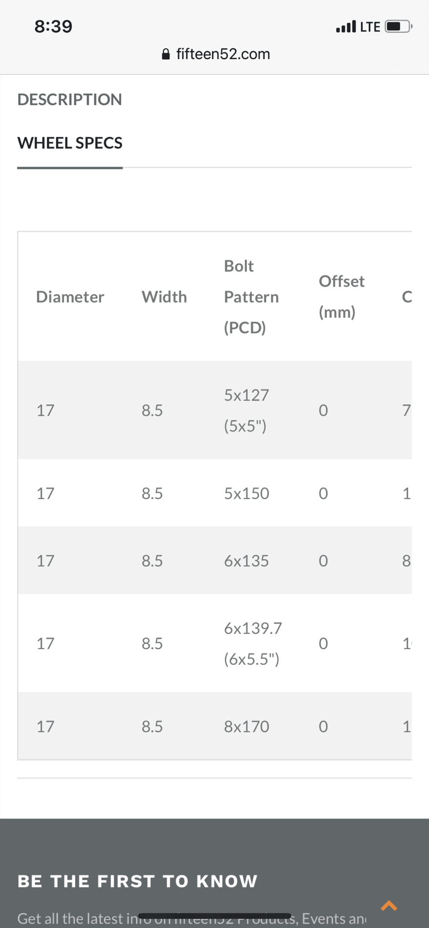

I was planning on getting the fifteen52 traverse but they say on there site is zero offset, your saying they may not fit? I attached a pic. I also emailed fifteen52 and they told me the 139.7 is the best fit
