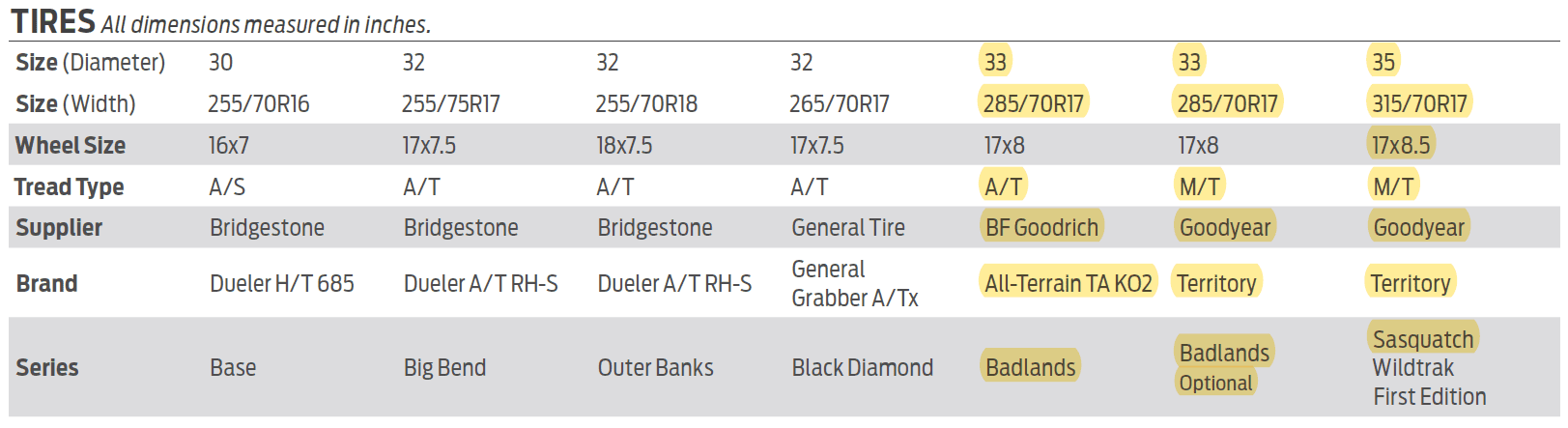

Tire question - Maybe it’s just the Build module on the site isn’t quite accurate. If I compare the Mud-Terrain to the All-Terrain tires, the Mud Terrains look bigger and better.
It looks like they’re the same specs, just different tread? Can I use Mud Terrains for a daily driver?
The Badlands 33" are KO2's, the Optional 33" and Sasquatch 35" are Goodyear Territory's. Goodyear calls them Max Traction = MT, they are more of a hybrid XT, halfway between AT's and real MT's. Sure you can use them for a DD but remember larger heavier tires will not have as good a ride quality as 33" AT's. It's all what you want, what your use to and what your willing to put up with.
