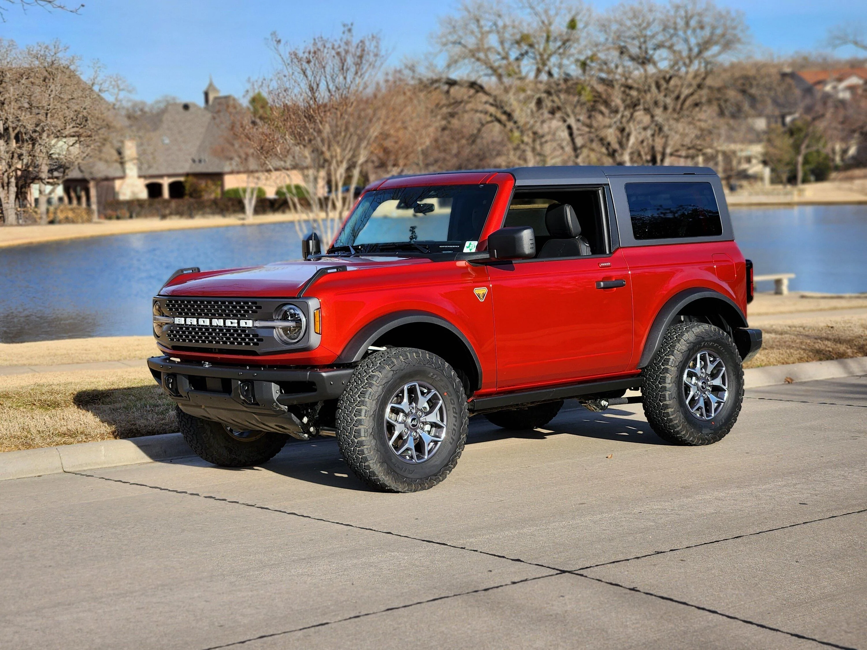

There also have been a few pictures posted on the forum of non SAS BL's that made changed my mind too. Turns out I REALLY like the overall stance of the 2-door regular BL. @3G & 6G posted the picture below and that was a game changer for me:
Ford Bronco Badlands SAS or Non-SAS ? 3D45EC57-E426-4F1E-9354-0C06C60A1F60

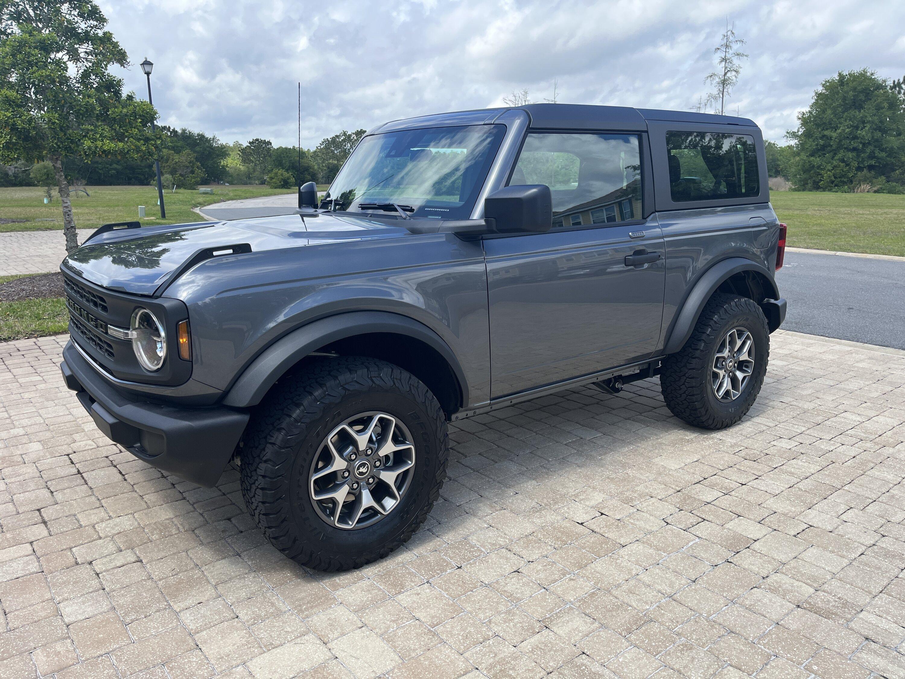

I just put the non-sas Badlands tires and wheels on my base today thanks to a B6G member. Perfect for my needs.

I did an off road event that was set up by Ford for Bronco order holders. This was a year or so before mine was built. This wasn't Off Rodeo, it was a shorter duration, but we still got to do some semi-serious wheeling. The Ford rep that was in the Bronco with me said he couldn't officially confirm nor deny (-cough, cough-) that the only difference in height between a BL 'squatch and BL non-'squatch was caused by the slightly taller tire on the 'squatch. When you do the math on the tires it checks out, too.
In the end, the extra money for just tires and flares didn't make sense to me. My BL non-'squatch has gone everywhere the group I wheel with has gone. It is still way more capable than my bravery level at this point. And - lots of folks here have put on 35's with non-'squatch BL's without clearance issues. I will likely do the same after the BFGs wear out.
@Dover - after our exchange of pics I figured it was this one that sold you. It's one of my favorites... :)
Ford Bronco Badlands SAS or Non-SAS ? 20230110_172028

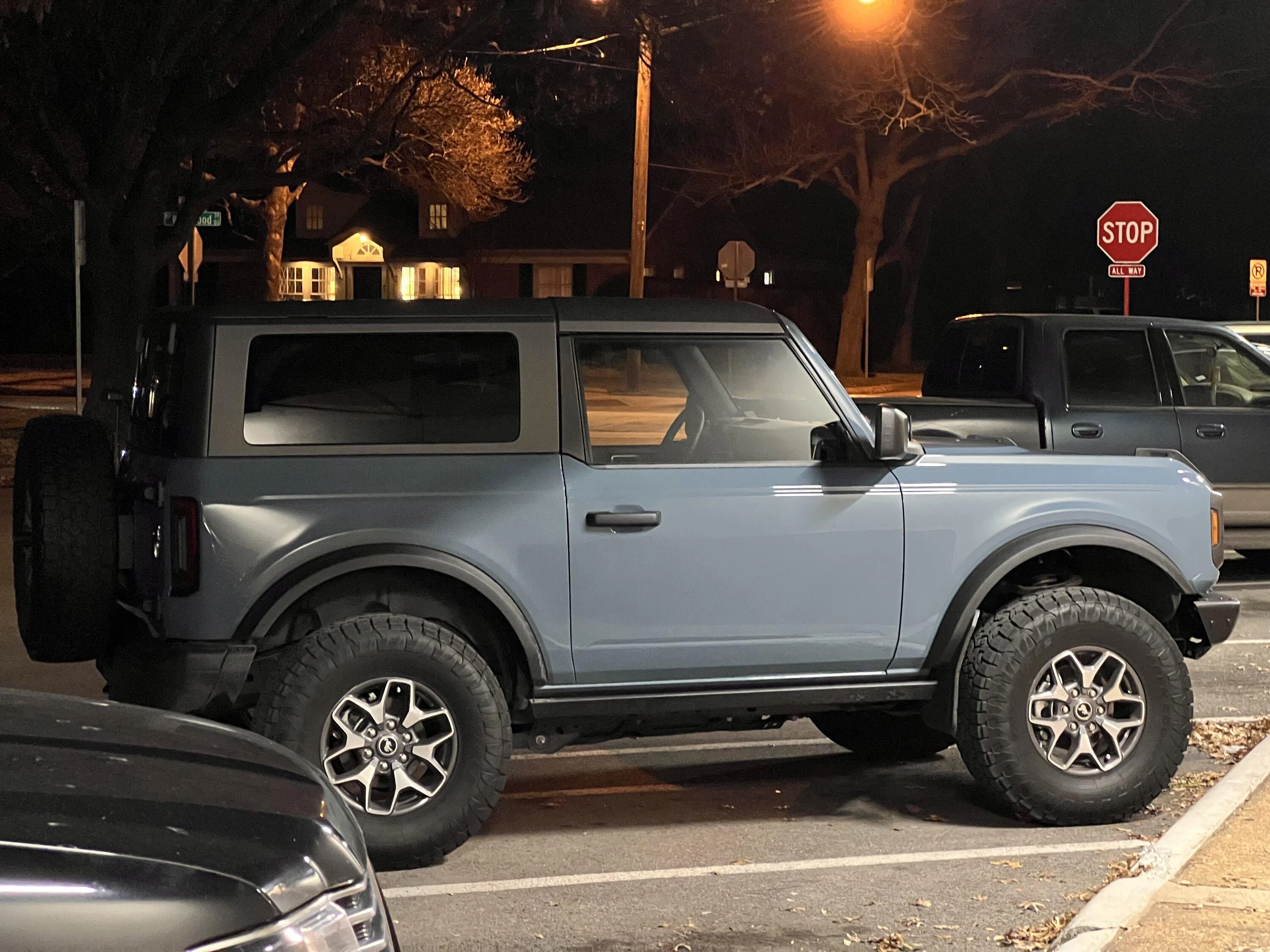

Ford Bronco Badlands SAS or Non-SAS ? A8748E0F-CE3A-44D4-87C5-06BB409CBD04
Badlands 7MT with eibach coilovers set at about 2' lift in front with 35x11.5 Toyo at3 on stock wheels at 32psi. The ride is now pillowy soft yet there is no more body roll than stock setup.
Had installed a zone 2.5" lift that destroyed the ride quality of the bilsteins. Do not recommend.
Swaybar disconnect is my most used offroad feature besides 4L. Bumpy medium speed trails are comfortable.
