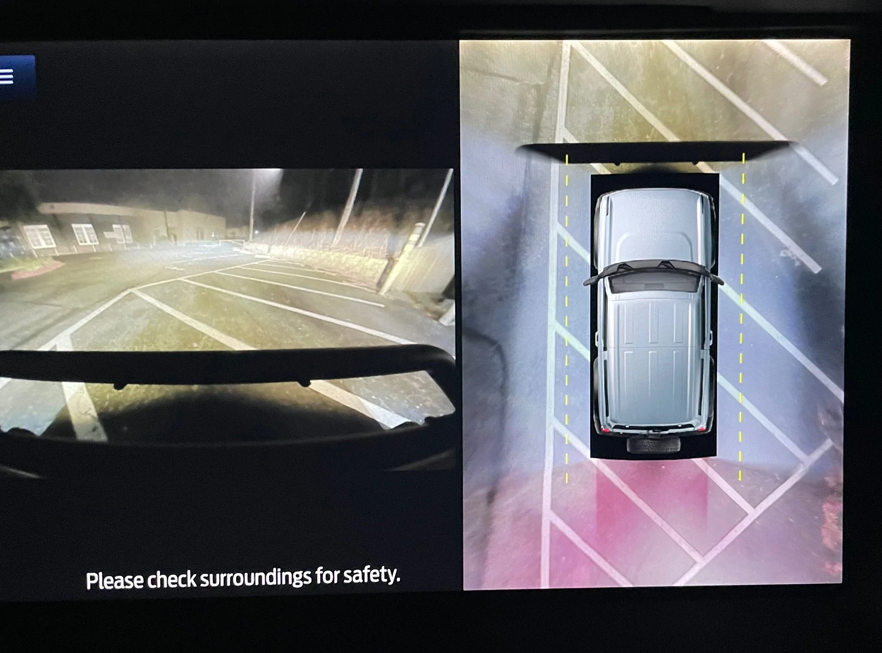

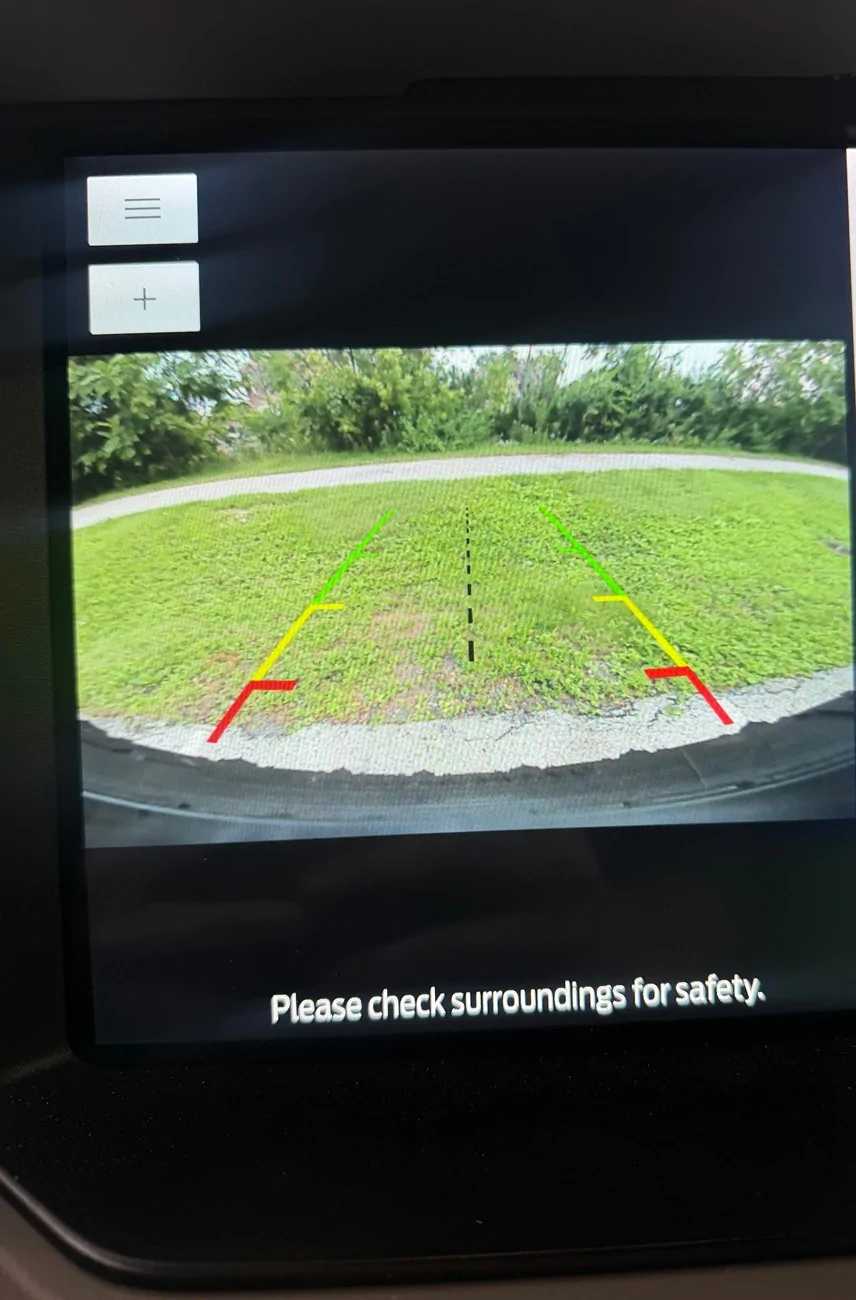

Like a good Bronco owner, and against my better judgement, I had my backup camera replaced in my 2022 Bronco a few months back. Ever since the dealer replaced it, all I see in my screen now when I go into reverse is half of my spare tire and half road. I am lifted with 35" tires and a 0 offset. Never had this issue before the replacement. I have been going back and forth with the dealer who insists this is normal and how the view was before. Not the case. I also had to argue with them about calibrating the camera to align the dotted lines to not be disjointed. After 3 visits to the dealership, looks like that may finally be fixed.
To me, it seems like the camera is angled down more than my original camera. My husband has made the same comment about the one that was put in as the replacement for his F-250 recall.
Has anyone else had an issue similar to this and if so, how did you remedy it?

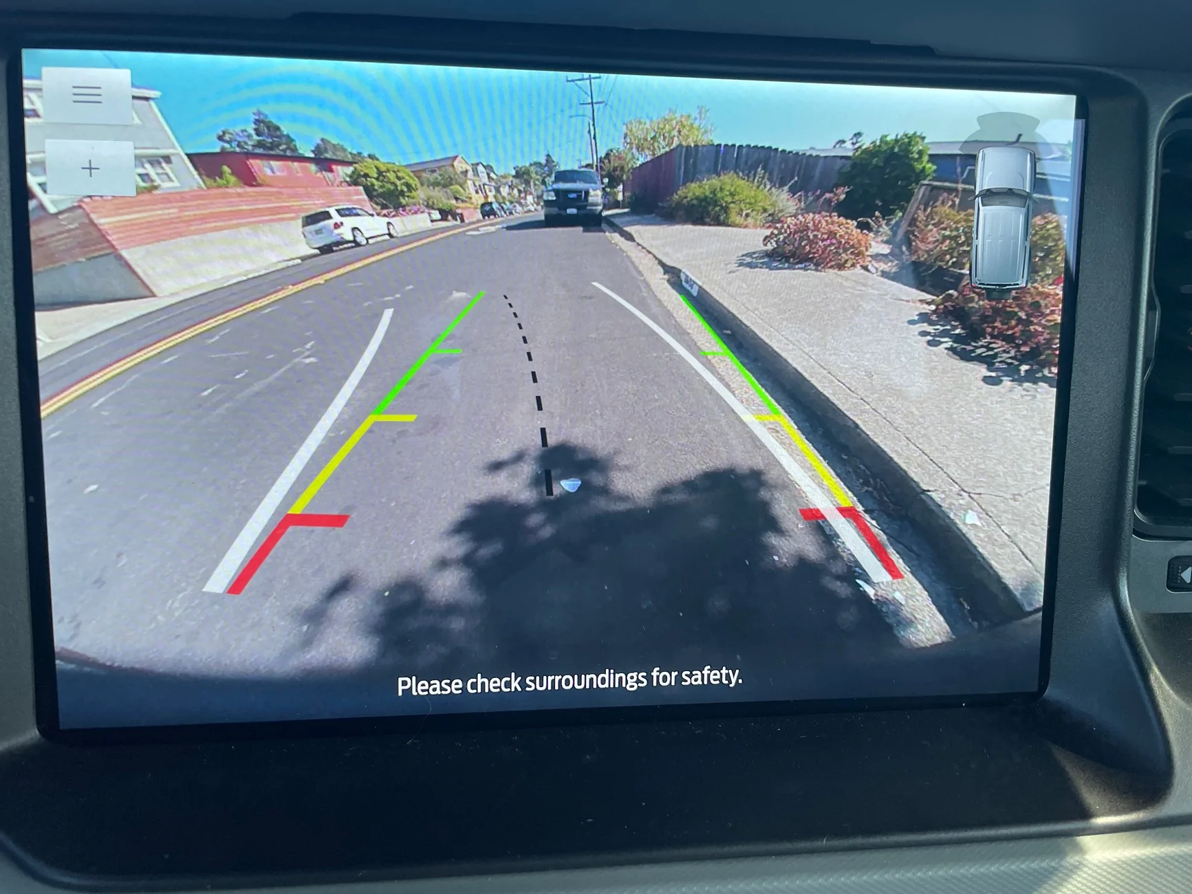

I saw your post while I was waiting for my Bronco to have the camera recall done. Mine is a 2023 Badlands with the 33” tires and stock suspension. On the drive home, I stopped and decided to check the rear camera and also see a small bit of the tire that I did not see before:
In the rear view, its just a shadow sliver on the bottom

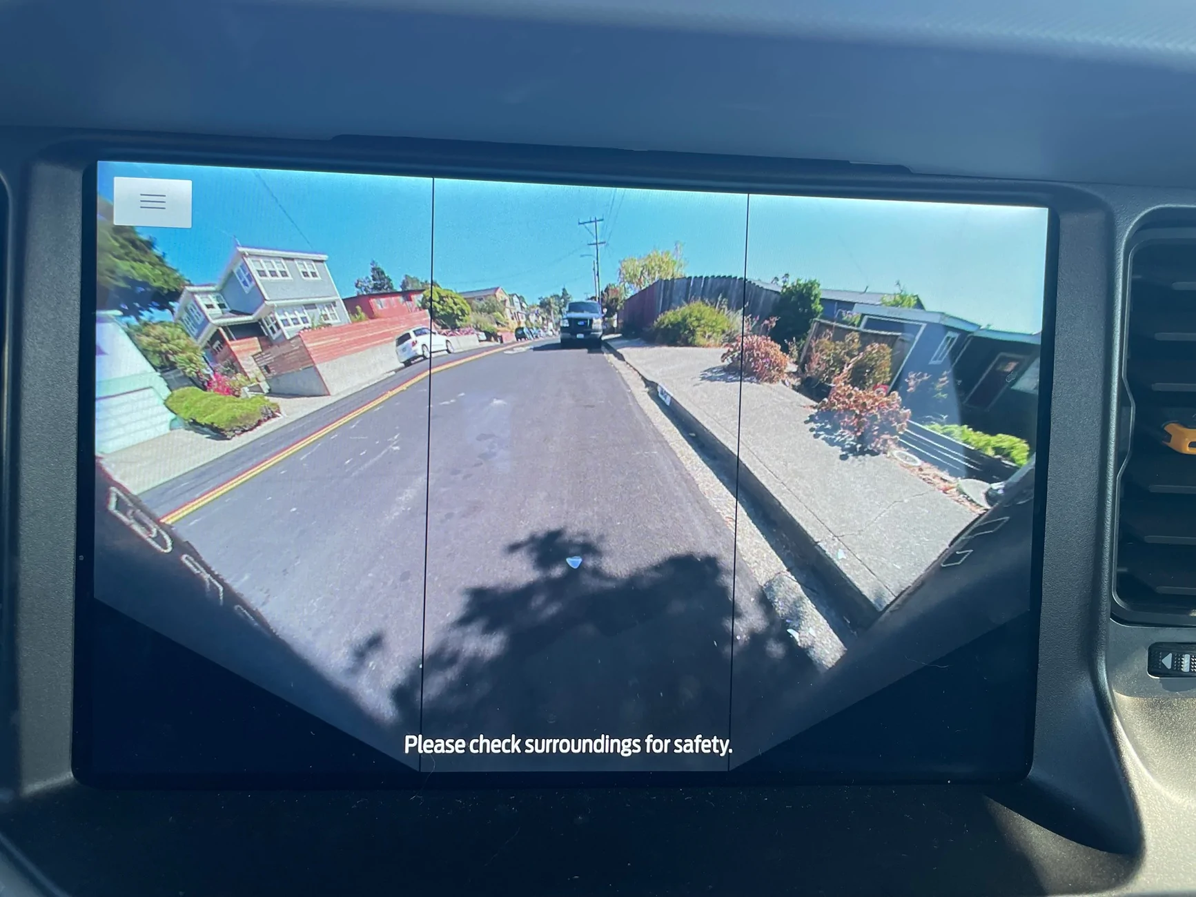

In the wide rear view, I can see my tire sidewall:
Ford Bronco Backup Camera Replacement for Recall - Spare Tire Issue IMG_1650
I honestly don’t recall using the wide rear view before so I don’t know how it looked before. But that doesn’t seem right.

I haven’t used the wide view either. Here is what mine looks like in standard view.
Ford Bronco Backup Camera Replacement for Recall - Spare Tire Issue IMG_2092
Your bird's eye view definitely looks distorted. I checked mine and it looks ok, so I’m guessing my rear view hasn’t actually changed from before.
Ford Bronco Backup Camera Replacement for Recall - Spare Tire Issue IMG_1653

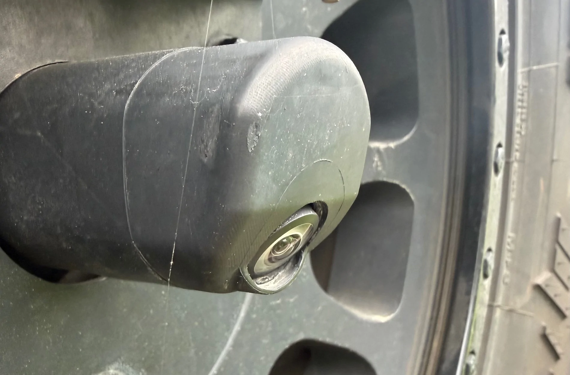

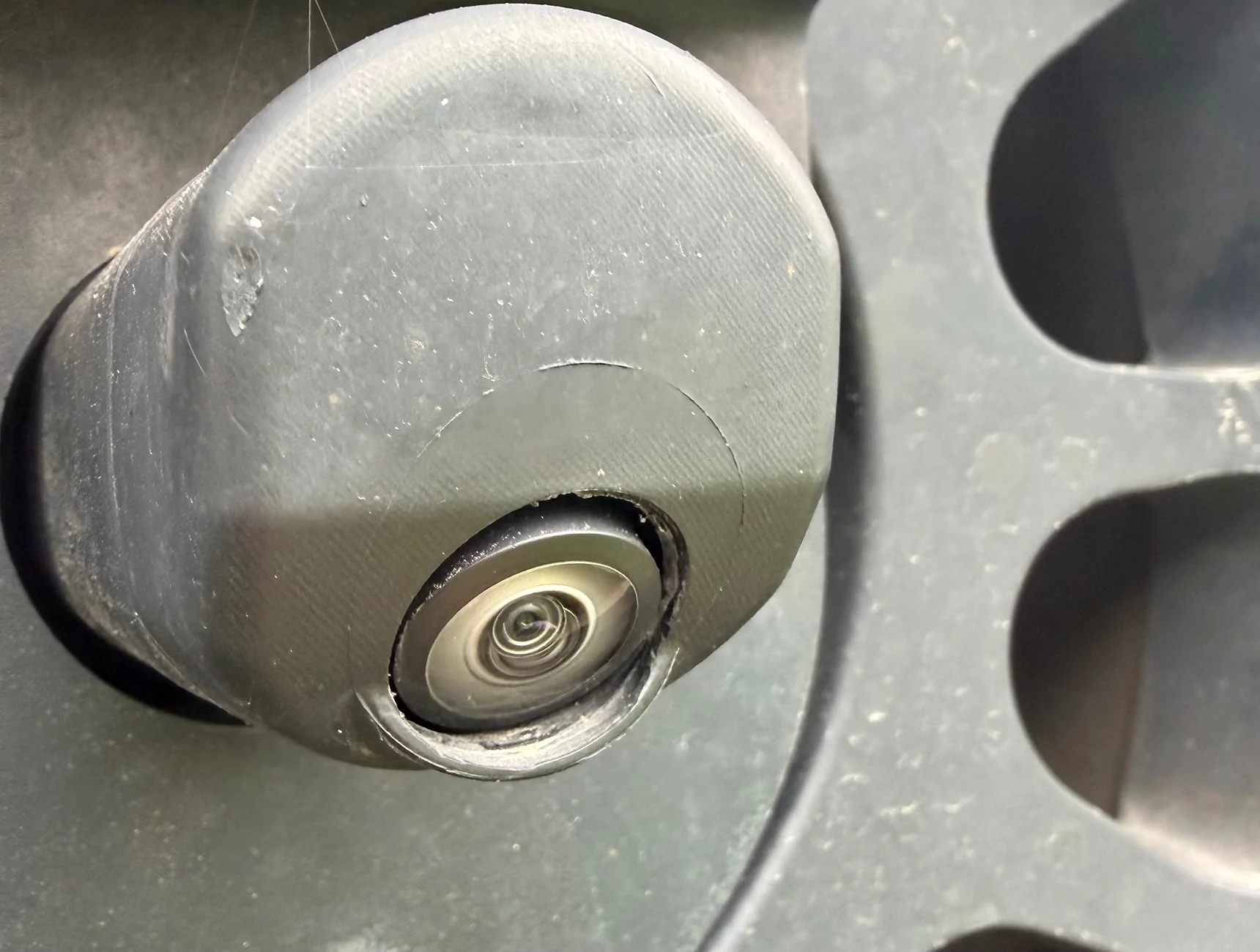

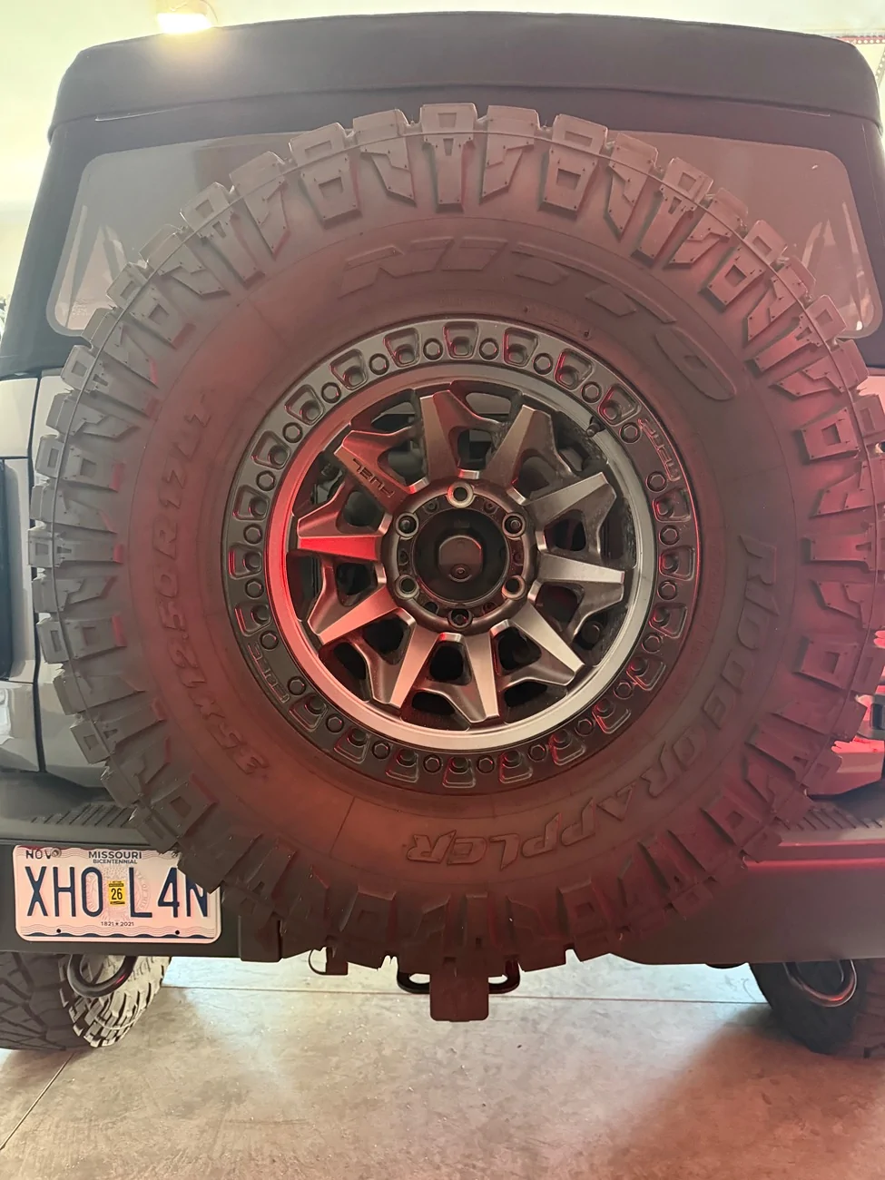

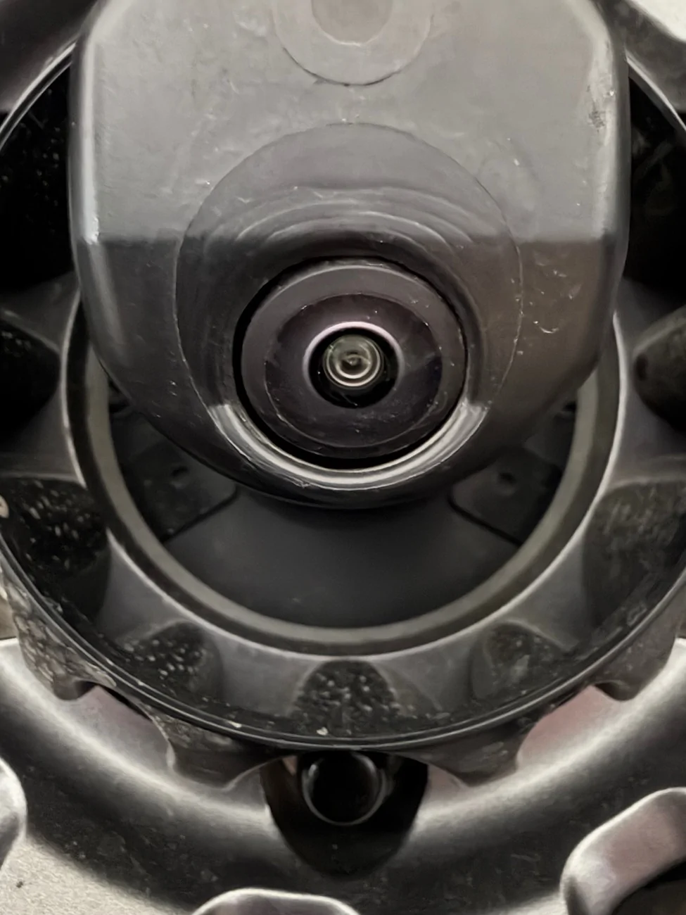

Here is a photo of my camera lens and the back of my Bronco/ spare tire. In my opinion, it looks like the camera was installed crooked. We went up to the Ford dealership by our house (not the one that services my Bronco for various reasons) and I took photos of all the camera lenses on their Bronco’s and they look different than mine. They are very centered in the space and don’t look as pushed back at the bottom.
how much lift does your Bronco have? I wonder if that might mess up the calibration, but if it’s not extreme, maybe the camera just isn’t mounted correctly like Ducati98 suggested.
i have a 3” lift. I had zero issues before the camera was replaced.
Ford Bronco Backup Camera Replacement for Recall - Spare Tire Issue IMG_3145
Ford Bronco Backup Camera Replacement for Recall - Spare Tire Issue IMG_3150

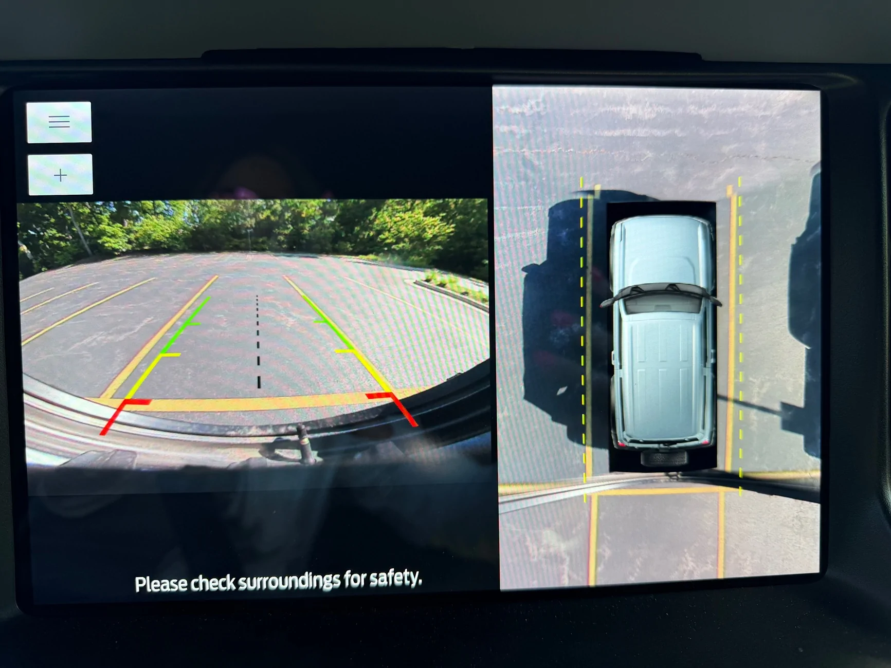

Yeah I'm not sure. Honestly after looking at mine, yours looks completely normal.
My camera seems to be pointed down a lot more to be honest, but even I can see the bottom of my spare tire and mine has never been touched 🤷‍♂️
