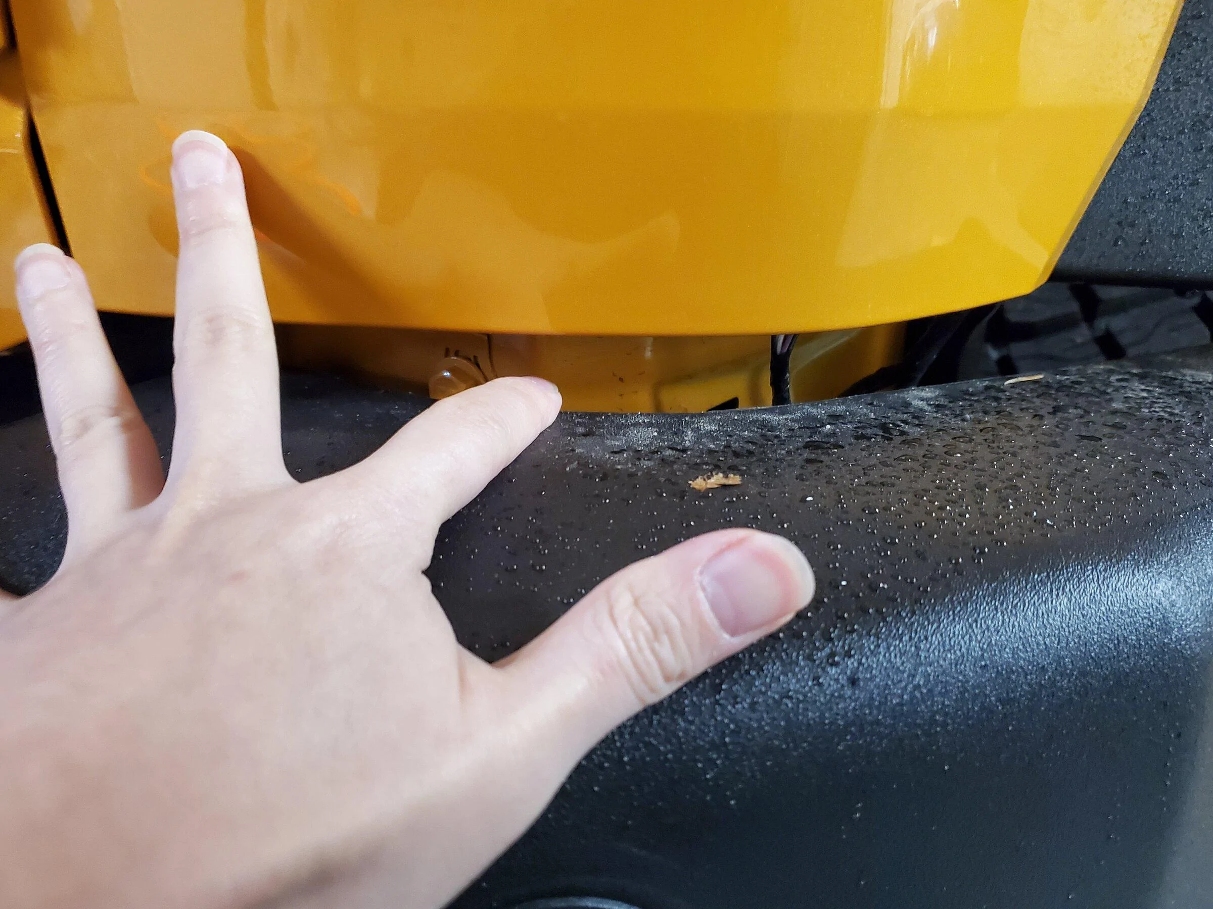

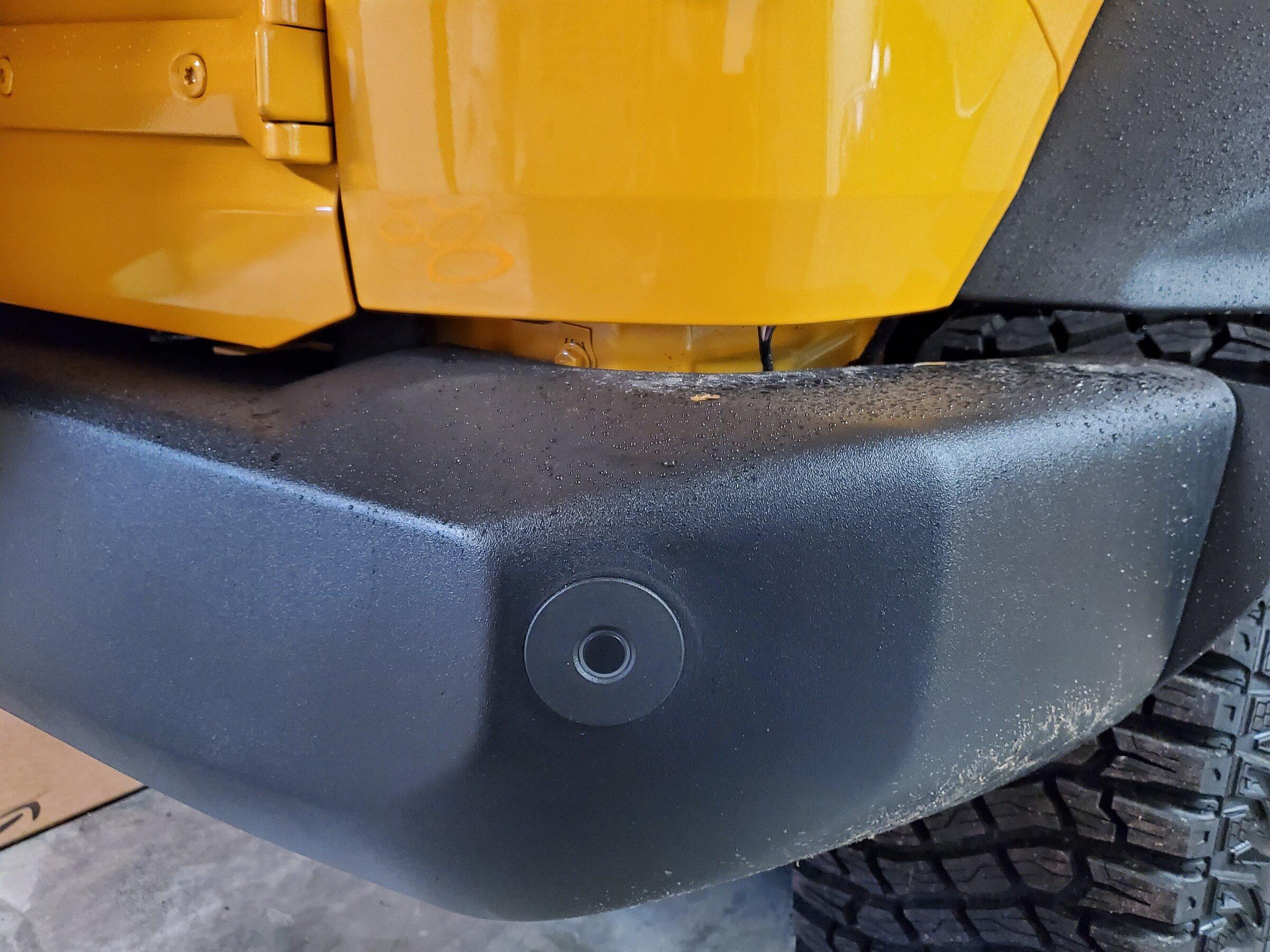

Now you’ve done it… We are all going to go look at our back bumpers and be unhappy with what we find. Now we can’t un-see it lol.
Trust me, I wish I hadn't noticed it.

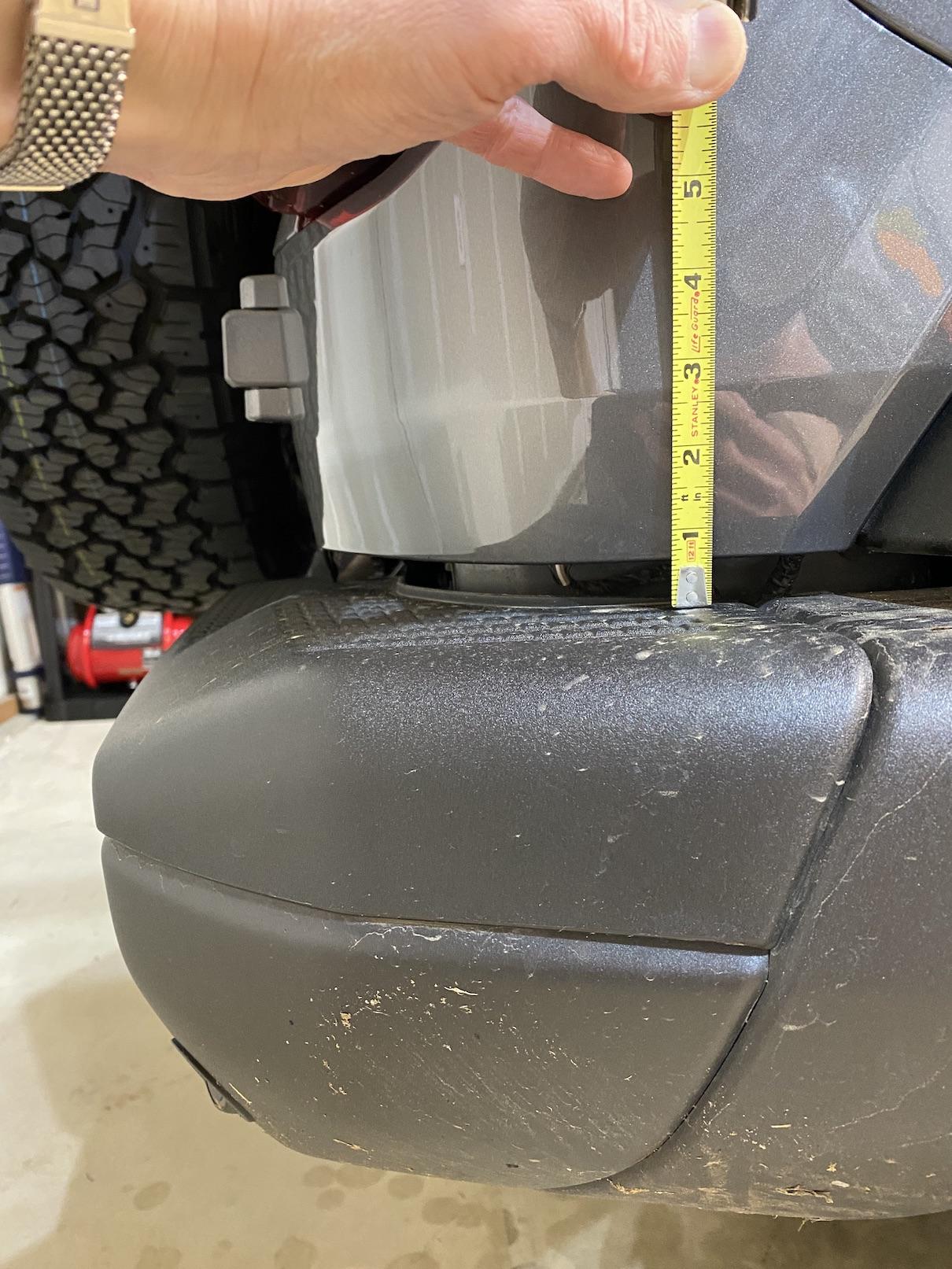

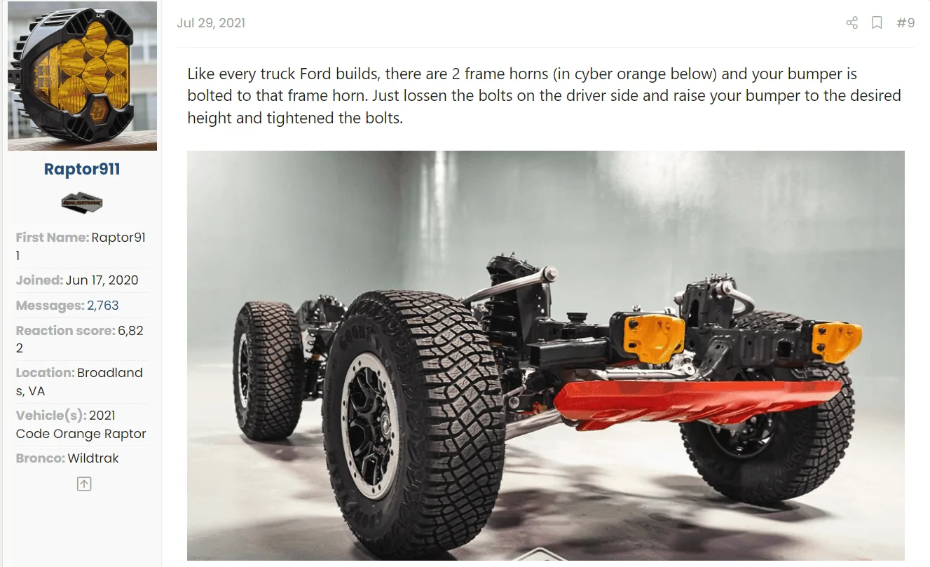

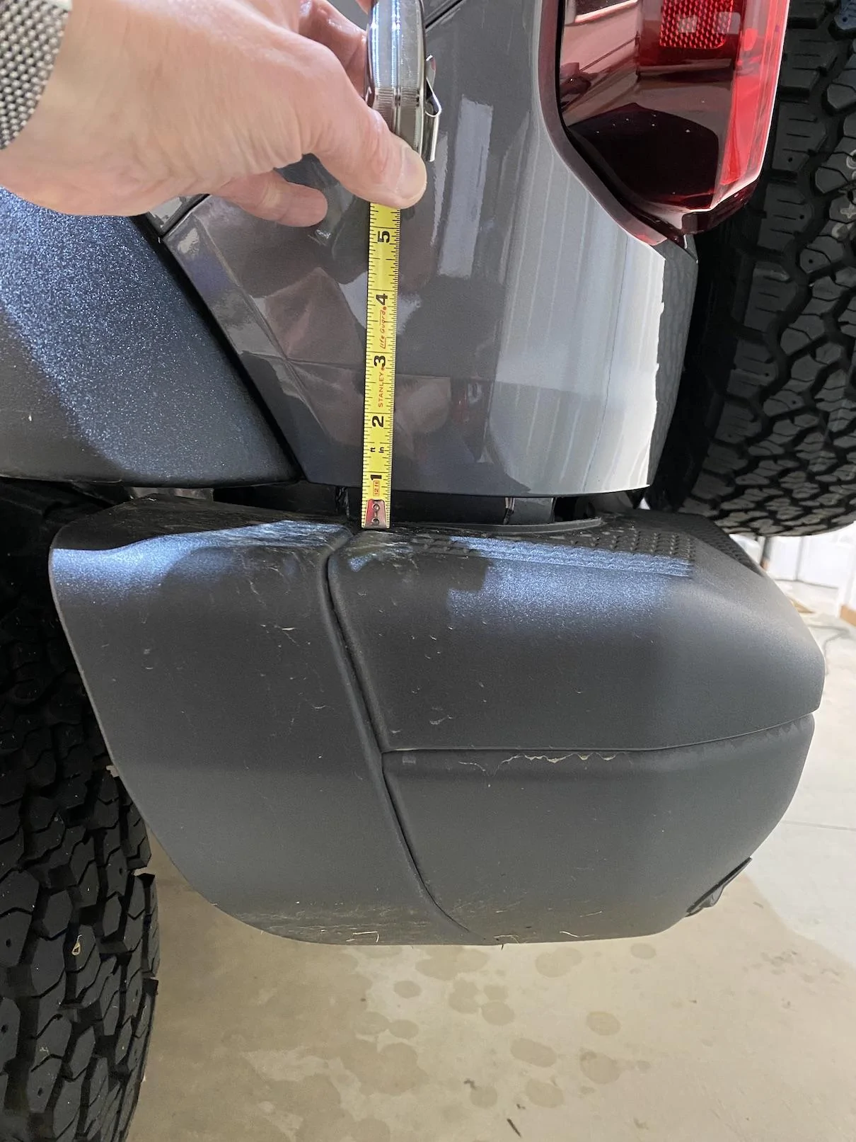

If there's not enough adjustment room in the bolt holes, you can always stack a couple of washers to help level it out. I had to do this with my chinese front bumper to make it set level, no big deal.
Also, this may be obvious to most people, but if you have a body lift, you are going to get a gap between your bumper and the body - just part of the deal with body lifts.
