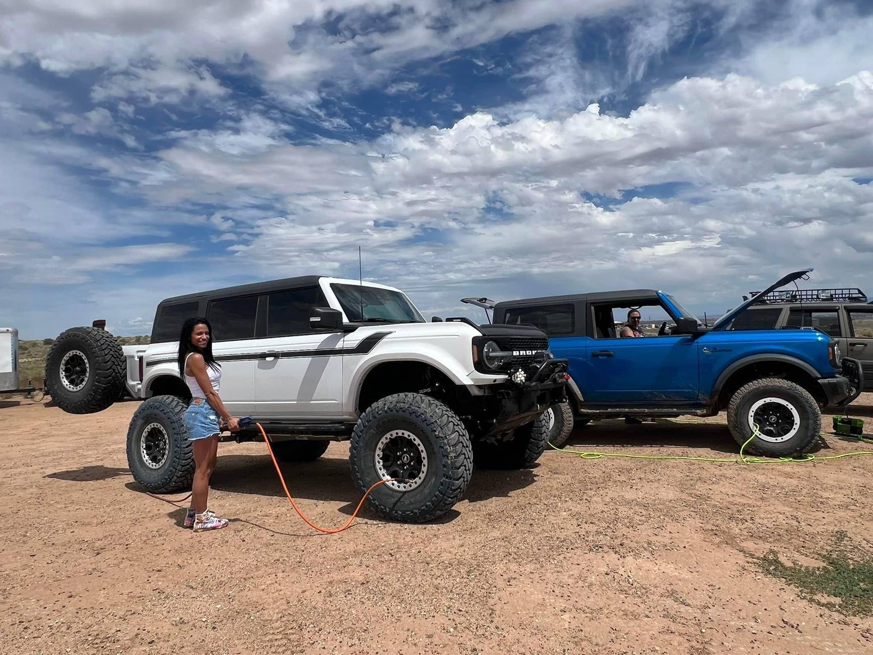

Don't bother with a 2-tire system, always go with four:

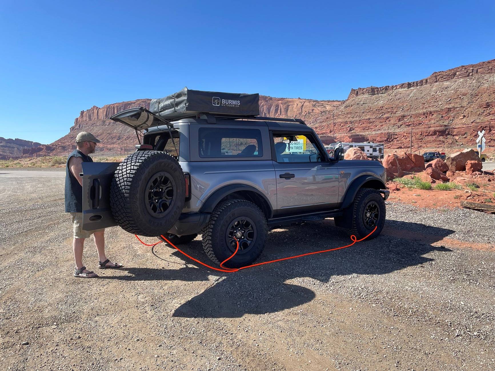

I’m very happy with my Utah Design Foundry air up kit. Quick and easy to use, and even comes with a custom storage bag.

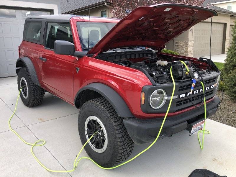

Get Apex valves. Use a single hose. You’ll air down faster before the four hose guys untangle their stuff. The compressor gets to cool off for a moment between tires when you put the valve cap back on and move to the next tire. You’ll also air up more quickly with the apex valves.
Bonus points for not having a mess of hoses in the back.
