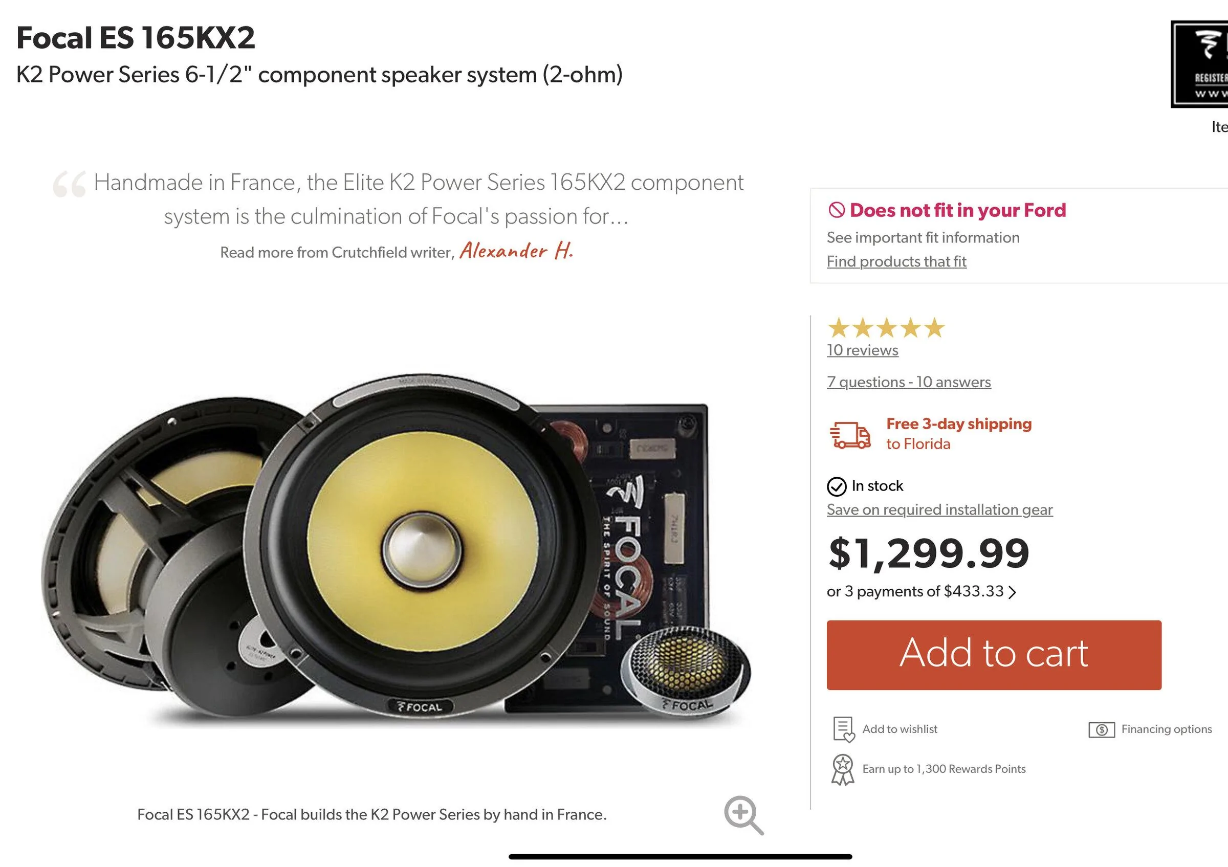

I appreciate the response. I did see those focals on there but that’s some serious coin for some speakers lol. I’m sure they are worth it though.
so you ran those focals in the bronco? And put the tweeters where the factory 4” speakers are?

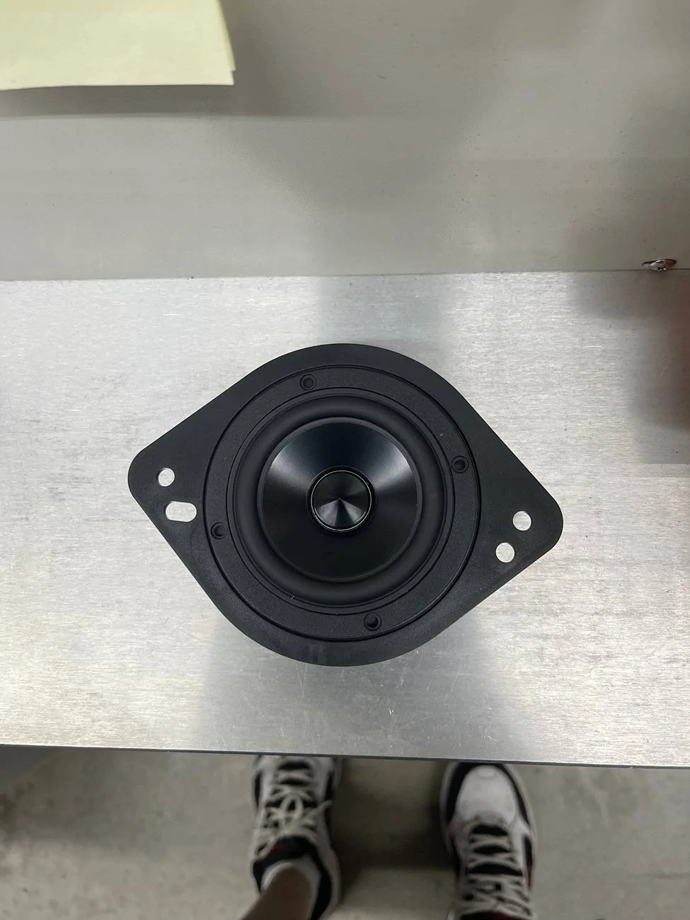

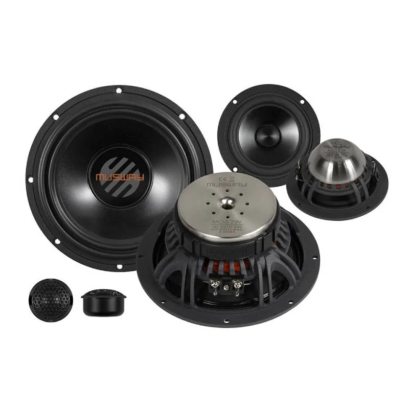

If you’re looking for a killer, three-way active set up, Musway has Awesome set up and I have several bronco owners who have this kit . I have the adapter plates to fit the 3 inch for the bronco for the dash as well
Ford Bronco Audio upgrade. Has anyone done a 3-way component system?! IMG_6318
Ford Bronco Audio upgrade. Has anyone done a 3-way component system?! 71467317208__A8FE2893-E88C-43D4-9576-460D8D9DA094
