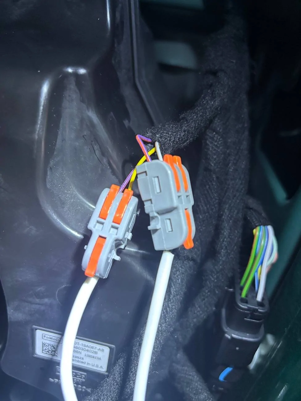

Hi folks- I’m about to go down this same route w/ the mObridge and Stinger tailgate sub (bypassing the stock sub)…just wondering how to best connect the mObridge to the sub. I’ve been told that you can splice into the stock B&O wires to the stock sub and run 14 gauge speaker wire to the Stinger sub, Just checking to see if that’s what others have done. Thanks!
I cut the connection out of the stock sub box. I never thought to just order a connector. If I trade the truck in, I will just have to buy someones stock box lol.
I did the connection just as you are planning. See wire connection bottom left.

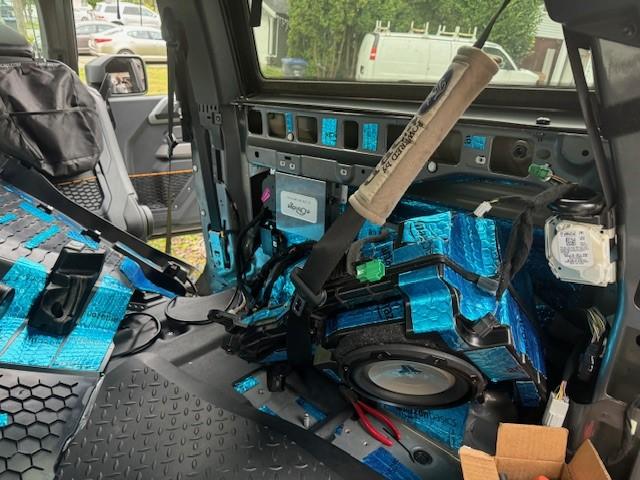

I also went the @mObridge route. If you are willing to invest the cash and want a sleek all in one kit, MoBridge is THE kit. Straightforward install that is all hidden for an OEM look. Fraser at Mobridge can set you up with a custom DSP file for the speakers you use. You can then fine tune the file in the MoBridge software to meet your tastes.
For speakers, I used:
Hertz cx100s in the dash (Corners and Center)
Hertz MP Pro 163.5s in the kick panels
Hertz cx165 in rear mabett pods
Kicker Comp R 8" Sub in factory location
A really key thing to do, in my opinion, is sound deadening. Not only does it improve the sound quality, it significantly cuts down on road noise. I did the following:
1. Lined the entire floor, rear cargo area/fender wells and factory jack storage with Kilmat 80 mil, topped with Siless 4mil liner. For this I removed all the seats and pulled up the carpet liner.
2. Covered the entire factory sub enclosure (inside and out) with Kilmat and stuffed it with polyfill. I did have to modify the box very slightly to install the Kicker sub.
3. Filled the plastic storage compartment in the cargo area (I never use it) with closed cell foam, as well as any empty space in the jack storage area.
4. Lined the inside of the rear Mabett pods, and factory dash speaker mounting locations with Kilmat and Siless and stuffed them with polyfil.
5. Lined the factory kick panel mounting locations with Kilmat, Siless liner and stuffed with Polyfill.
6. Lined the doors with the Soundskinz bronco door kit. I also used some of the extra soundskinz trimmings to line the inside of the actual door panels. You can access this area when you remove the vapor barrier when installing the door kit.
I have also found that the source of your music will drastically improve audio quality, regardless of your system setup. Streaming from Apple Music/Spotify is light years better than Sirius or FM radio.
With all of this, I have the best car stereo system I have ever had. The bass isn't going to shake any windows, but you can certainly feel it from the kick panel mid-bass speakers and the sub. I also have no bass rattles to speak of.
I have not given up any rear storage space with a sub-box, and my tailgate is space is free for my table and fire extinguisher. I could add a second sub in the future, the MoBridge has a separate analog out channel for this, but it is not a necessity. If I did, I would likely use a powered under the seat sub to keep things hidden and space free.
Overall, very happy with the investment.

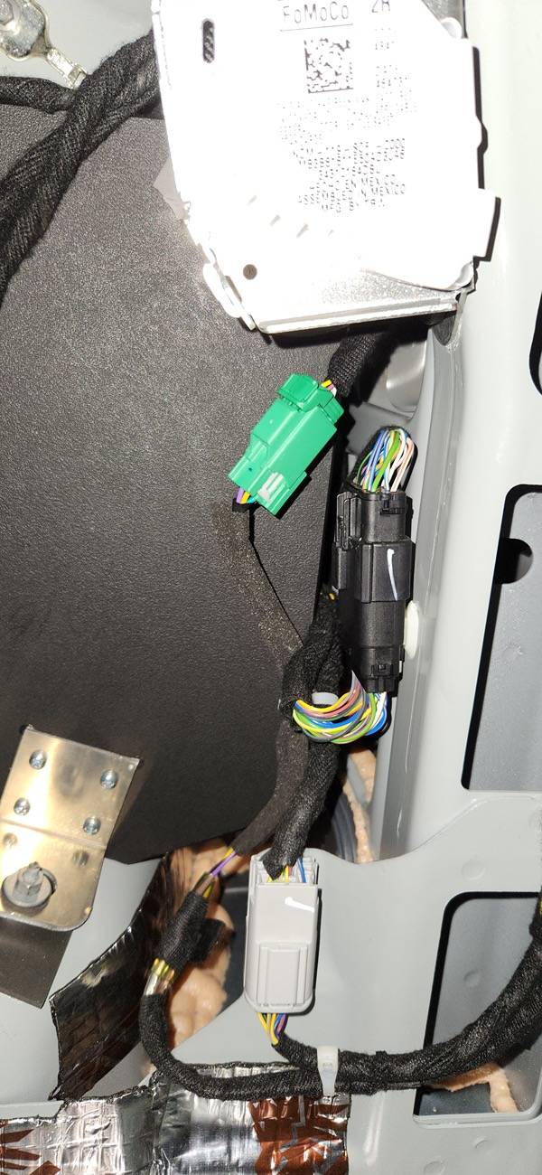

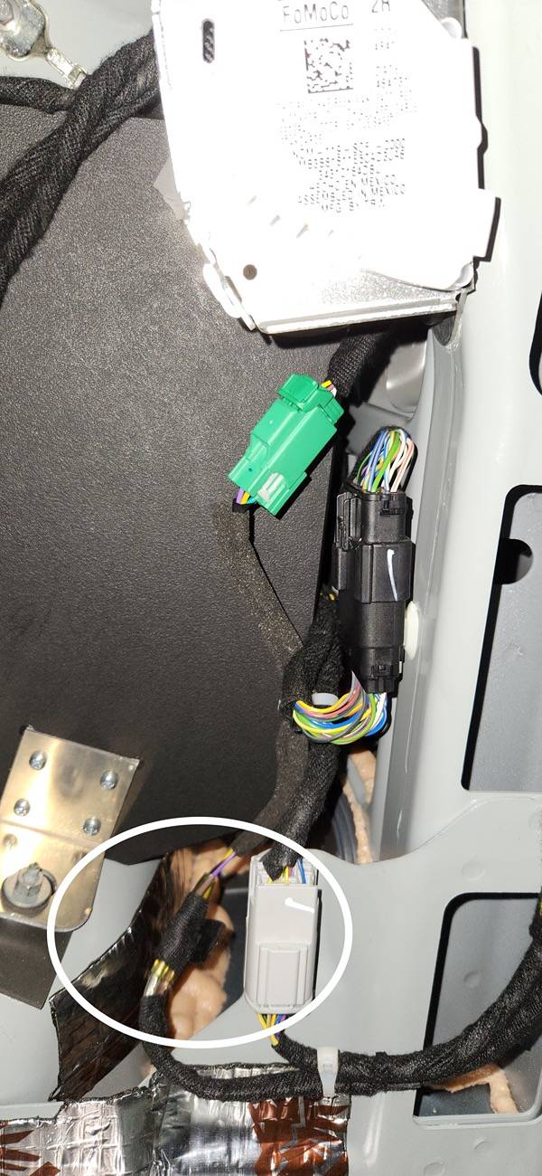

So I just installed the mobridge amp/dsp and tested it out with the stock sub and sub connection and was working fine. I clipped the stock wires from the female green connector and used lever connectors to 14 AWG wire (pictured) to wire to the new Stinger (AudioControl) tailgate sub. Now sound from the sub. Any idea what might be wrong? I checked to make sure all +/- connections were accurate. I've heard advice to clip the pink sub wires from the mobridge harness but don't want to mess with that unless I need to. Thanks in advance!
Apparently, mine came with one of the newer harnesses. I cut mine from the sub box.
For me
Green/Yellow = Positive - I joined together
Black/purp = Negative - I joined together
Sorry truck is in the shop for accident repair so I can get close up
Here is a pick of where I cut it at the sub box
Circle is where I joined with wires from the sub.

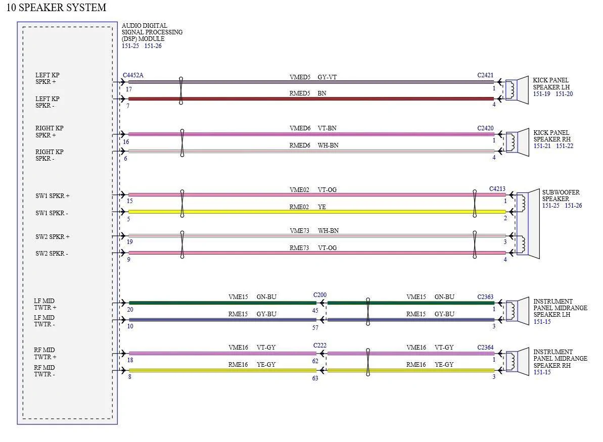

Thanks Fraiser! This is the wiring diagram I was going off of. If that doesn't work was planing on cutting into your harness for the pink wires - if I do that can I just join the 2 pinks and 2 pink/silvers with those lever connectors to a 14 AWG wire?
Yep exactly, that would be my next suggestion.
