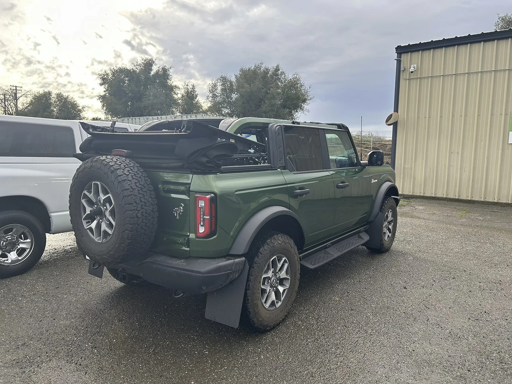

Not yet, but coming next week. I brought my Bronco in at the end of the day. They're installing the top and a few other things too, plus they're closed for 4 days over the Christmas weekend. I may not have it back before Monday.
Unfortunately, I forgot to get a photo of the top. It looks great!

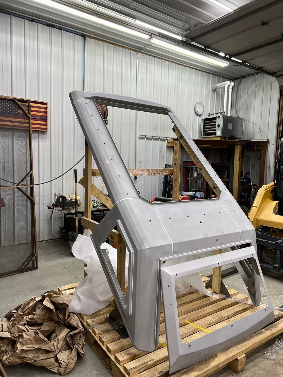

Currently have a slant back that I will be posting up for sale in the upcoming week or so, it’s still in raw form and on pallet as seen in picture. No longer own a 4door so don’t work for new Bronco unfortunately. Have liner black hex pattern, as well. Also have the Inner side panels and a custom rear shelf. Have a full set of talion aluminum skids too. I’m located in ft Wayne, Indiana just thought I’d say something in here incase anyone is looking for one quick without the 4-6 mo waiting time.
