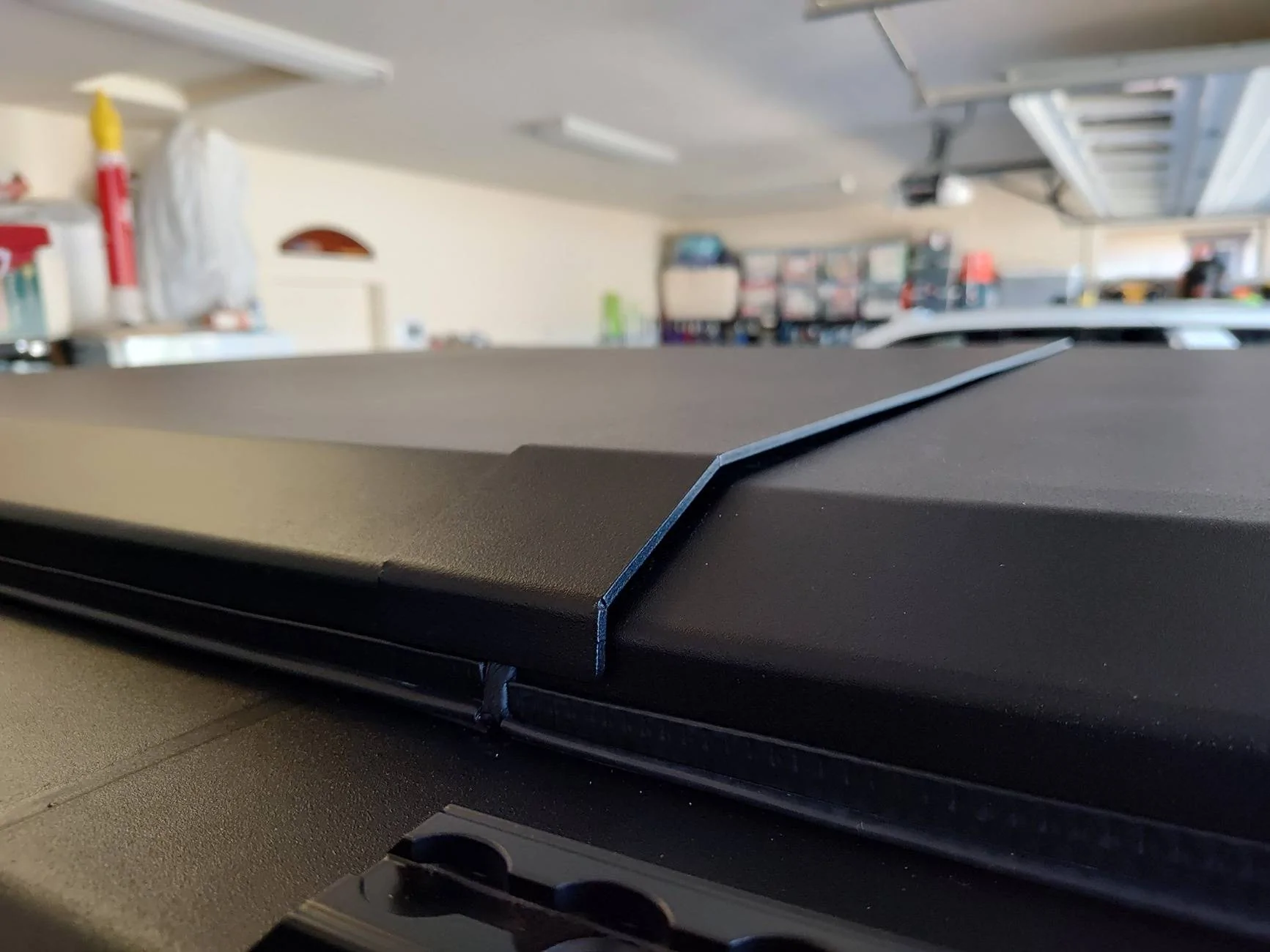

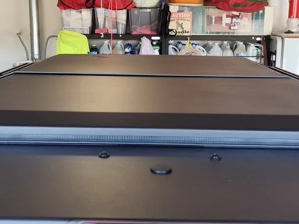

Hopefully everything lines up … just looks like it’s misaligned slightly and something is pushing that side up like the gasket. Hopefully Ninjaks tips works for you.
thanks for helping him out @Ninjak and good luck @DUSTYcazOREGON looks like you’re just about there
Here is what I discovered: All latches un-done, it all sits down level. When I went to latch the two top panels together (per the video) at the driver's side (point of my issue), as I closed the latch, it progressively raised the front section causing the inside frames to not be "level" to each other and the outer front top to raise. So, despite their directions to latch the two tops together first, I unlatched them and then latched down the first latch on the driver's side-front panel, near where the panels meet....then the same on the other side, then the two latches that hold both panels together. Latching that side latch FIRST prevented the latch (that holds the panels together) from forcing the front panel to raise up. I also used water soluble lubricant (do not use petroleum-based products, can ruin Powdercoat) on both corners of the rubber where the panels come together. I would advise people get the panels up there, set them together, get them to fit with each other....move them forward/rearward for alignment and then latch down the side latches first (near where the panels come together) then fasten the panel latches together.....see what it is doing on the top side and if all is good...finish with the other latches. The tolerances between the two panels is tight and the seals are thick and strong (a good thing)....all this leaves smaller and smaller tolerances....maybe just slightly too little. I would suggest that in manufacturing that front panel, where it laps over the rear panels...that the side arch down be "out" a small fraction. Hope that all makes sense.

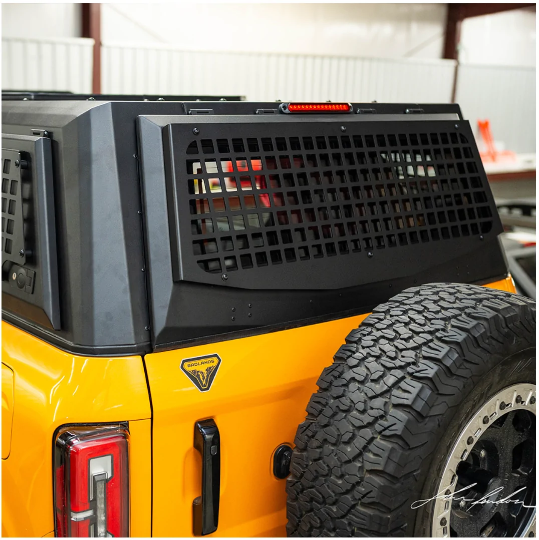

Can anyone with Armadillo square back top that has rear window molle panels take a picture from driver's seat looking into rear view window? Wanna see visibility through back window with panel on.
On the fence re: rear window Molle panels. Visibility off-road is less of concern, but most of my driving is freeway and city traffic, so visibility more important.
Looks badass and very functional. Pics and feedback would be appreciated!
https://armadillo.design/exterior-rear-window-security-molle/
It comes off via 6 M6 bolts by the way, so just wait to put in on for off road trips, that’s what I would do.

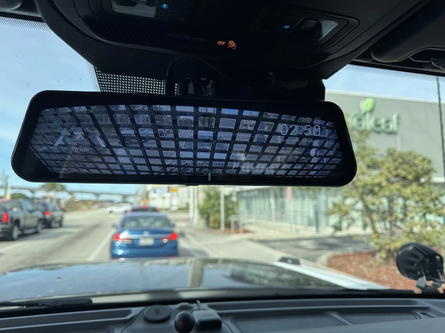

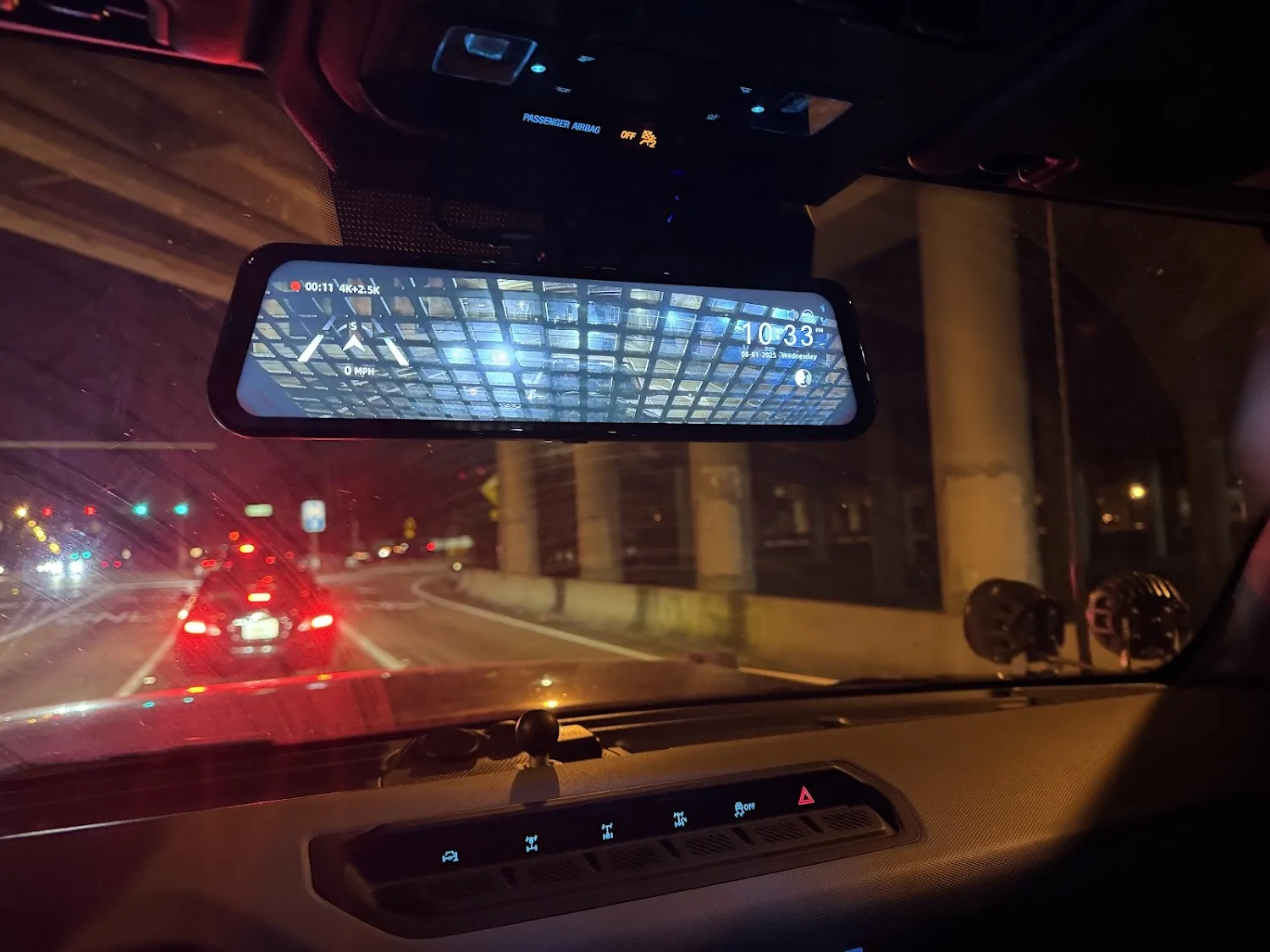

I do not have the best pics, also I run the slantback. I have a wolfbox cam, but I can tell you, if you look back, you can see. I can see through my cam, so that is why I never put it outside.
The pics I have is from when I first installed my Wolfbox.
Night pic
Ford Bronco Armadillo Designs Aluminum Hardtop 1754241701250-ji
System off Pic
Ford Bronco Armadillo Designs Aluminum Hardtop 1754241752988-01
System on Daytime
Ford Bronco Armadillo Designs Aluminum Hardtop 1754241780531-ix

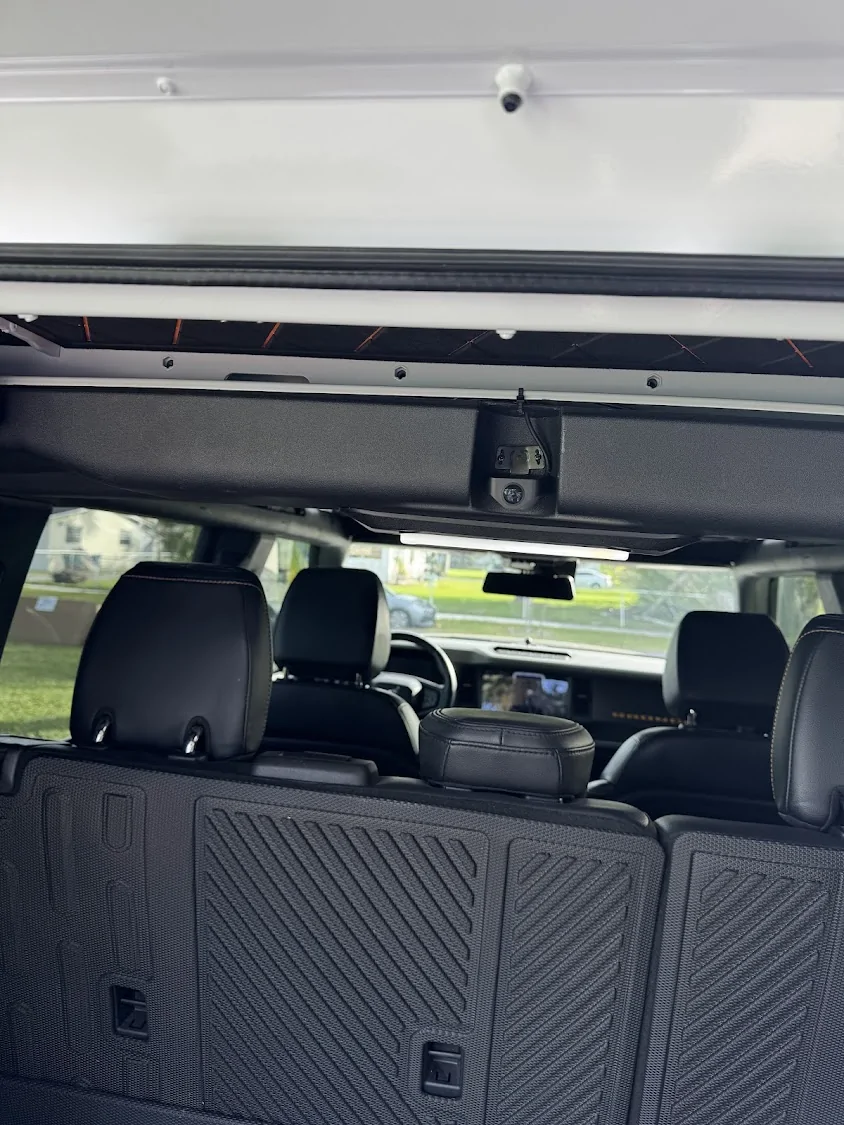

Where the cam is located.
Ford Bronco Armadillo Designs Aluminum Hardtop 1754241930325-bt
As I said, not the best, but you get the idea. Also, as I said, I have a Slant-Back. As someone else stated, you can always take it off. Honestly, I use my side mirrors more than my rear, so it does not affect my driving.

VERY cool, thank you for sharing, totally forgot about the option to put in some kind of rear view camera! Guessing slant back has slightly less visibility due to angle, VERY helpful, much gratitude!
