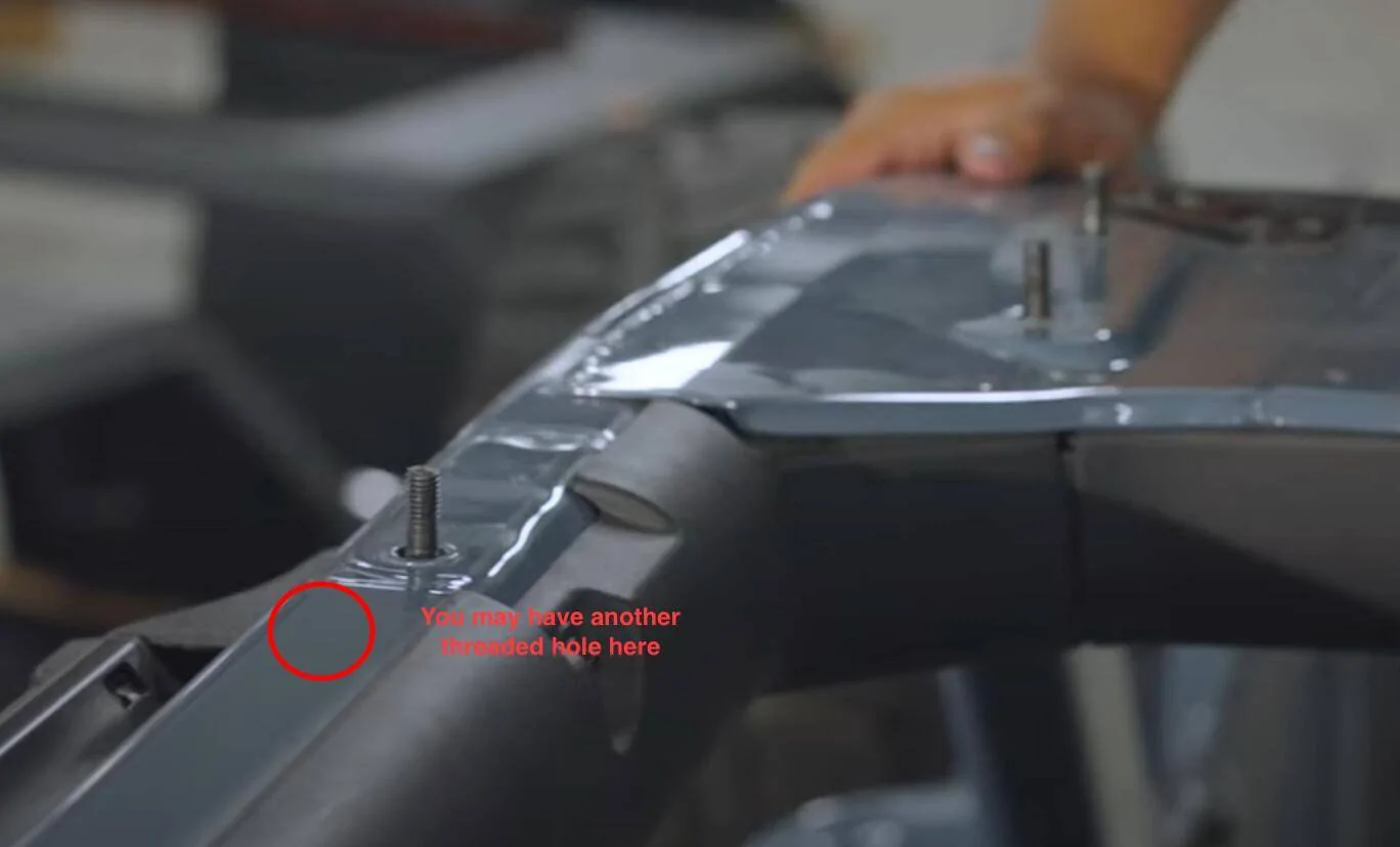

Hey sorry been rather busy lately.
First one of the things I thought was not in the video is but for less than a second and I missed it. That is removing the Hardtop or Softop brackets in the front and sides of the roll bar.
There are still some differences I had from the install video. Sorry this is going to be a lengthy explanation.
When you put in the 6 M8 studs, on my 2023 bronco anyways, there was two threaded holes on each side over the rear doors not one like in the video. It is the rear set directly above the the panel bolt holding on the trim.
Ford Bronco Armadillo Designs Aluminum Hardtop Screenshot 2025-07-10 at 3.26.48 PM
Measuring the distances made it clear this was the correct spot but clamping at the base of the B pillars like in the video caused it to miss the corresponding hole in the top by about a 1/16 of an inch. I was lucky and 3 out of the 5 who helped put the top on were large guys and we just pushed and pulled it into place but if we had not had them I would probably had to ratchet strap it high up maybe around the rear opening to pull it strait forward instead of from the bottom where it tilted the top slightly.
It took us two sets of hands to fix each rear gasket while the third lifted to get the gasket at the rear body to sit right not just one person at the corners.
The last issue I ran into was installing the rear bolts all the way before the front left the barest minimal threads to start each afterwards. I would just start them all then make sure everything is lined up and tighten it up following the order of install in the video.

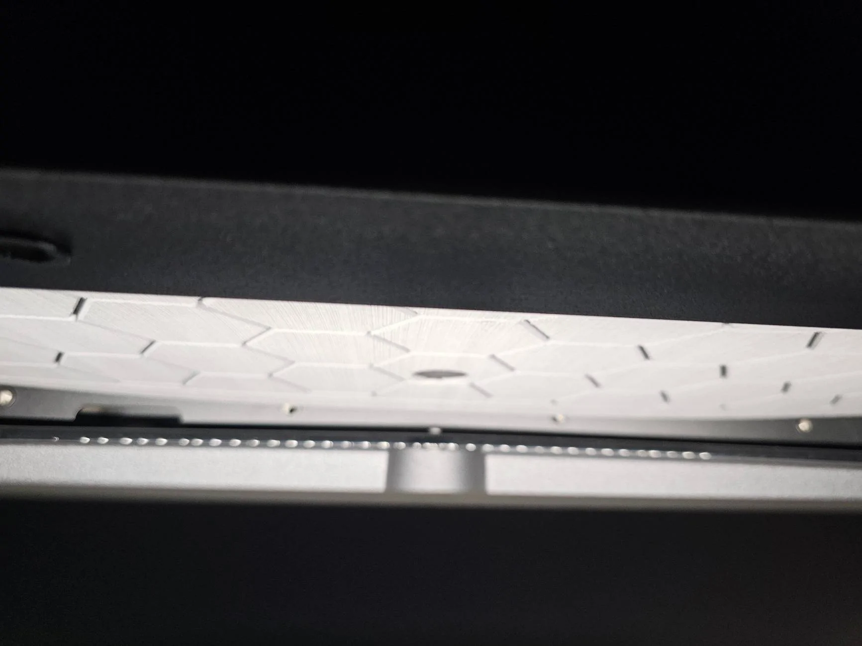

Has anyone had an issue with the front roof panel not seating all the way down on one side? See photos. Passenger side all the way down, driver's side is a gap. Properly installed, all latches lined up and tight. Have tried re-doing and seating, starting opposite side first...nothing. I believe someone had posted they had a gasket stop or gasket interfering and doing the same.
Any help would be appreciated.
Thanks.
I had that happen to me. Even though it latches up and seems tight, it is not on correctly. I stood on the side and pushed down and aligned the top until the gap was gone. I also adjusted the latches, then tighten them down when everything was aligned correctly.
Thanks...yeah something is not right.
I have all the latches un-done. Going to get the wife to hep me lift the top off. There was a mention by someone about some of the rubber binding up causing it. Hopefully find what it is, lubricate the rubber where it is tight too....that may help it come all the way down. Will report my findings.
Also make sure the back panel is seated correctly. When I went through my top, I did find that the driver side was slightly forward. just a hair. I corrected that and did my push down and everything lined up.
