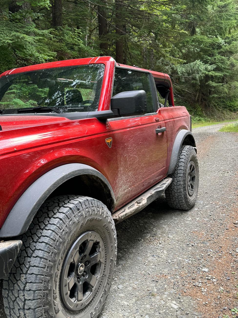

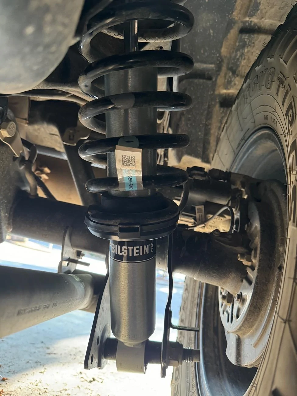

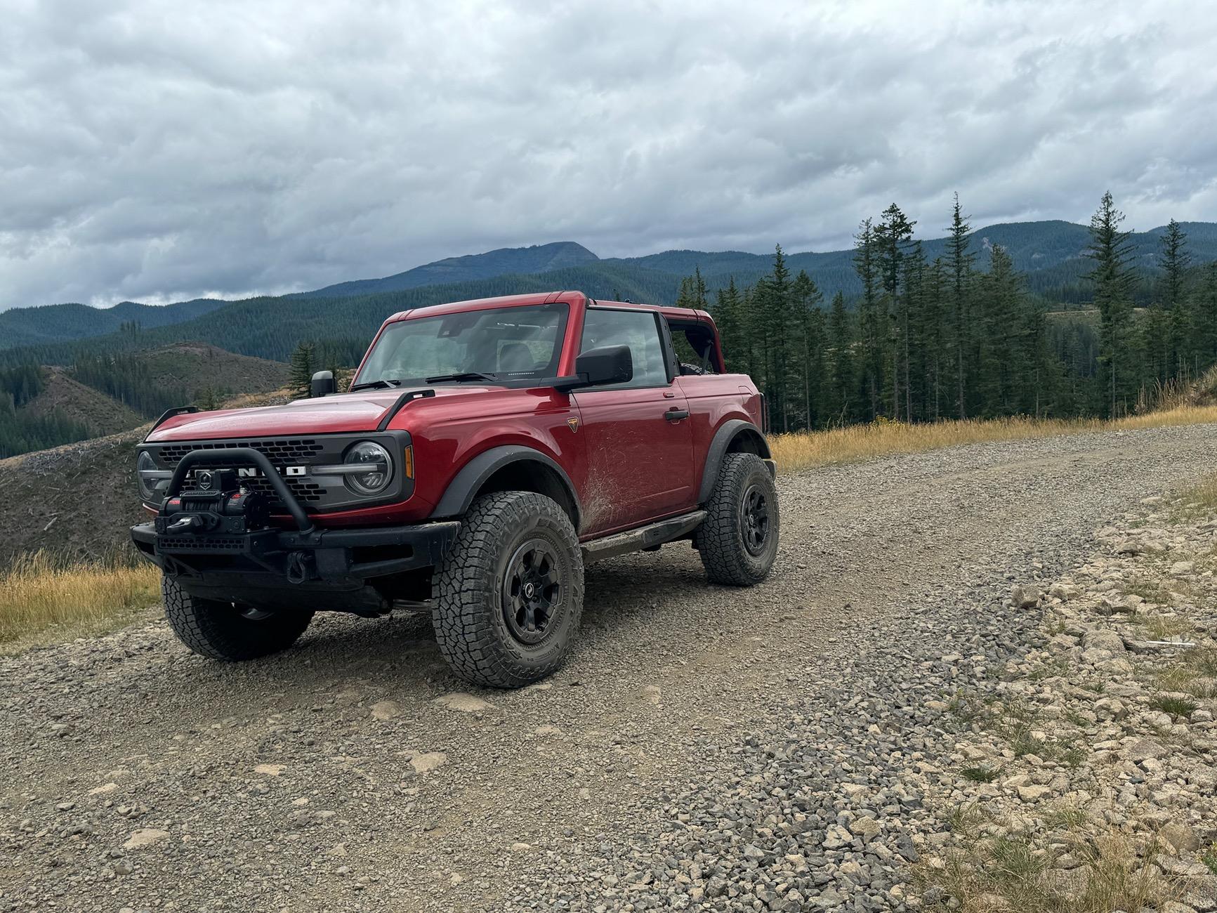

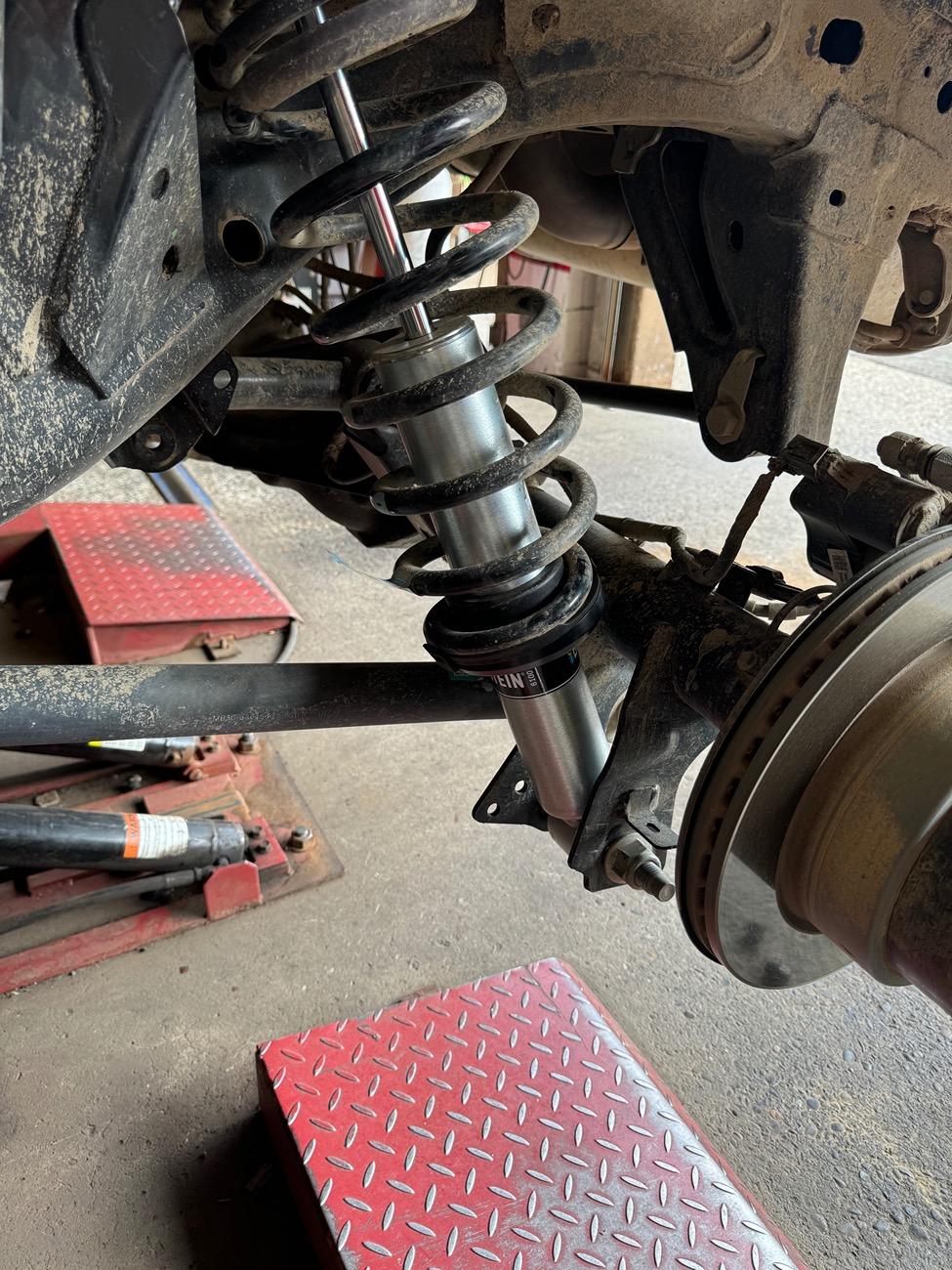

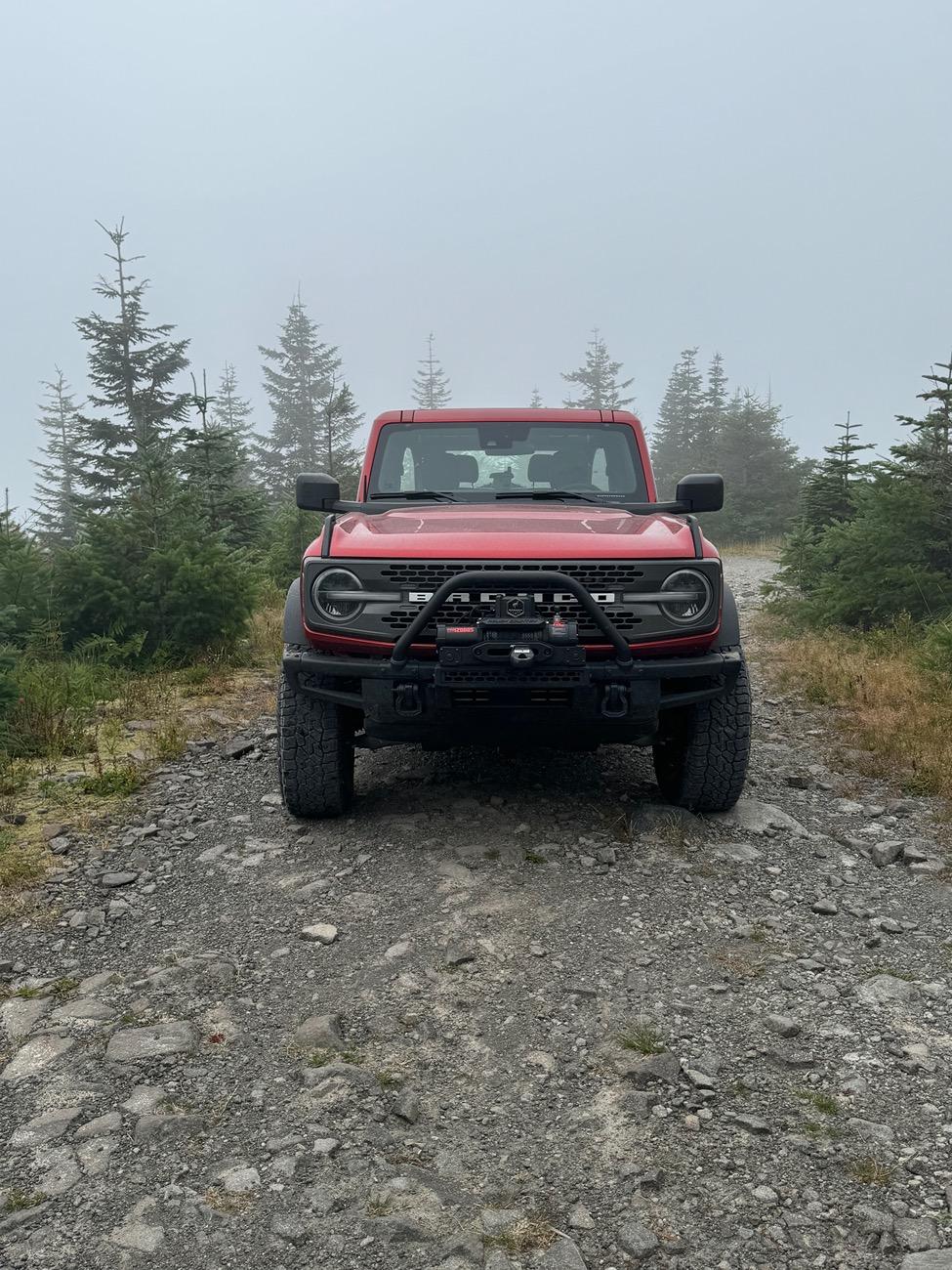

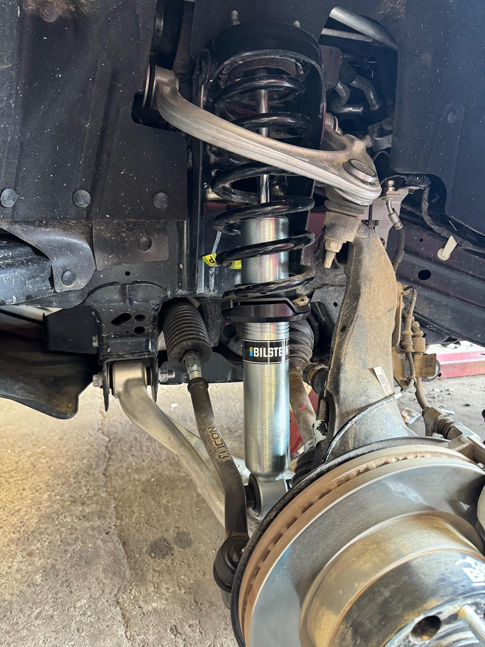

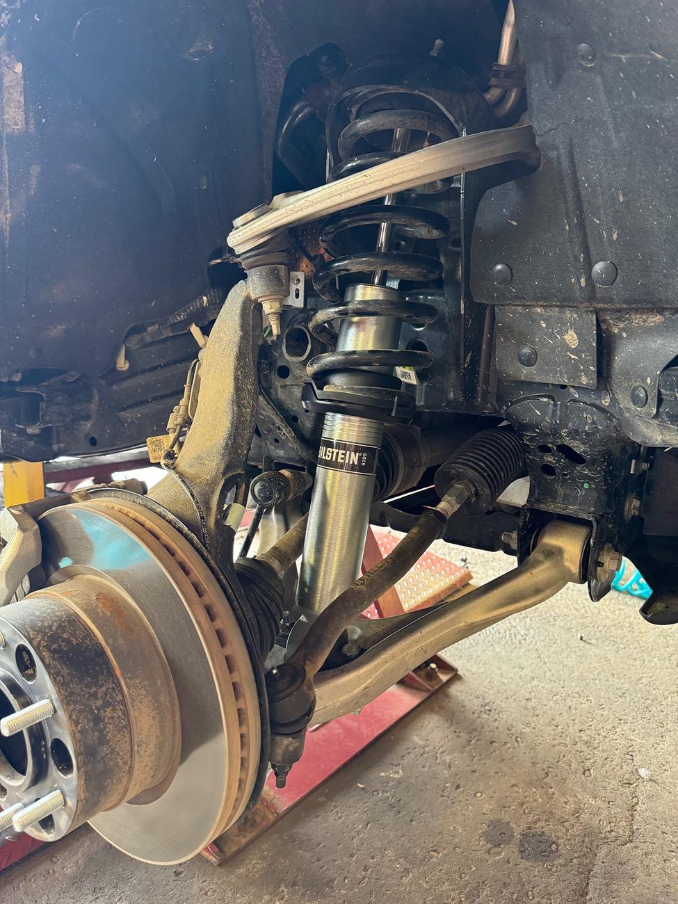

I recently replaced the stock shocks on my 2DR Badlands, non Sasquatch, with Bilstein 6100's. I also added 35x11.5R17 (c rated) Wildpeak A/T4W tires. I am happy with the swap.
I went with clip position 5 in the front and got about 2 1/2" lift. On the rear I went with clip position 1 and got about 1" lift. I now have about 1/2" of rake. I do have 100+ pounds of weight added to the front via winch, winch mount and an ARB dual.
Was there a reason you didn't install the bump stops? I am not sure that is a great idea if you plan to go offroad.
