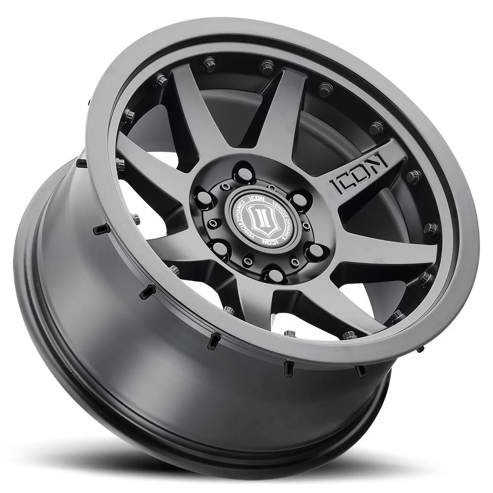

So far I have not had any problems with the rims, no air leakage, or any other problem. Icon instructs you to put anti-seize on the threads and oil on the O rings for each of the pins. I used silicone grease on the O ring and to much anti-seize. Which then squeezed out when tightened and is a pain to clean off.
As far as color of the rims Icon has black, grey, and bronze on my rig I thought black would look best, it seems like any of those colors would look good on most vehicles.

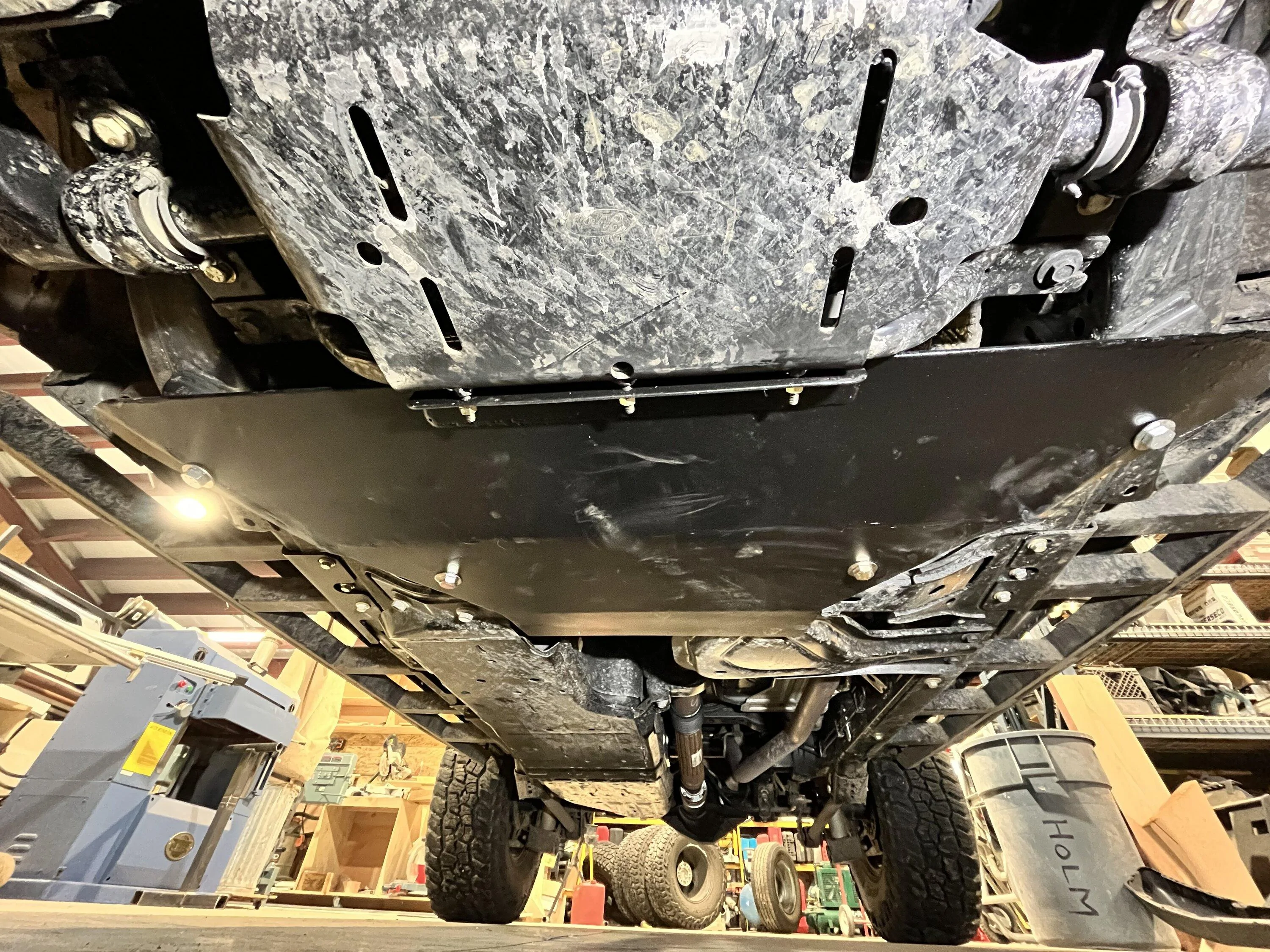

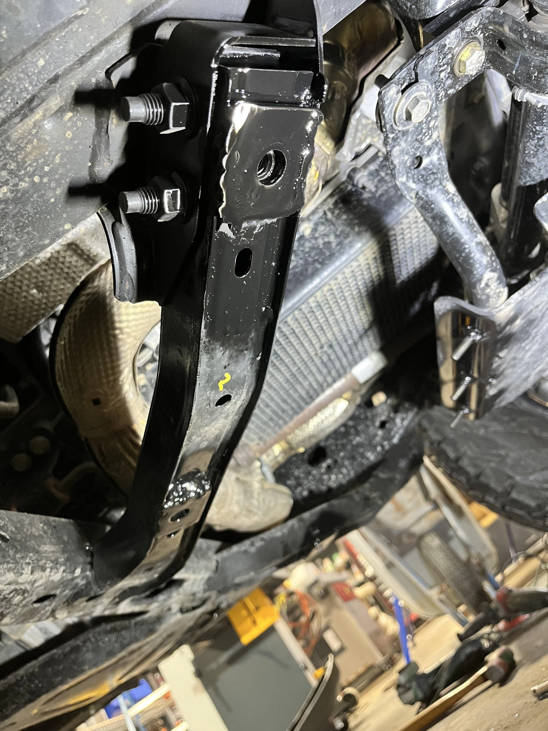

I just added a transmission skid, I bolted it directly to the cross members. I added a couple of nut plates to the cross members and a few studs to the Disco skid. Next the transfer case skid then the engine skid.
Ford Bronco Apollo's Badlands build IMG_2449
Nut plates
Ford Bronco Apollo's Badlands build IMG_2453
Installed skid
I need to get some rock washers for the bolts, otherwise it seems very strong
