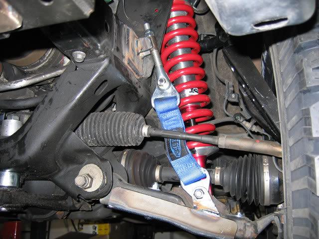

Anyone Try limiting straps to keep down travel in check?
I'm going to experiment but I need to know what length to try first.

Correct. I have a 5 inch lift. I need the clearence but don't care about flex as much for snow wheeling. and cv shafts are getting expensive.

Straps don't work how you think, you will be fighting brackets and mounting. You have to much going on in the limited space and aluminum lower control arms that you can't weld to.

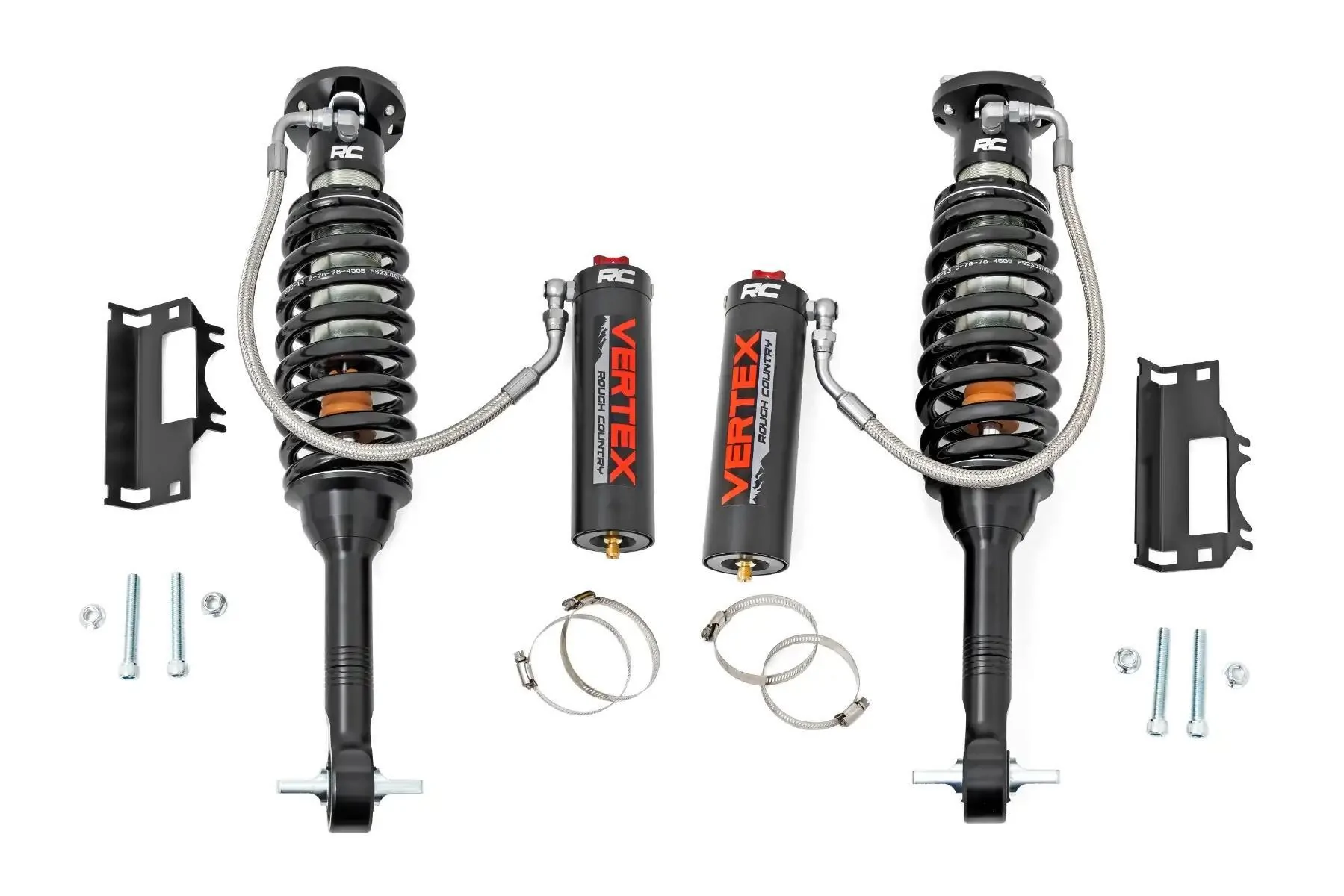

I'm actually taking those out and putting Vertex Coil overs in. same height, but I am hoping that the stiffer suspension will limit the droop a bit... or at least not make it as violent.

Toyota guys are using lower control arms skid plates as mounts. I still think it would be cheaper to have someone take the shock apart and put an internal bump stop in.
FYI I would stick to modifying the bracket and buying a normal front coilover. Cheapest, easiest and reliable solution to your issue.

Well.... I have these sitting in my garage already so...... In retrospect, I should of ordered the 3.5 maybe to drop it down a bit... but here we are.
