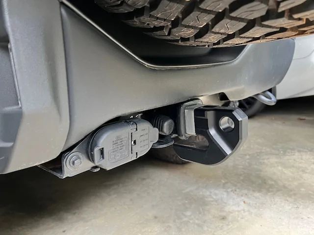

Couldn't fit my anti-rattle plate for my Bodyarmor skid since Ford jams all the wiring too close to the hitch. So I got this aluminum gizmo off of Amazon. Plenty of departure angle on a 2 door Sasquatch so it didn't get scraped on my most recent trip.

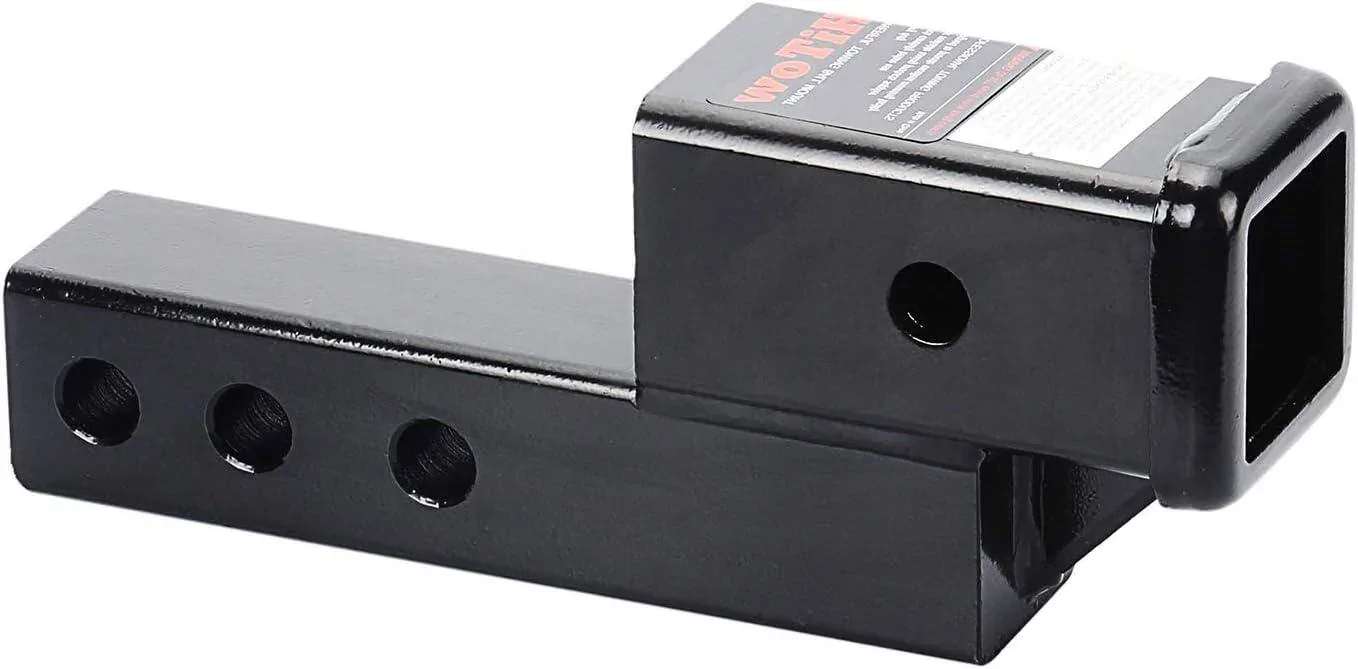

I have this on all the time for my bike rack which clears my spare, have it in raise position never any issues.

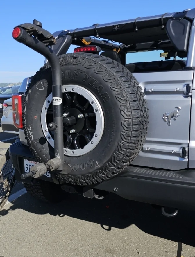

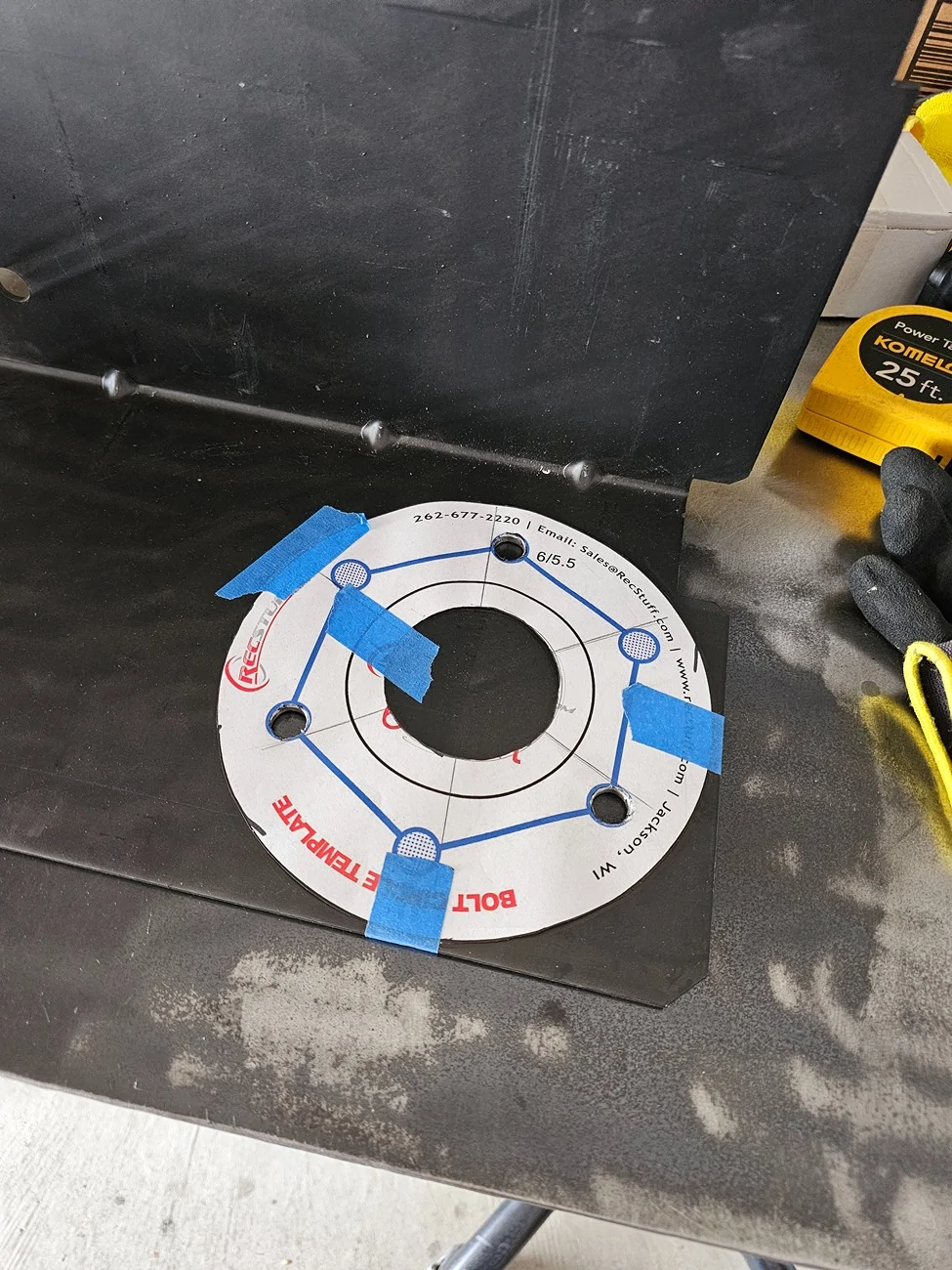

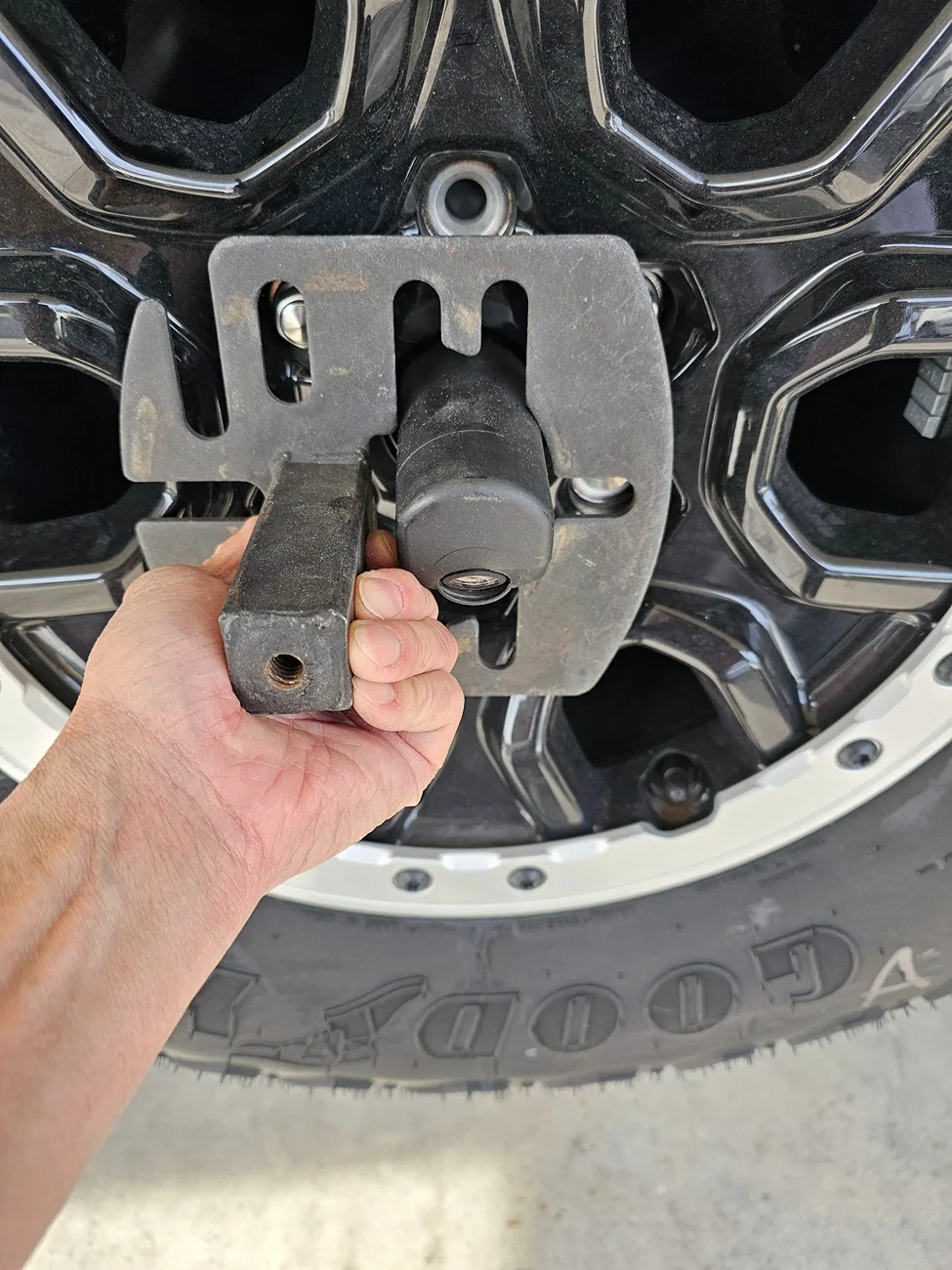

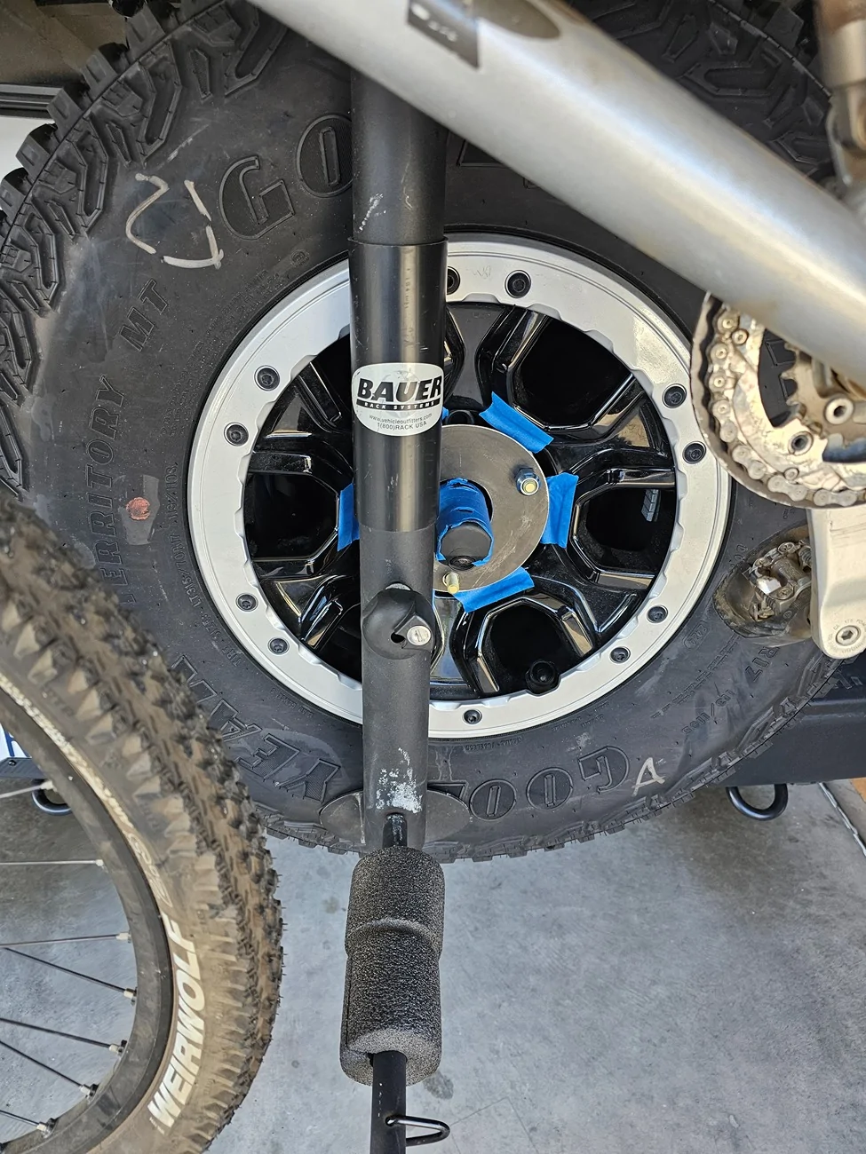

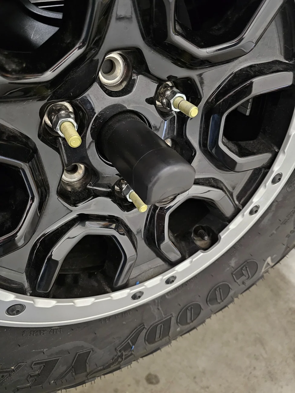

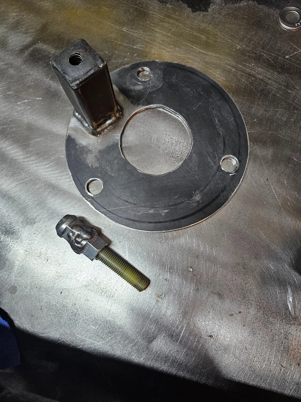

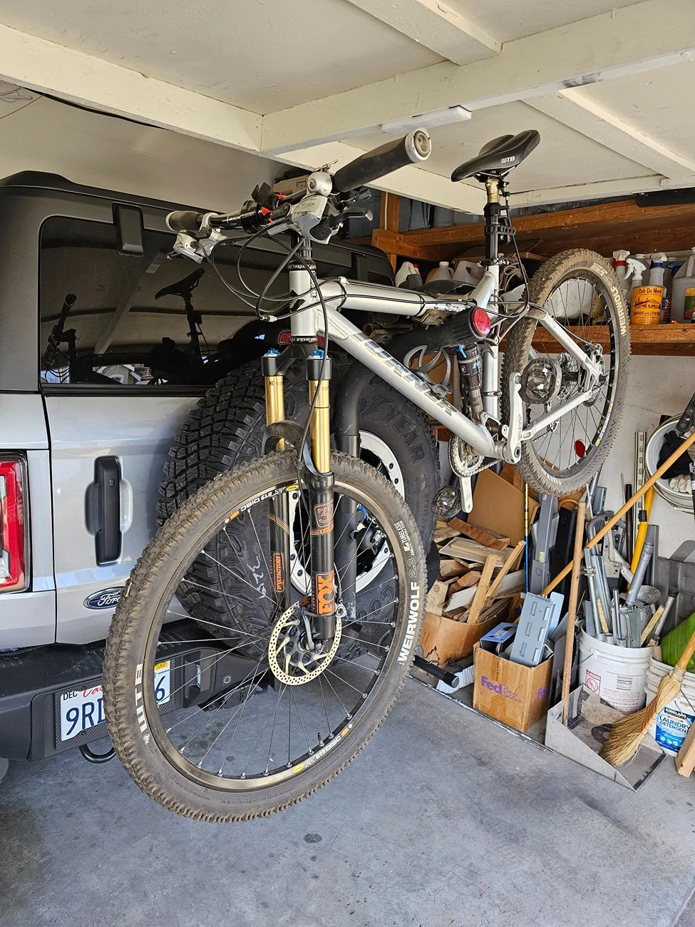

I have a bike mount that attaches to the spare tire, it worked well on my Isuzu rodeo 4x4. It came with a extra mounting hardware that allows for different wheel lug patterns, unfortunately I couldn't use it because the bronco has a rear view camera. I paid $50 on craigslist for this and I didn't want to buy another bike mount, so I took out the plasma torch and welder went to work. I don't think Ii could carry an electric bike without a tailgate reinforcement.
Do you have a link to this or the mfg name?
