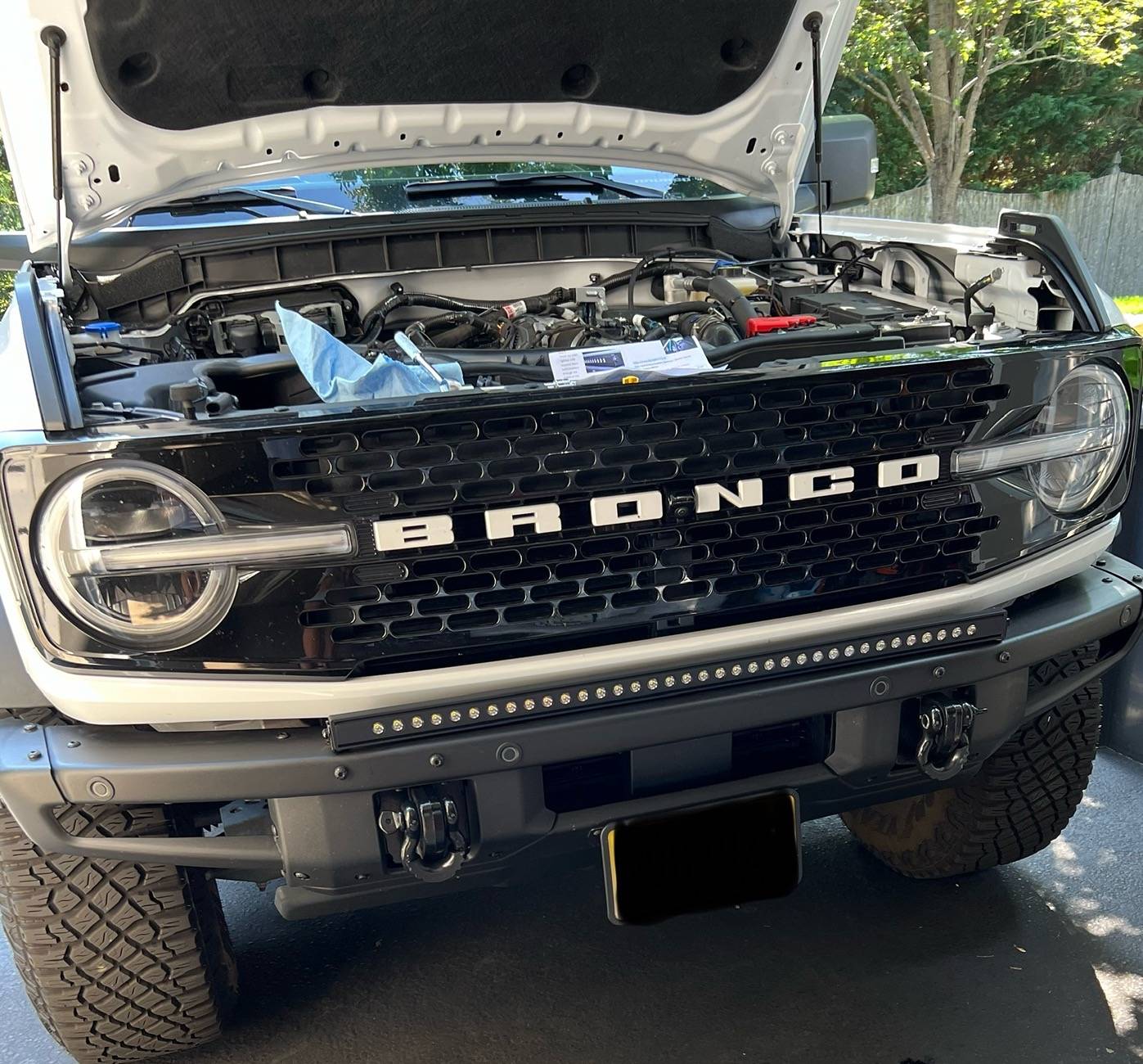

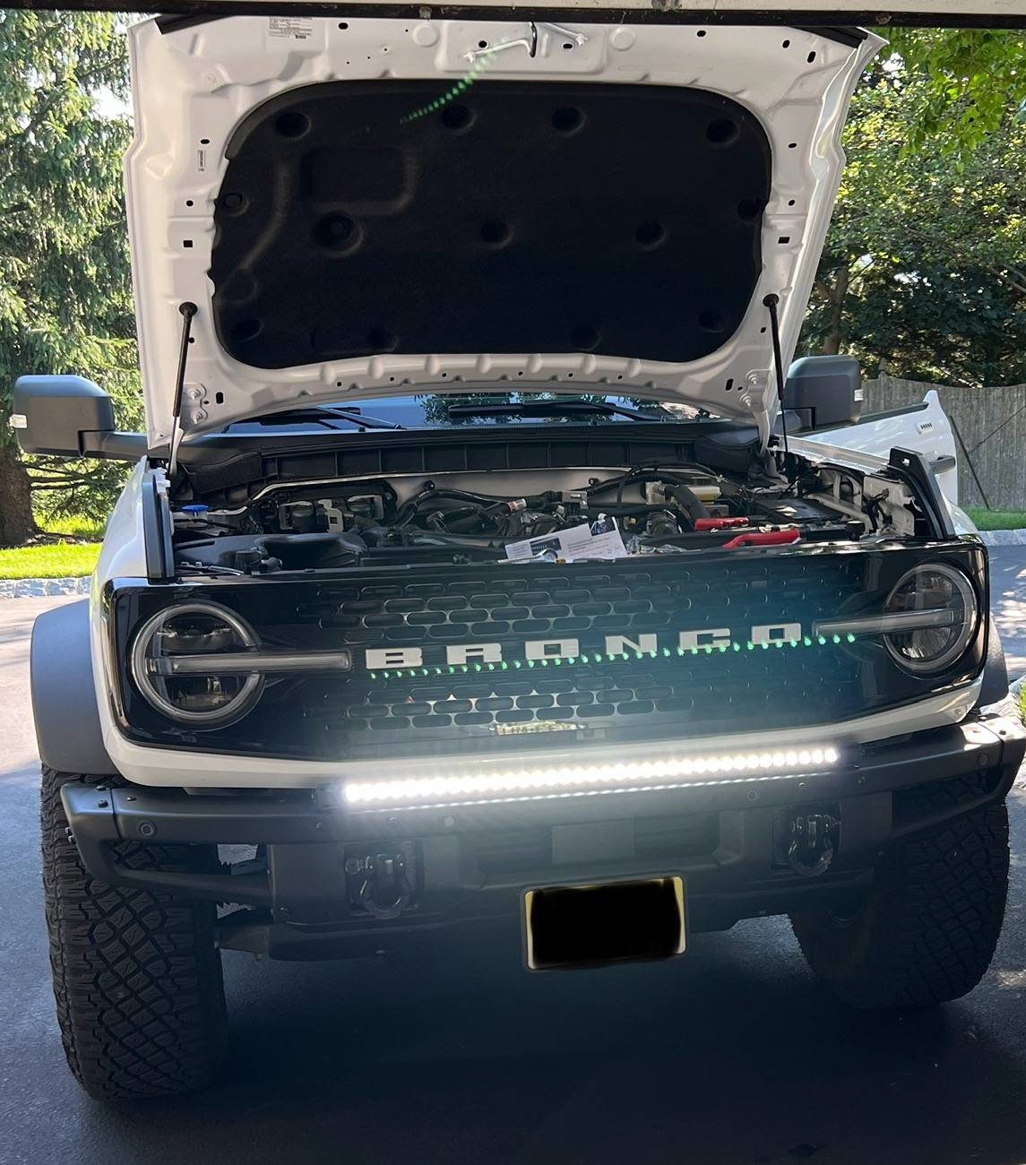

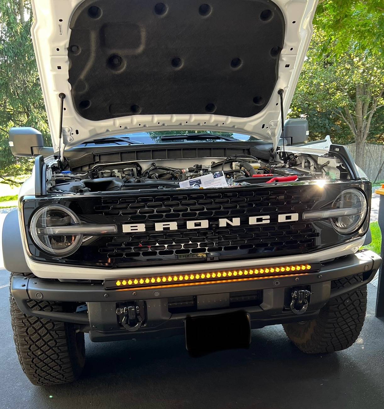

I bought the 40” early summer - amber driving light and super bright white light. Bolted to the bumper with no issues and very easy to wire to aux switches. Very pleased with purchase.
