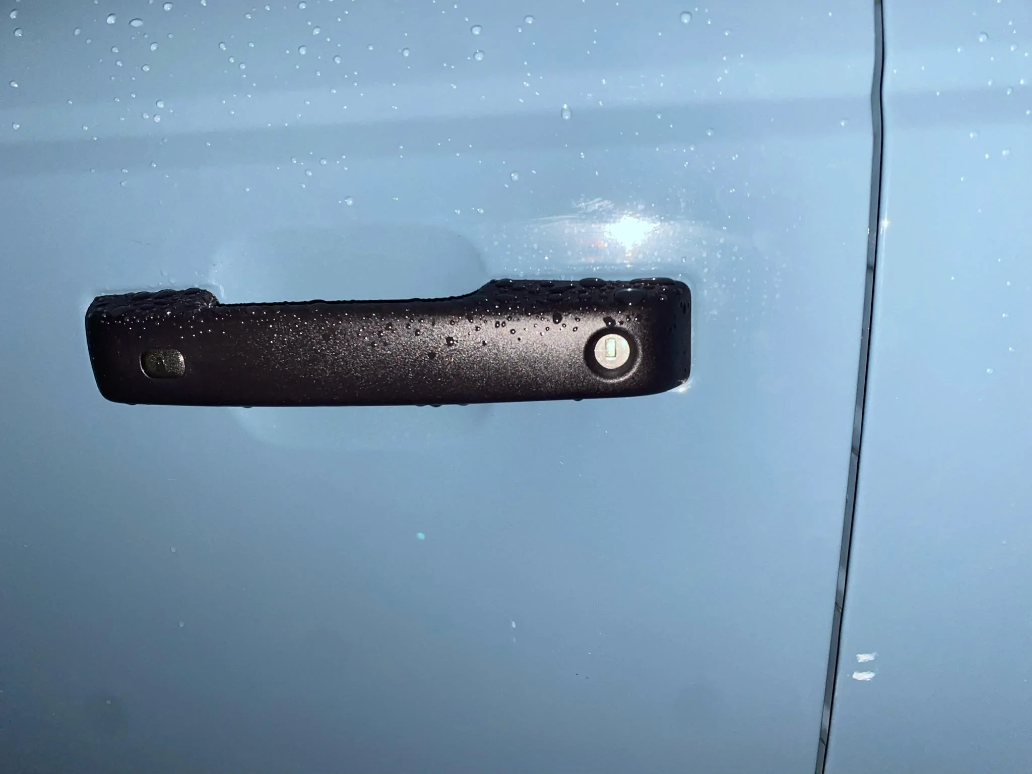

FYI, there are NO locks/key holes on the Bronco doors or tailgate (at least not mine since it's Lux/keyless entry). I think it's only for the center console and glove box.

All Ford products no matter the trim level have a keyhole in the drivers door…..why else would they give you a key hidden in the FOB? 🤷🏻‍♂️

I stand corrected. I had to go out and look cause I apparently never realized the driver door (ONLY) had a key hole! LOL
Which is also the case with my 2014 Escape as well my 2005 Mustang. Ford has been doing it this way for a long time.
