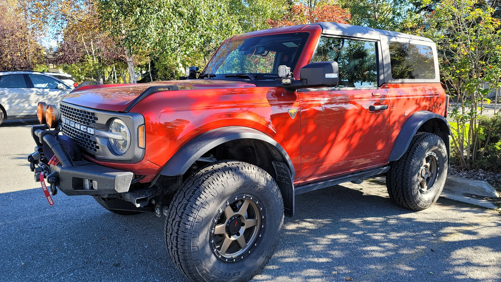

Since you're doing a winch, you'll probably want to install frame horn reinforcements. Several people on the forum have bent the frame horns while winching hard.
These are the ones I used. However, the are several companies that make them with varying designs.
https://lodoffroad.com/products/2021-bronco-lod-front-bumper-frame-tie-in-brackets/BFT2101
