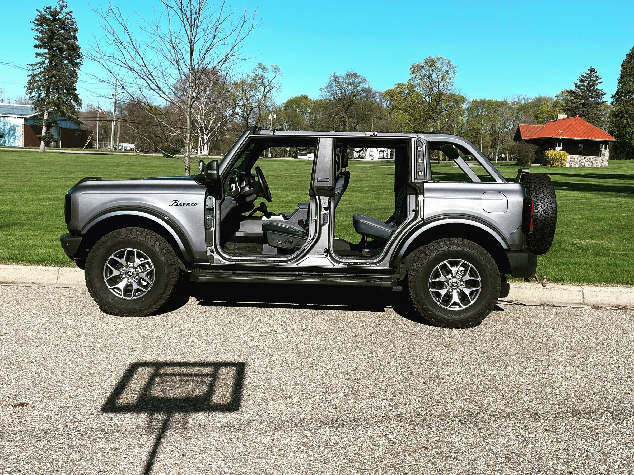

First time taking the OEM soft top off will be this week. Any tips anyone has to make sure I don't scratch the car or damage the soft top? How long does it usually take? How is it getting back on?
Weather is finally getting better in the mid-west. Up until now, been just dropping the top but never taking it completely off because weather hasn't cooperating. Looking to take the OEM top completely off this week and let the the Bronco shine in it's full glory!
